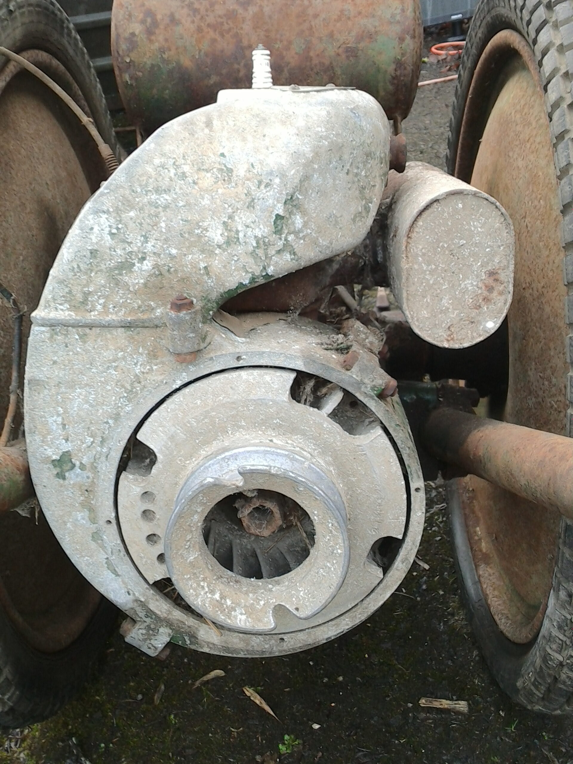

WD40 is not the best product for freeing rusted nuts and bolts, something like Plusgas is much better as it is a proper penetrating fluid.January 8, 2020 at 8:21 pm #33033andyfrost
ParticipantWelcome , if it’s an 11C it will have a cast alloy cowling , pressed steel then it’s a 25C.

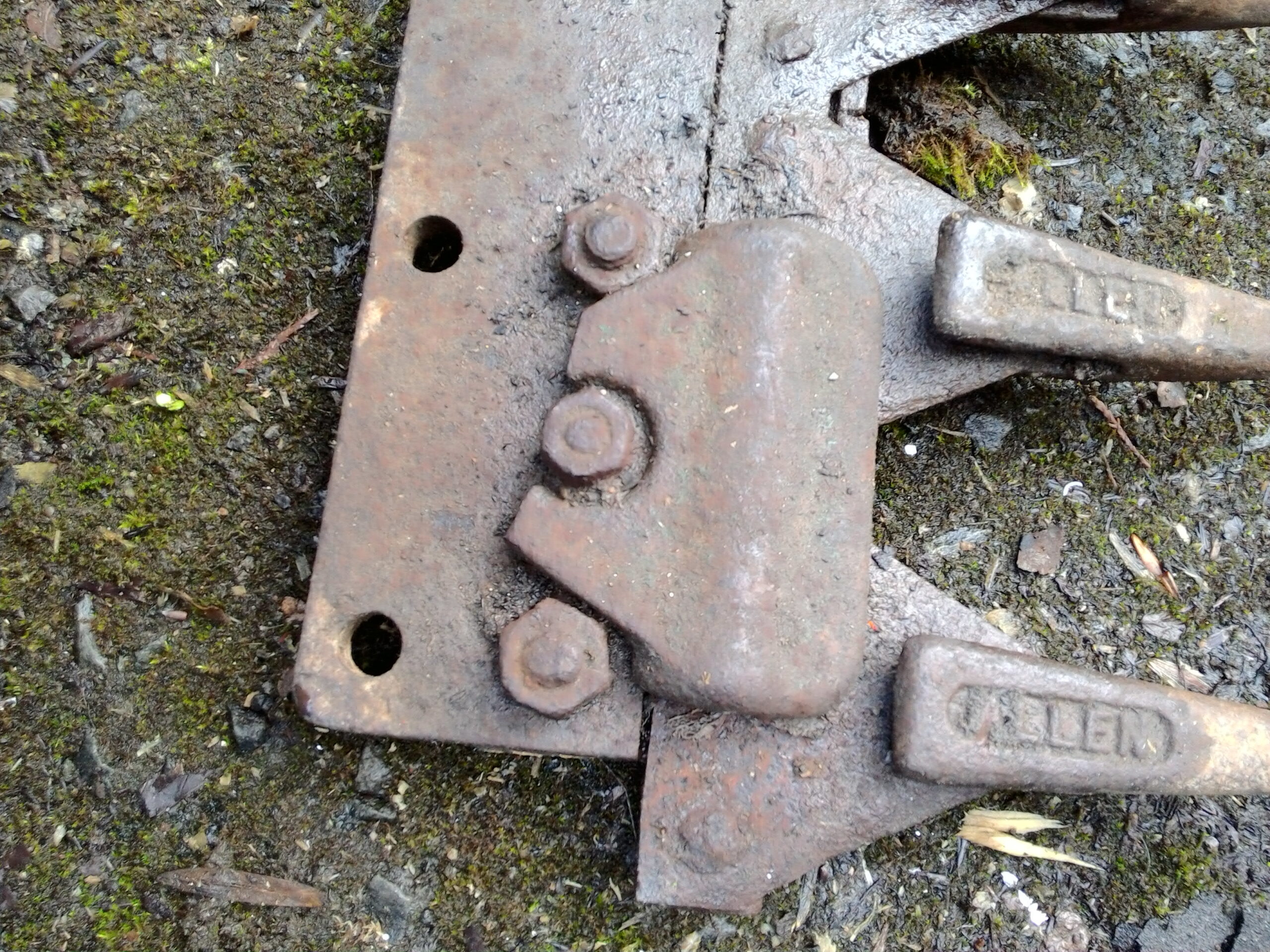

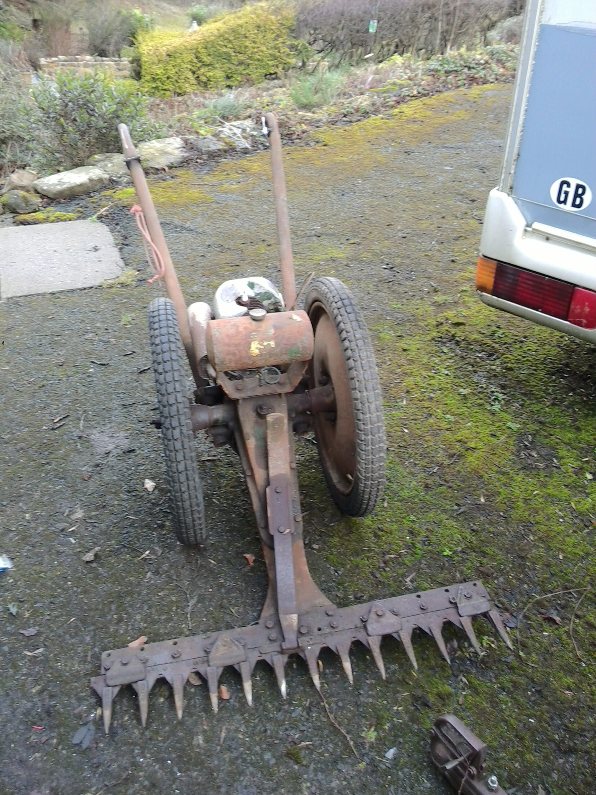

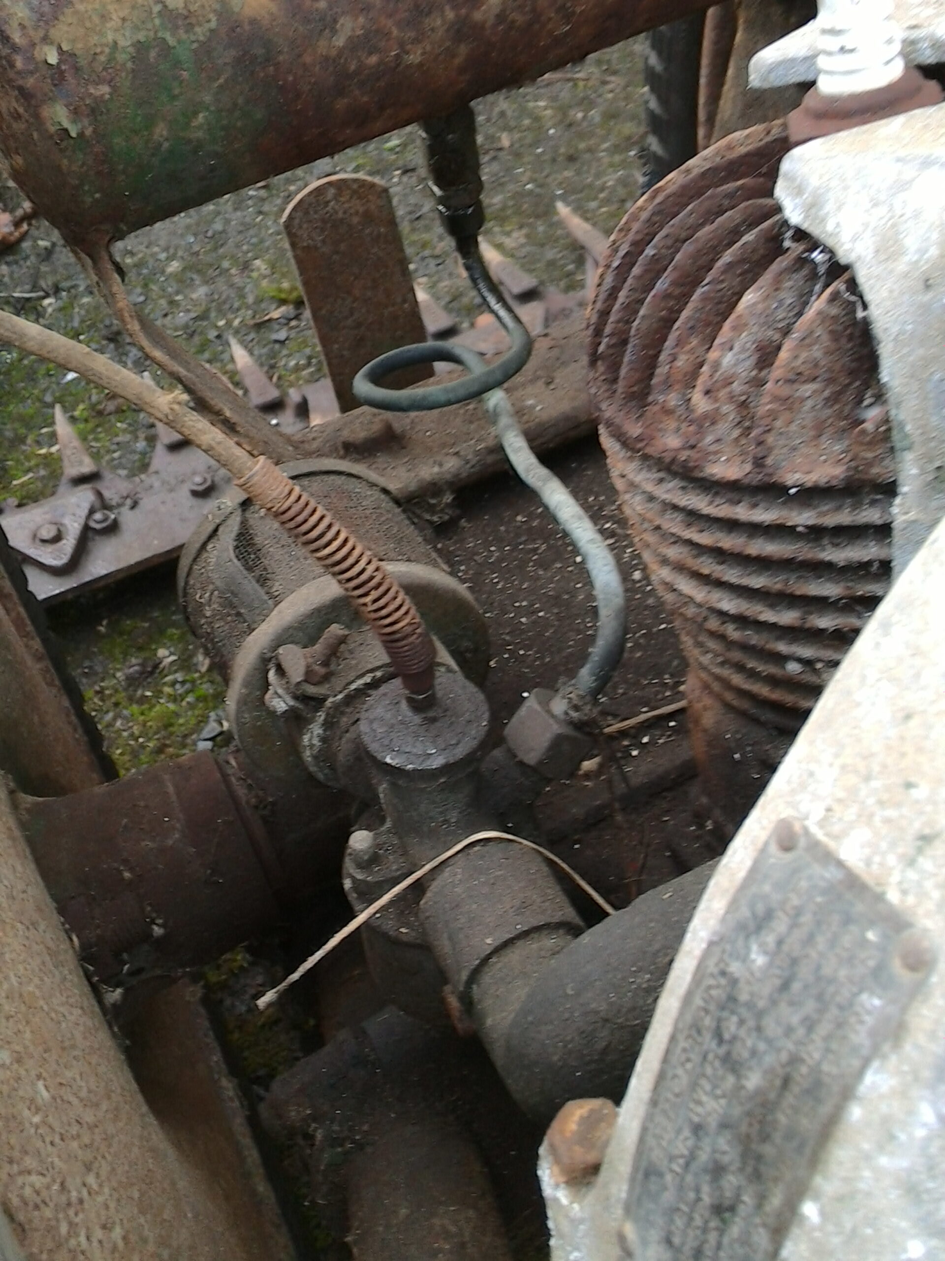

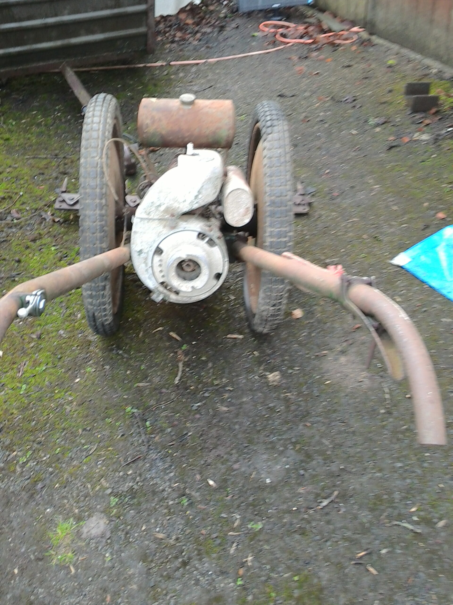

vhgmcbuddyMemberThanks for your replies. Here are some pictures. The cowling is alloy so I guess that confirms it as an 11c Andy. It’s nice to think it’s an early model but all the info I’ve seen has been for later models with the 25c engine. If anyone has seen any info on the 11c I’d be glad to know of it for example to confirm the timing setting.
It seems to be reasonably complete appart from the cover plate for the flywheel, which I’ll have to look out for. One of the dogs which puts pressure on the blade is broken and I guess I’ll need another one if I’m to get the adjustment of the blade right.

January 9, 2020 at 3:02 pm #33047andyfrost
ParticipantDeffo an 11C, nice and original , still retains the proper carb and fuel pipe.
