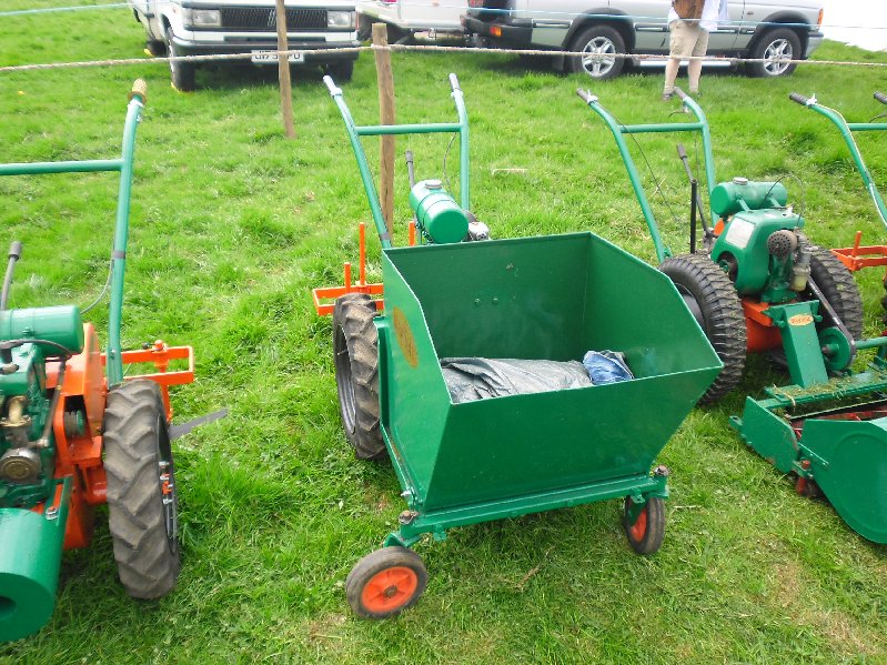

vhgmcbuddyMemberHi all, We have a steep drive at our house and most deliveries are at the bottom. The delivery lorries do not fancy trying out the drive most of the time, as the drive is quite bad, with some gravel and dirt. We get lots of rain which affects the drive too, making it very slippery underfoot. All our post, logs, coal etc is delivered to the bottom of the drive and I have to manually wheelbarrow it up. I also have bad knees.
I would like to buy something to help me carry stuff up our drive. It doesn’t need to carry/pull more than 50Kg and doesn’t need to go faster than walking pace. I have discounted a quad bike as too big. I am thinking about buying an electric winch, but that will be only a partial solution as the drive has a bend.

charlieKeymasterA number of two wheeled garden tractors had a front mounted barrow or load carrier attachment, a couple of photos are in the website gallery.
Mayfield
Merry Tiller
Other machines with similar attachments include Barford Atom and Monro Tiller.
Most of these machines are easy enough to find, the attachments are not so common though. It would not be too difficult to fabricate one.

stuartParticipantA Merry Tiller with a 5cwt truck would be ideal.The MT (with wheels fitted instead of the rotors) fits on a turntable and makes the truck very manouverable.Do a search on Google.I just sold mine a few months ago.

vhgmcbuddyMemberI have a Merry Tiller that needs a bit of work, so I will use that and attempt to fabricate something.
