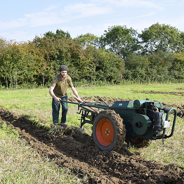

    It may well be worth having a look at the Trusty tractor page in the galleries on our website. This will give you an idea of what one looks like (should look like).
    The earliest version had no bumper, just a longer chassis plate, the next version had a bumper like the one in this photo, this was then replaced with this version
    Various engines were used, JAP, Douglas, Norton and others.

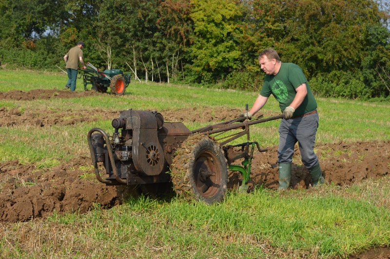

    Thank you. It looks, from the brief glance I had, like this machine this machine (Trusty tractor with JAP 6 engine and 3-speed transmission, BUT with all-metal wheels (what are these called?). The bumper is the same at any rate.

    Trustys had two different steel wheels available. The more common one is the standard divisible wheel which is offtern referred to as a straked wheel.the other is the spade lug wheel which has the larger pointed lugs.

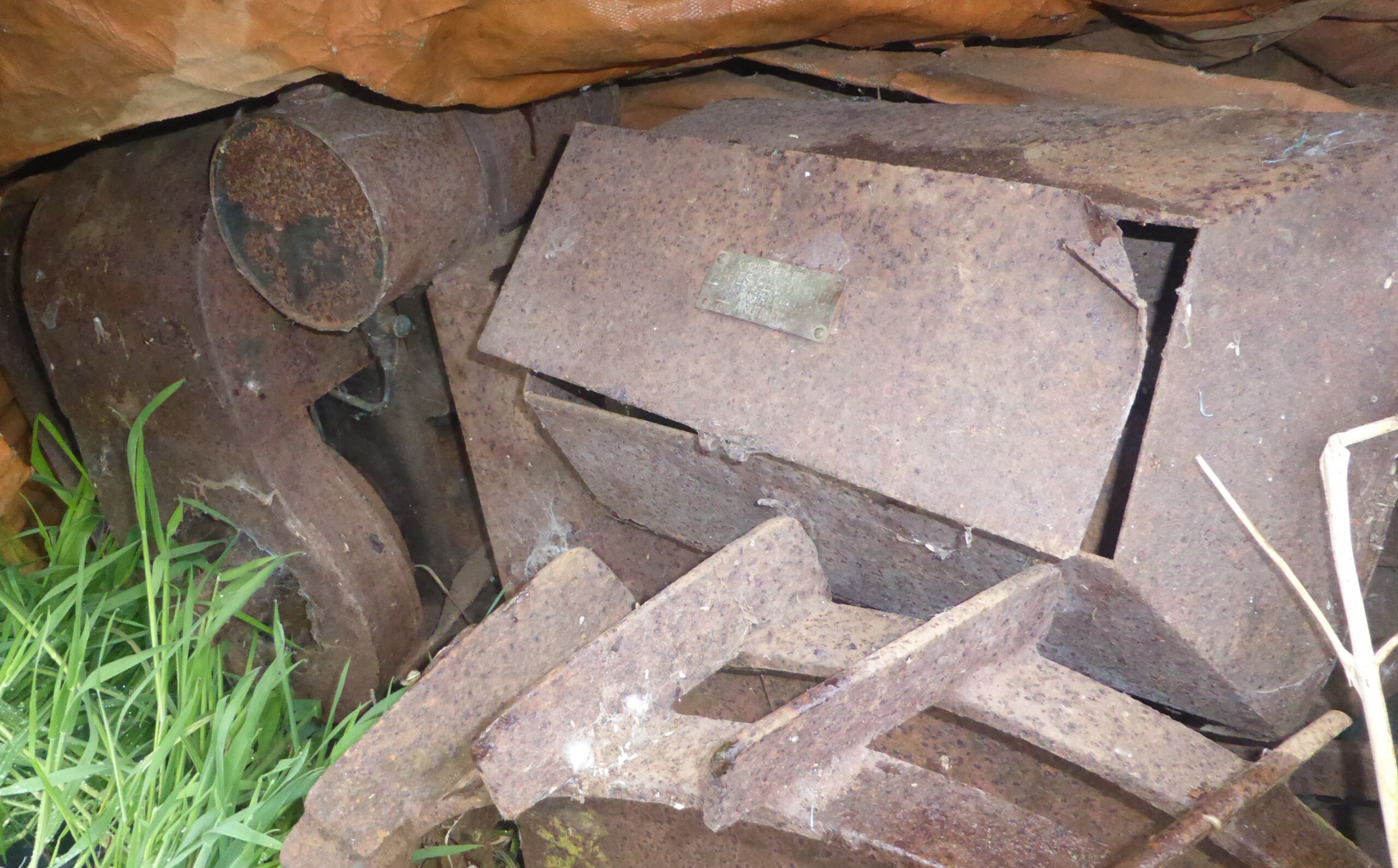

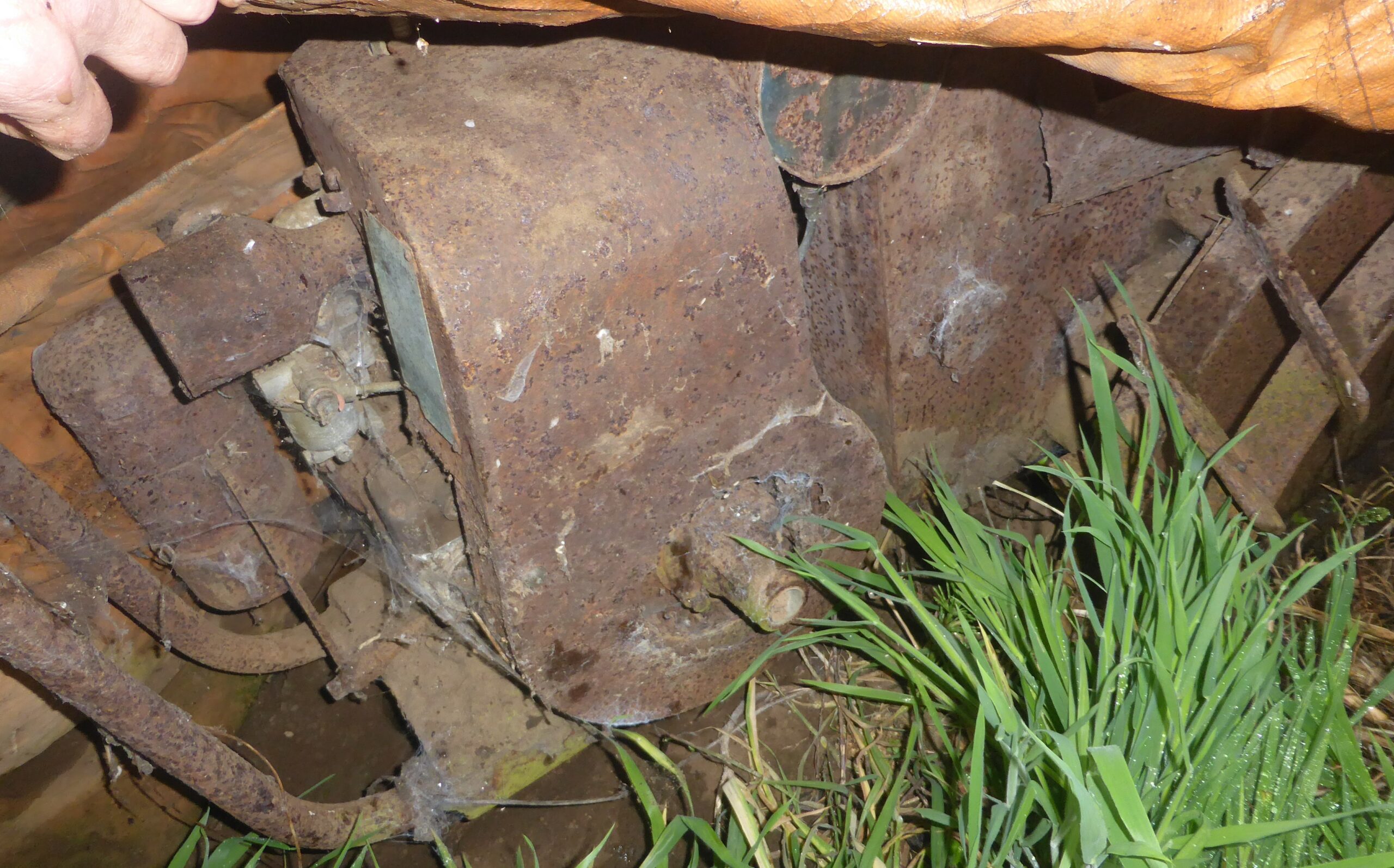

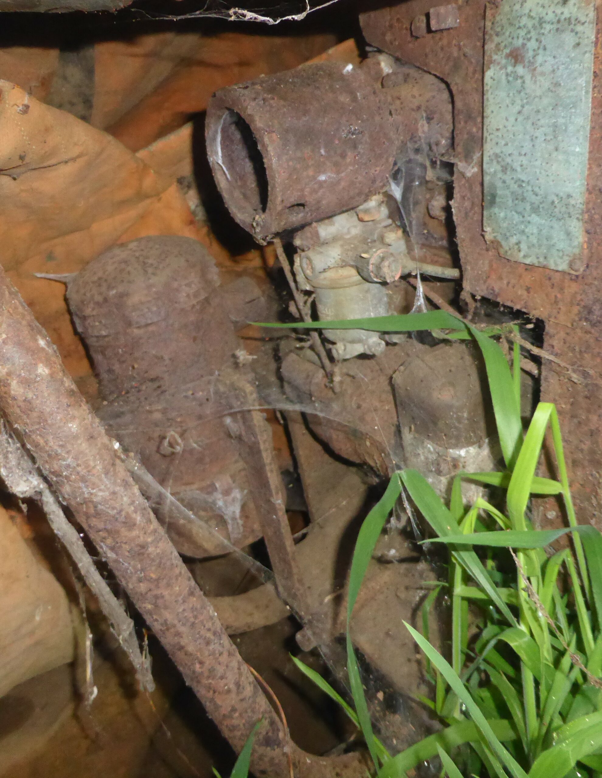

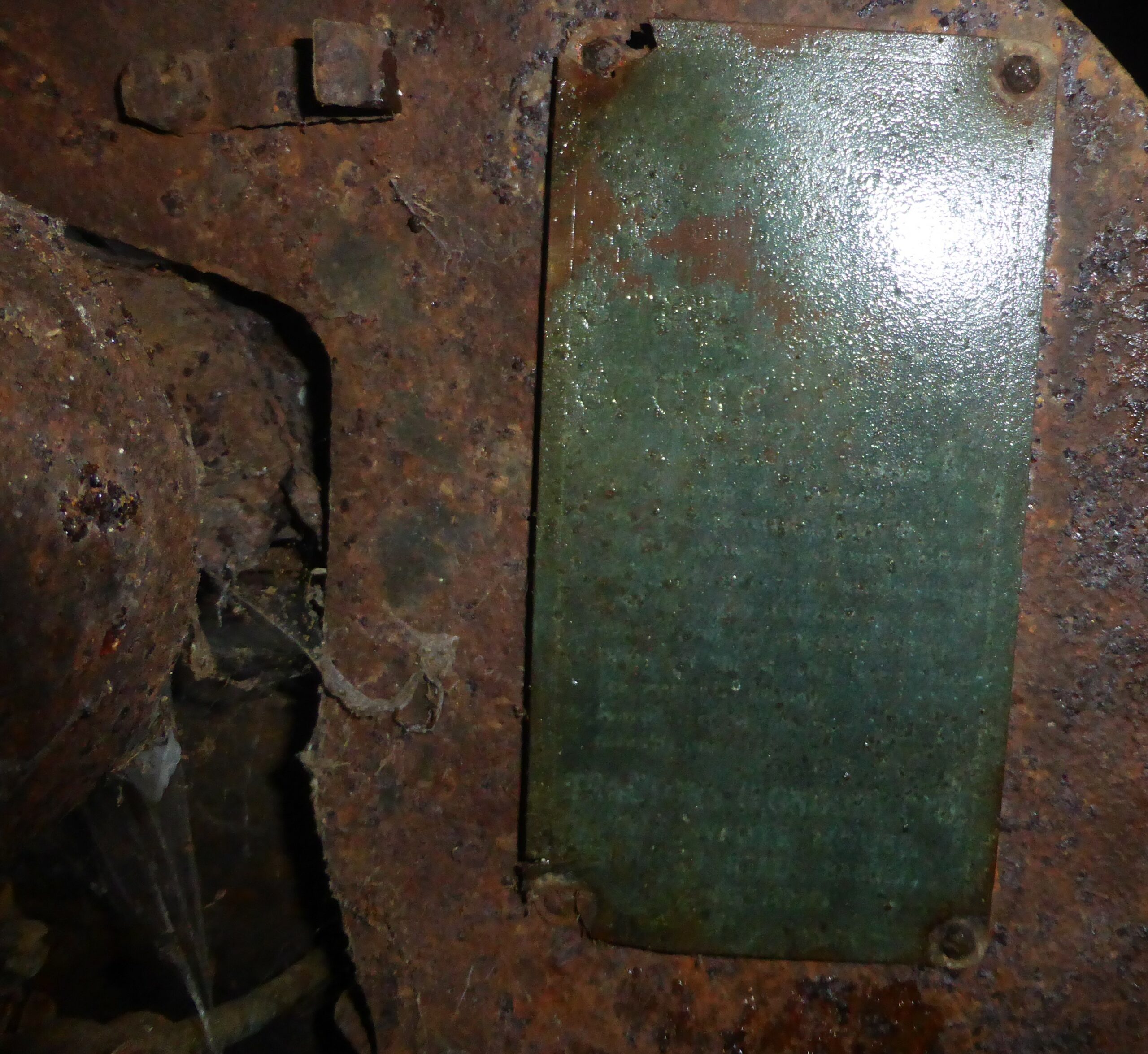

    I see. Thank you, this one seems to have standard strake wheels, although not splittable (maybe an old mod? Could be made splittable). Don’t know what the engine is, do the pics give a clue?
    Perhaps it’s compost, though.
    • This reply was modified 2 years, 5 months ago by rjy. Reason: Toomuchbiglypictures
    #42302
    Looks like a standard single speed (with no reverse) fitted with a JAP 5 engine; probably dates from around 1946-49 looking at one or two other features but without the tractor serial number it’s difficult to pin down.
    The serial number can be found on the rear of the transmission case where the handlebars are bolted to the machine.
    It would be a good machine to learn on as it’s the simplest and most common Trusty sold with a very common engine that you can still get parts for. Trusty parts are generally not available but you can always buy a donor machine quite cheaply with the parts on that you want.
