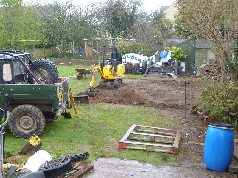

    After several years of having no room to work in my garage due to my eldest sons various and ongoing Land Rover projects I decided it was time he had his own workshop. This should hopefully let me regain use of the garage!
    A trawl of the internet brought up details of what can be built as an outbuilding without needing planning permission or building regulations approval. Luckily I have room to make the most of these rules and a 6.5m x 4.5m floor area was decided on.
    After marking out the site it was time to get a mini digger in.

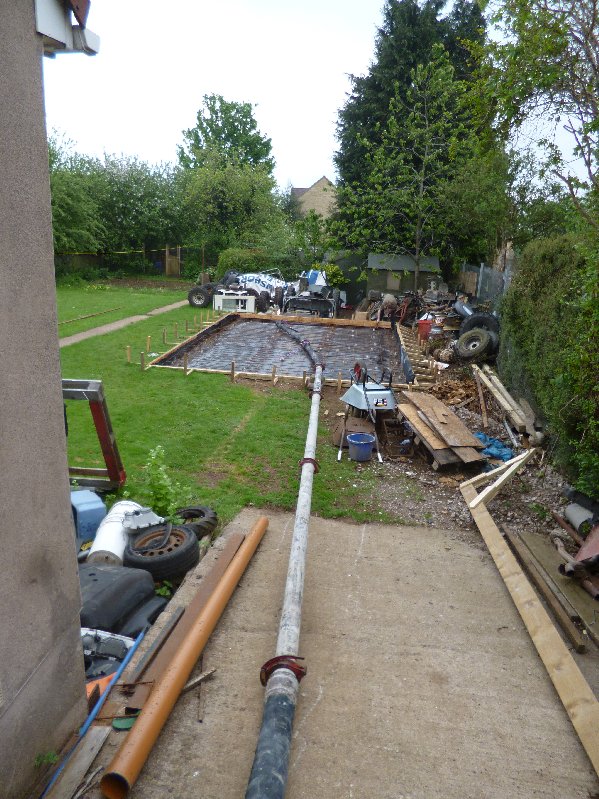

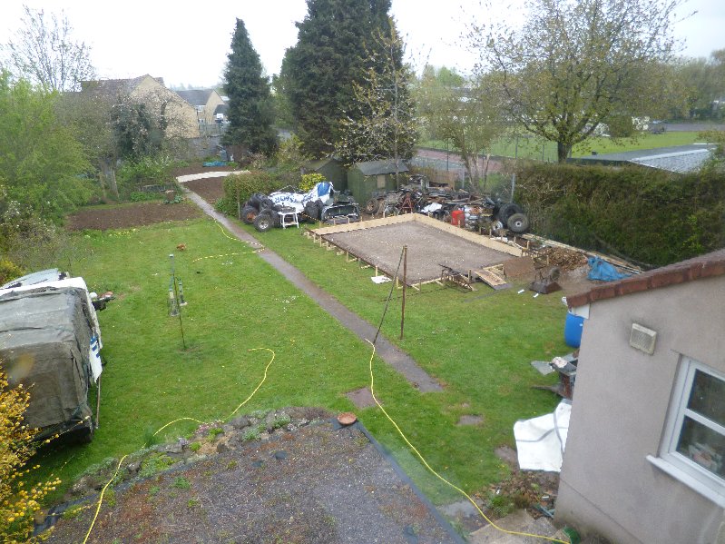

    Next was shuttering and reinforcing.

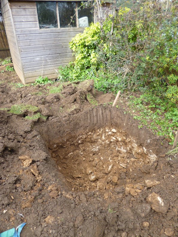

    Whilst we had the mini digger on site it was used to dig a hole for the soakaway, you will see how much stone there is our ground once you get down 12″.
    #21259

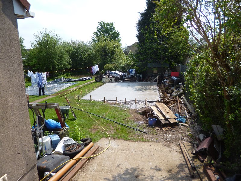

    Time for the concrete, but how to get approx 8 cubic metres of concrete from front of house to back garden without making dozens of trips with a wheelbarrow and before concrete sets? Luckily a local company will supply a small concrete pump, so that is how we did it. All concrete poured in no time at all, well worth the expense.

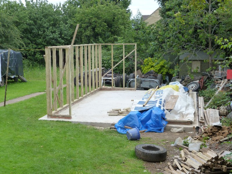

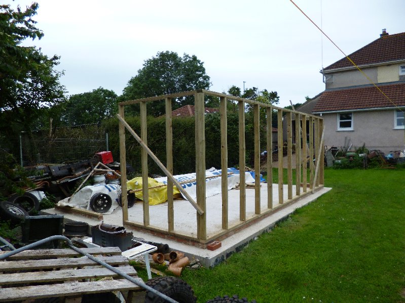

    To help protect the timber frame from damp I laid one course of bricks. Work is progressing, rain permitting and we now have framework for one side up.

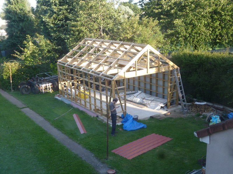

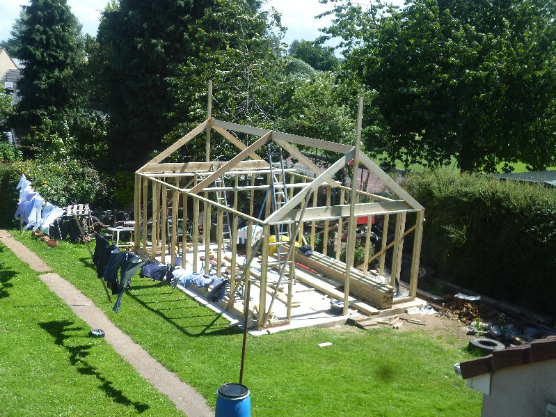

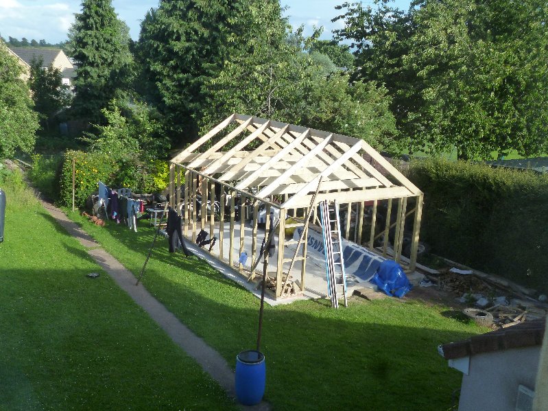

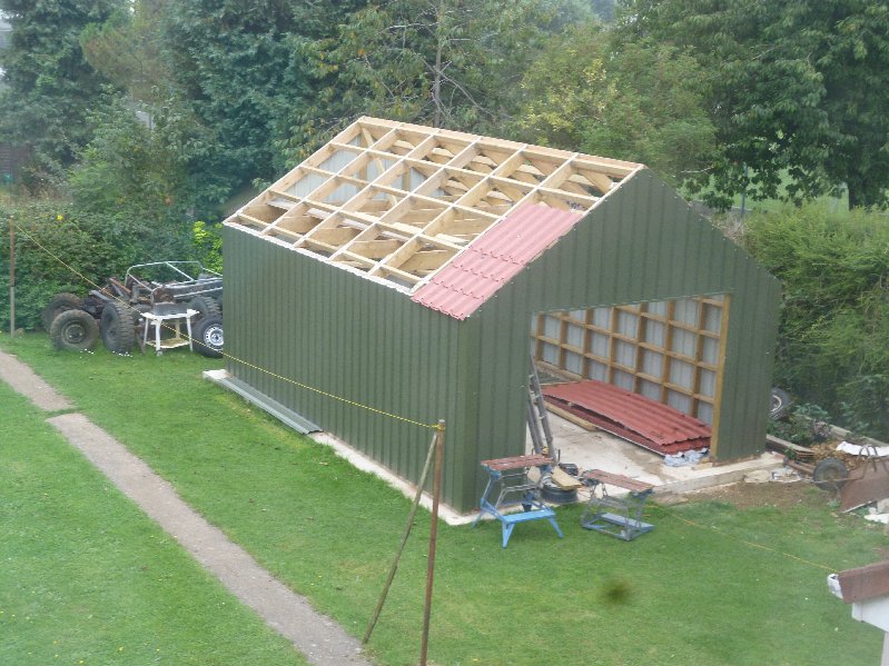

    At last the rain has stopped and the sun is out, made good progress today and got the main roof timbers on.

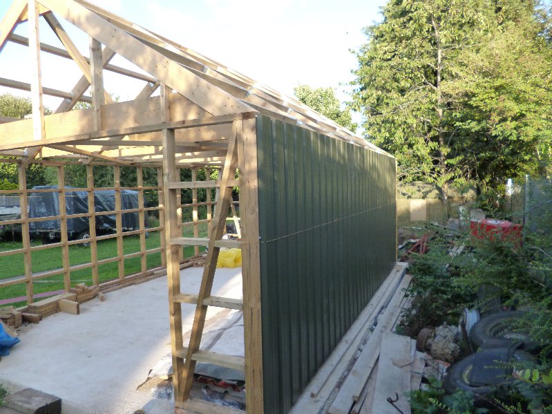

    #21463

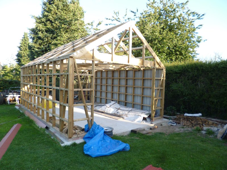

    Slow progress with framework, all braced now with various diagonals. Cladding for roof and walls ordered. Next major expense will be timber for doors.
    #22133

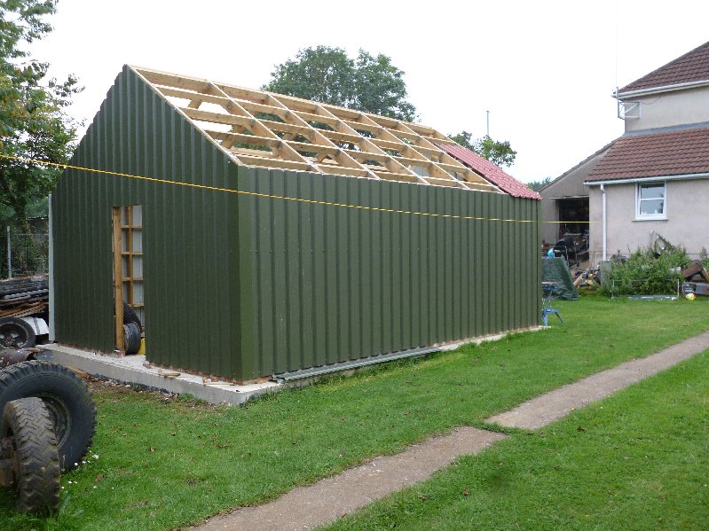

    With the fine weather work has continued, frame is complete and cladding is going on.

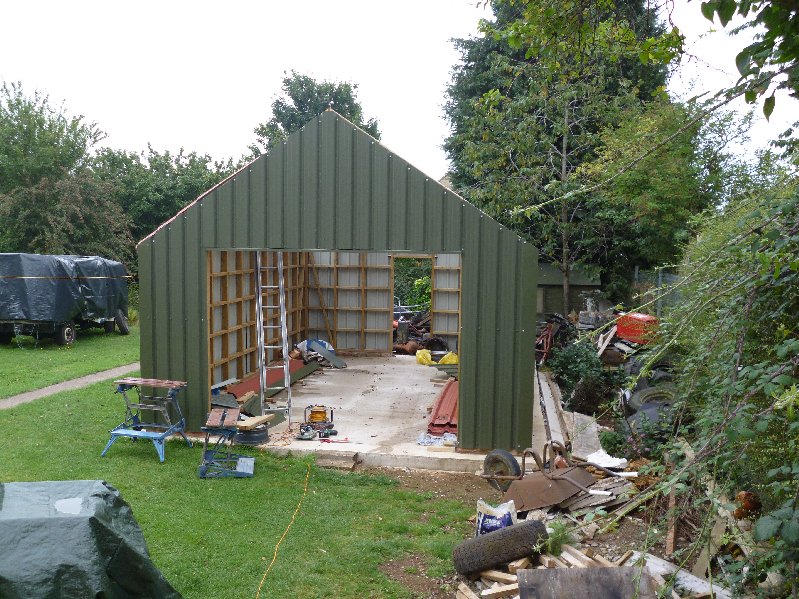

    #22137

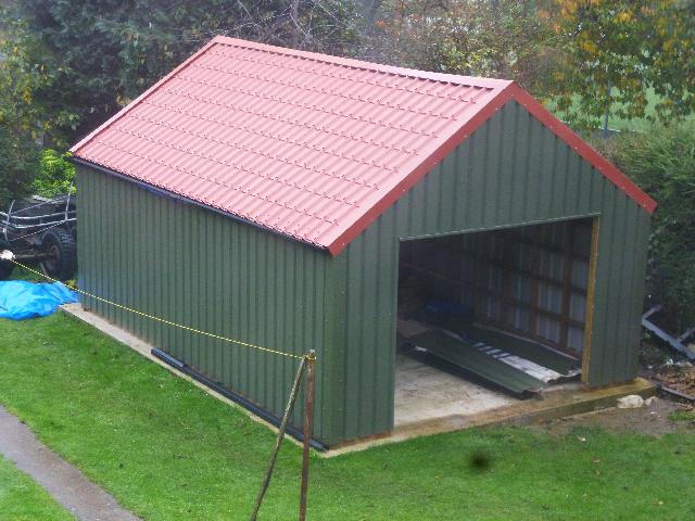

    Wall cladding complete, roof will be a two man job as panels slide off if not held in place. Still have doors to make, guttering to fix etc. The roof panel in photo is a spare part panel I am using as a practice piece to test fit.

    Next major job is getting roof on, this will be a two man job, so will have to wait till the weekend or next week.
    #22810
    Roof is on and guttering fitted. Just doors and electrics to do.
