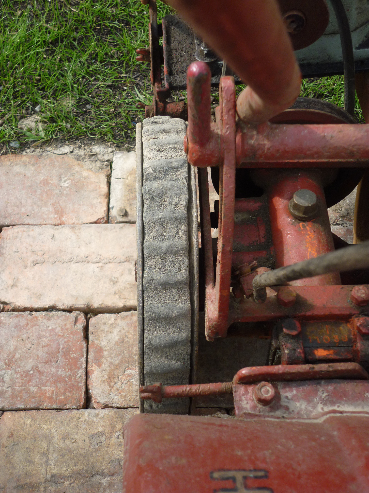

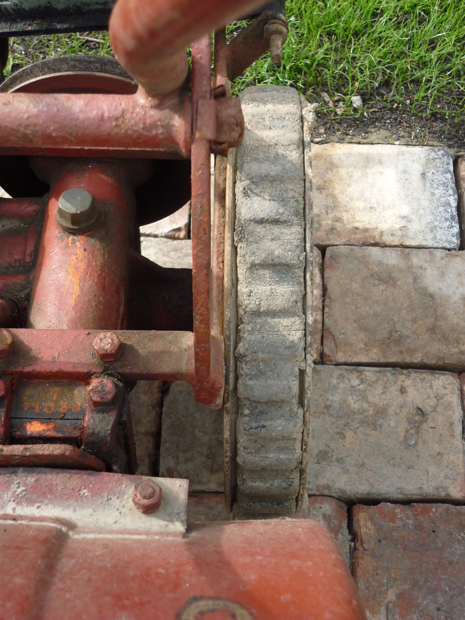

    It seems that one of my pictures to my earlier post did not upload and that is of the right wheel, this shows how close it is to the chassis compared to the left side (I just hope it hasn’t sized) and as I am looking at the different aspects of the machine, I am not going to take it apart until I find the obvious parts that I need, for example #14262 spacer – base plate Pivot (used from serial No.2231001). I am not sure if the Bullfinch would have such a spacer since I am reading from the 200 parts diagram but on my machine there is so much play it would possibly need one?

    your bullfinches wheel does look a little too close on one side. Spare gearboxes do turn up from time to time on ebay etc, as do the little jap 2A’s, it will just be a case of being paitent for them to show up, recently I just obtained a particular gearbox that ive been searching for nearly 8 years for, but as you machine is fairly common hopefully it wont take anywhere near as long.
