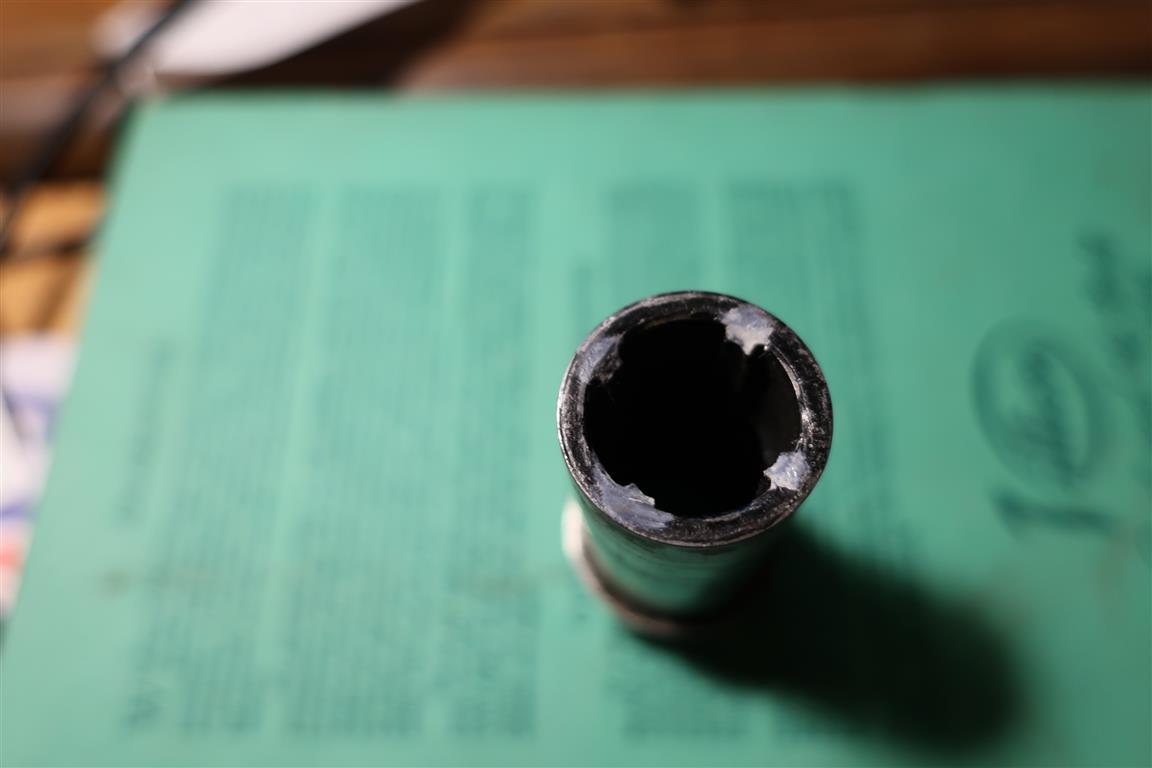

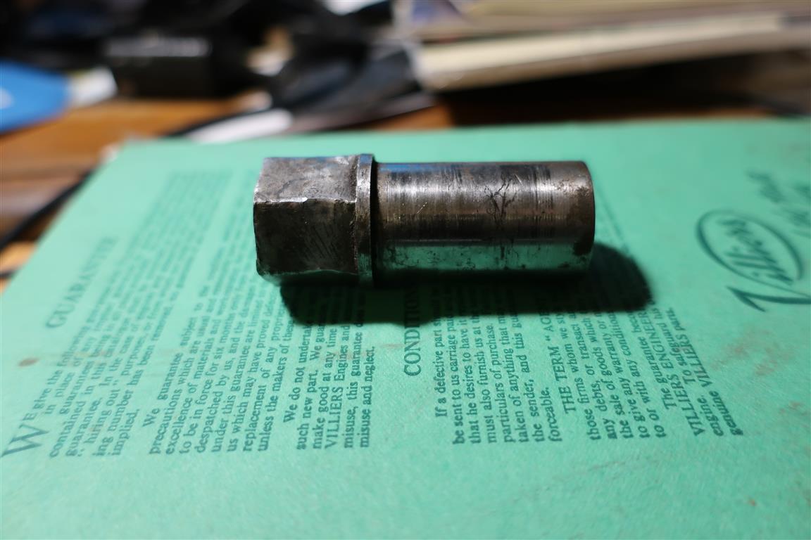

wristpinParticipantFairly certain that pulling the sleeve and sprocket off is the way to go. Atco used a similar system on cutting cylinder drives right through to “modern” Atco 24s. Unless one knows, that hex sleeve just invites the application of the biggest ring spanner in in the box and I’ve seen them actually twisted. I’ve got a few damaged ones that I use for driving cylinders on the grinder.

hortimanParticipantThank you Angus saving the day ( and the sleeve) 5 minutes and a pair of tyre levers and the job was done. Thinking ahead, does anyone know which green would have been used in the 50s ? is it mid Brunswick or a special Atco mix ?
