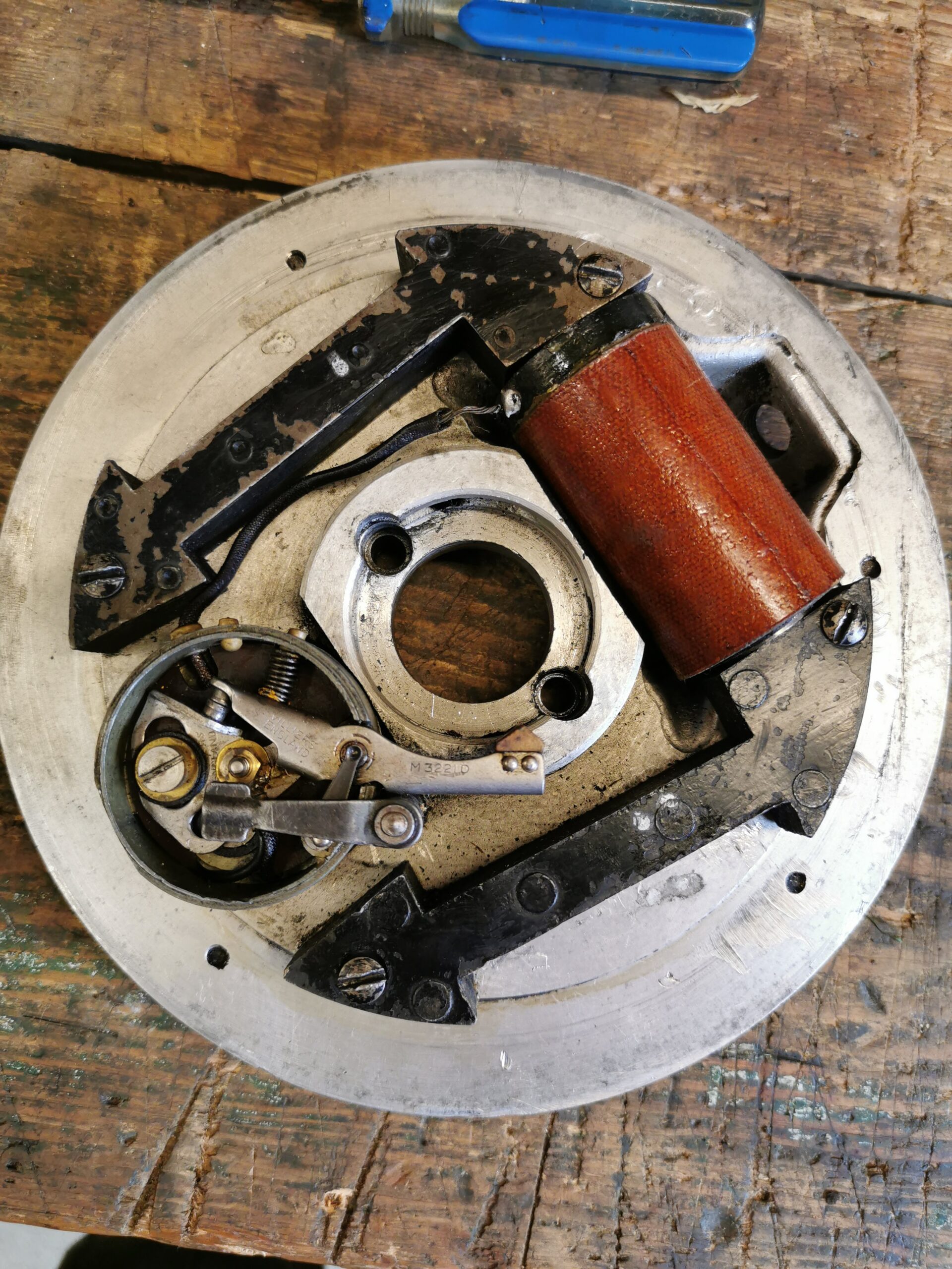

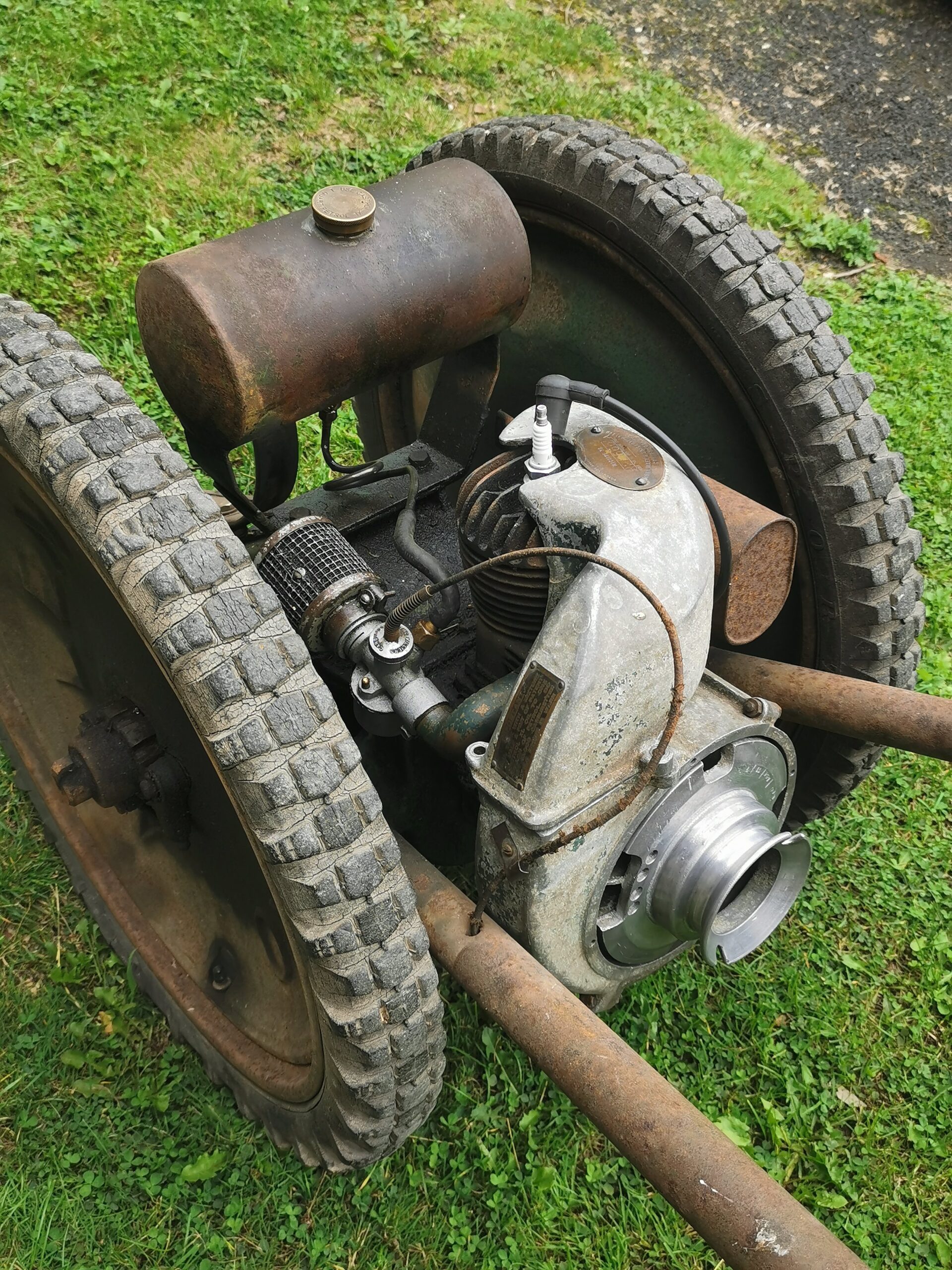

jake-yoParticipantIt is also impossible to set the point on this engine with the flywheel in place as it is solid and the cam follower for the points is on the inside of the flywheel…

The fan on the flywheel “should” be a seperate part , and once removed you can adjust points with flywheel in place.
Some close-up pictures of your flywheel would help.Andy.
August 26, 2021 at 7:00 pm #37758
trusty220KeymasterI’m with Andy- can you show us a photo of the flywheel? Normally, if the flywheel is brass you can access the points through the holes between the spokes. Obviously you have to remove the brass cover first but it should be possible to rotate the flywheel on the crankshaft to set the points to the correct gap.
With the piston at the right distance before TDC you should then be able to turn the flywheel in the running direction and then stop when the points are just opening- this is the point at which the spark is generated. Lock everything up without allowing it to turn and it should work; take no notice of the timing marks as they are often in the wrong place.
I hope that helps, but please show us a picture of the flywheel if you are still in difficulties.
