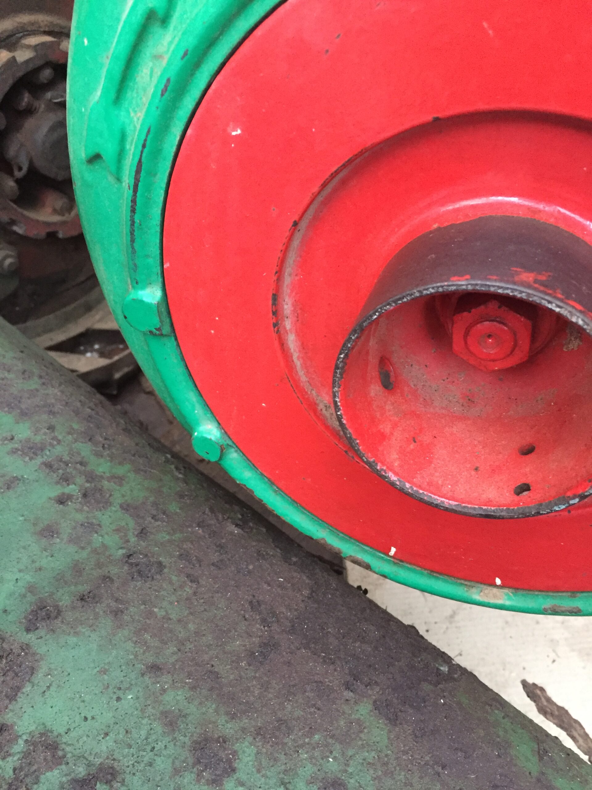

roatavatorParticipantIain, reading back over the posts, your “bang, bang,” might imply timing. Did you really mean you’d set it to spark at TDC? If so you need to set it to BTDC. Don’t know the exact setting for your application but I’ve attached a front photo of a SIMAR. The two round marks on the flywheel case are about the right distance apart.
Other than that I might suspect the impulse mechanism not working properly, as you are certainly getting a spark at low revs.
