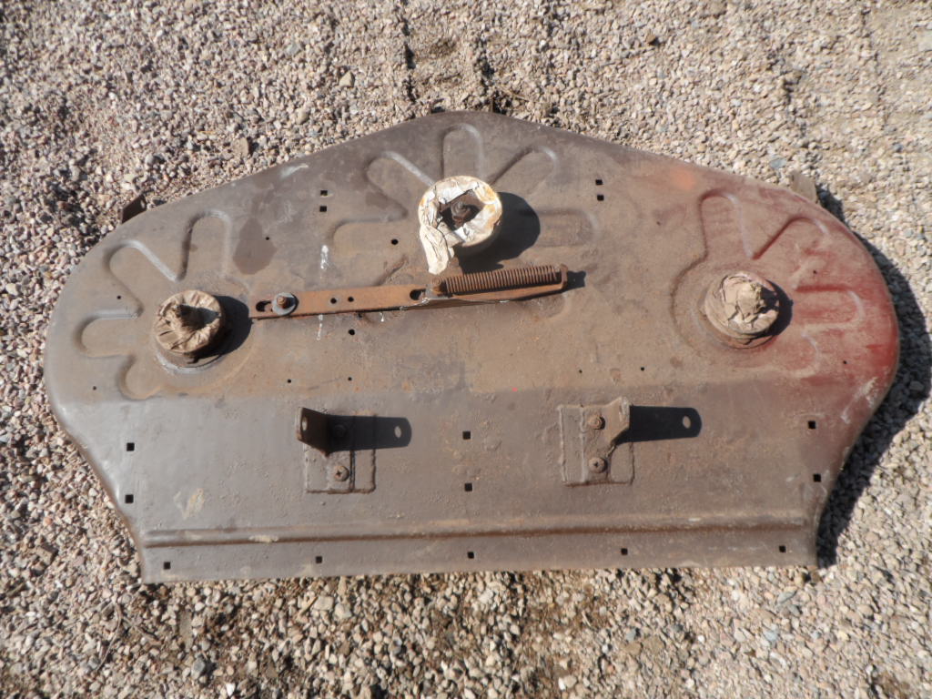

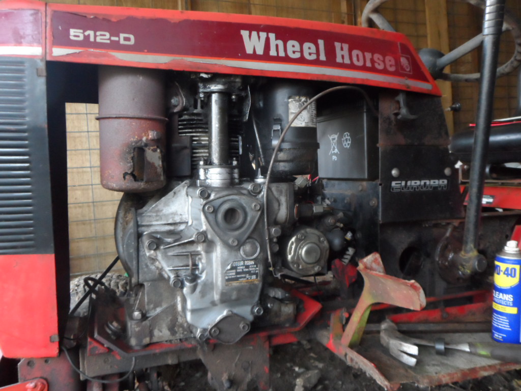

vhgmcbuddyMemberPhoto 1 you can see this part seized on the shaft. These parts have probably been together for 35 years. So would be a shame separate them now or that’s my excuse. Photo 2 is my work horse. Robin diesel 12 hp, are their many 512 D in the USA Glenn. I do watch the W H junkies on face book but don’t seem them.

vhgmcbuddyMemberOwen, The 512 D is very very rare in the states. The 512 D DY41D Robin diesel was sold in Europe not the USA. There are guys that are big WH fans that have never seen one. The mythical 512-D is ever so desired in America. Of all the Wheel Horse tractors, the 512-D is the one I want. Nice tractor Owen. Glenn
