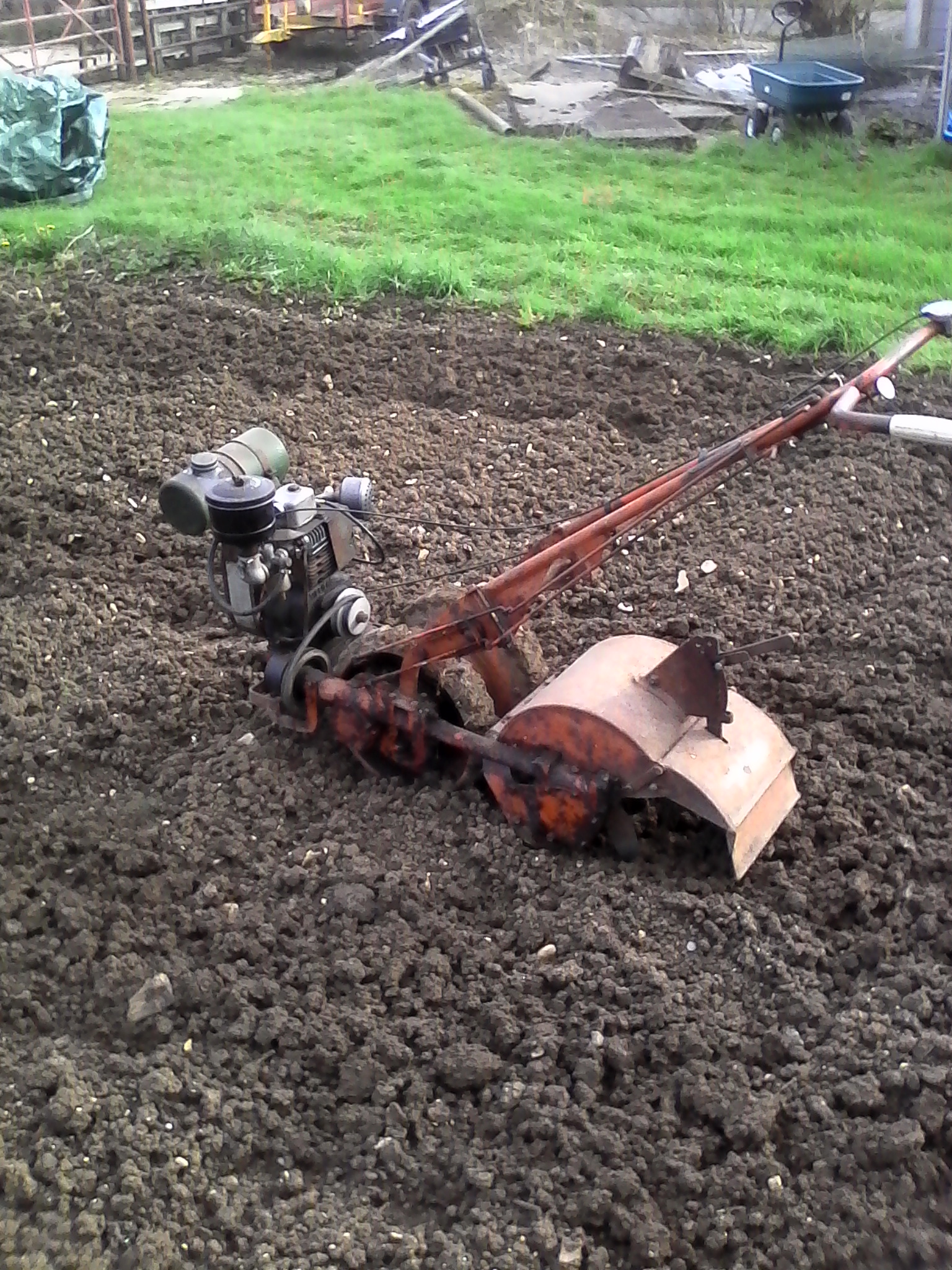

joegrgrahamParticipantUPDATE
The Bantam is alive!!!!
I reset the timing for the umpteenth time, new plug and away she went!.
So, many thanks to everyone who took the time to contrubute to this thread, I think a little bit of everyones advice went into this one.
She is running in the picture, the ground has already been Merry Tilled, and is currently wetter than an otters pocket, so not really a fair test.
Thanks again,
