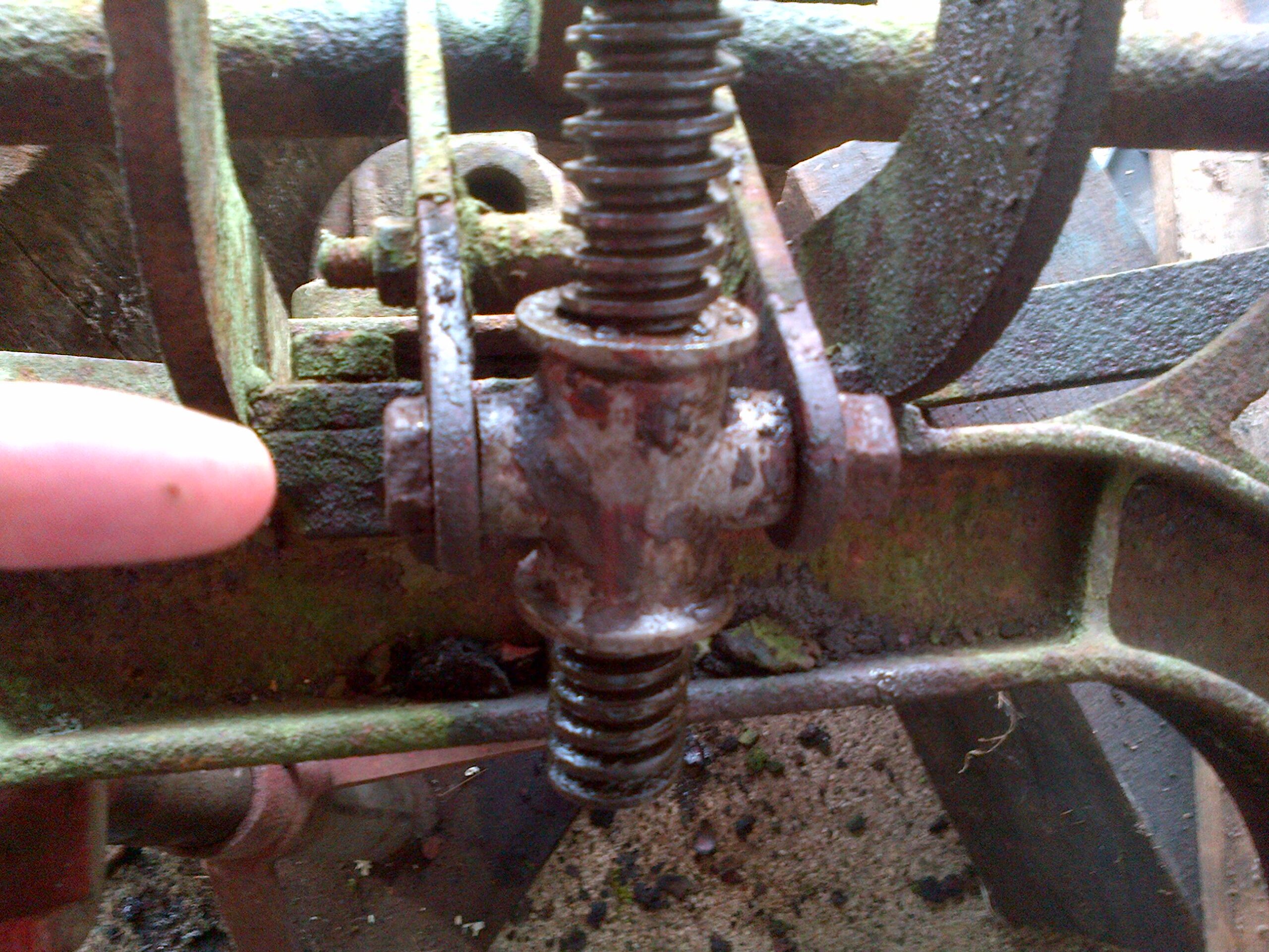

As some of you may know, I’m slowly resurrecting a large pile of Ferrous Oxide that once upon a time were a selection of Trusty attachments (plough, self-lift cultivator spud lifter etc).
Does anyone know of a source for the bolts with the large shoulder that hold the adjusting screws in place? As I break one, I’m taking one from an item further down the list and so slowly painting myself into a corner!Joe.

charlieKeymasterJoe, a photo would help for us non Trusty members.

joegrgrahamParticipantJuly 19, 2014 at 3:55 pm #9365
charlieKeymasterPhoto is a bit blurred but I am guessing it is a square headed coach bolt, ie it has a smaller square below the head to stop it turning when fitted in a square hole or in a slot and has a whitworth thread. Looking around this link might be useful https://www.myersblacksmiths.co.uk/#/rivets-bolts/4565523902
July 19, 2014 at 5:57 pm #9367
joegrgrahamParticipantJuly 19, 2014 at 6:01 pm #9369
trusty-madParticipanti could be wrong but i don’t think you can buy them. they have a round section just below the head not a square.
July 19, 2014 at 6:29 pm #9370
terranoParticipantI’ve used a threaded stud cut to length and a collar turned to inside, outside dia. as the stud nips the collar when tightened but allows it to turn.
July 20, 2014 at 7:39 am #9379
charlieKeymasterI see now, it is a shouldered bolt, no idea if you can buy them off the shelf, probably cost a fair bit to get some made. Using a collar on a standard bolt sounds like the best option.

daveParticipantHi all, If the bolts are threaded into aluminium the thread form should
be whitworth form.July 21, 2014 at 7:46 pm #9411
trusty220KeymasterI have had to make my own in the past. They are Whitworth thread and you can turn a collar to fit over the thread which does the same job as the shoulder. The hexagon head is a problem because it is far bigger than the normal hex for that thread size- I have sawn the hex off a new Whitworth bolt and drilled it out and tapped it to accept the thread. A lot of work, but you simply can’t get these bolts anywhere.
