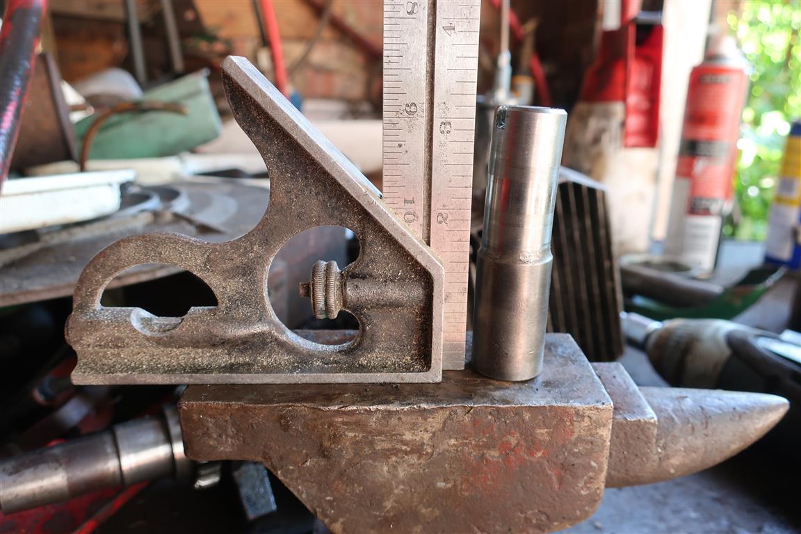

wristpinParticipantThe F15 having been stripped of anything that may be of use it was now the turn of several part stripped JLO L97s and and an electronic ignition RM100 with a rather bent crank. Fortunately JLO used an easily dismantled three piece crank and the lower section was common to a lot of their smaller rotary mower engines, so after a bit of cannibalisation we have a potentially usable short + engine – just need a carb!
The offending lower crank section.June 26, 2020 at 8:57 am #34872andyfrost
