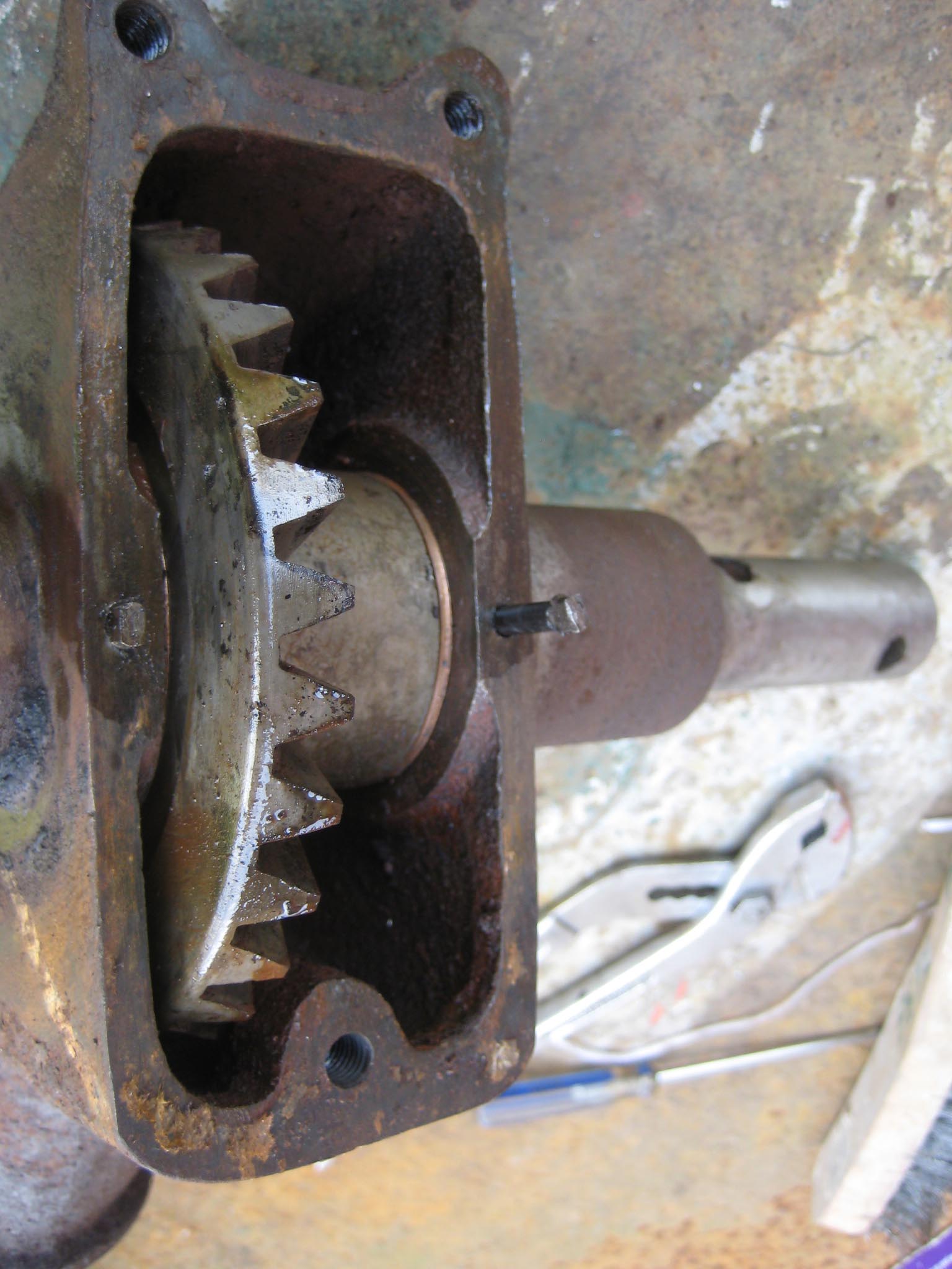

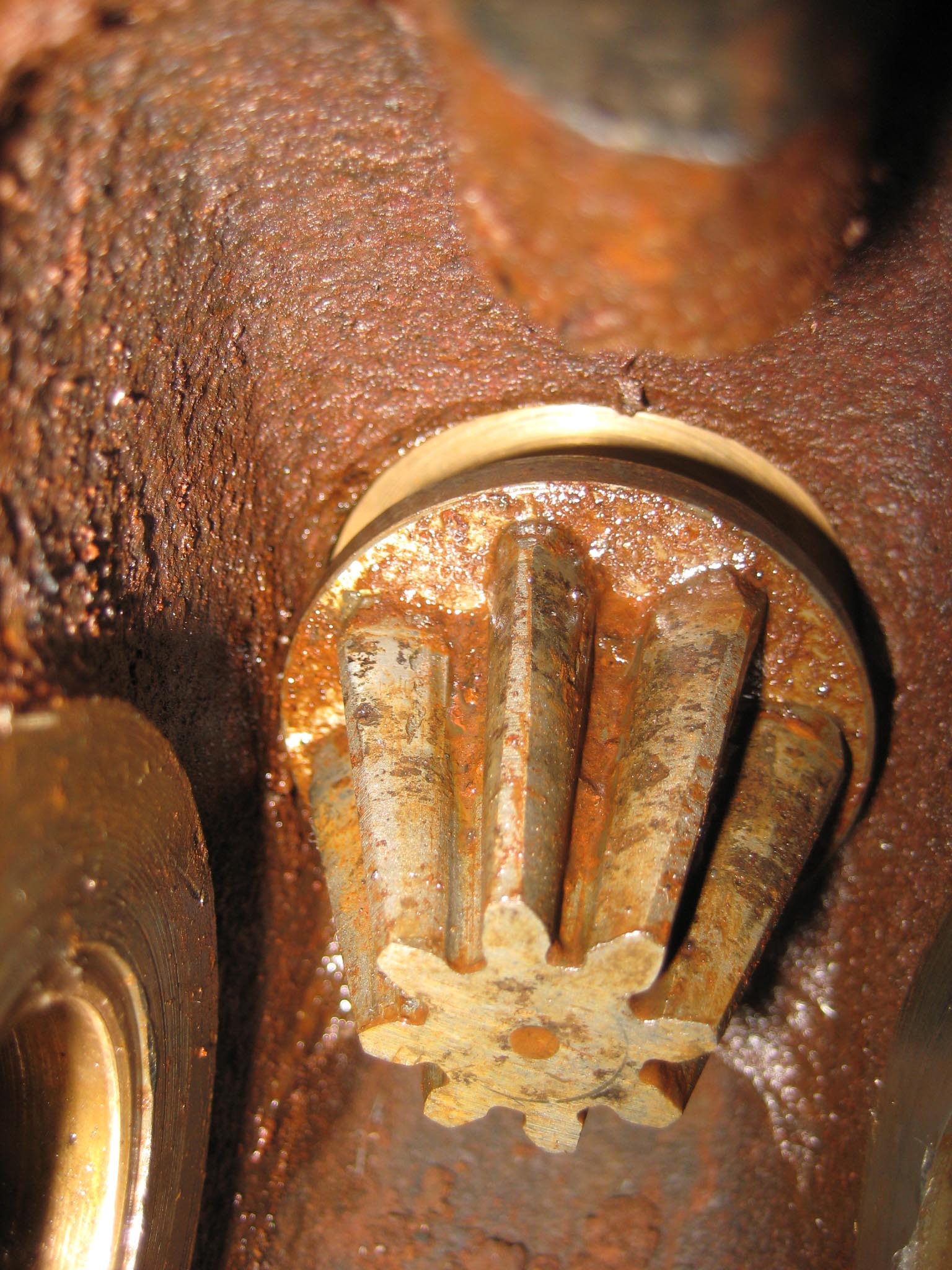

With the miller drive cover removed to expose the gears, there are two locating pins on the axis of the miller drive shaft (see picture 1). These secure the bronze bushes in place and must be removed. When the drive shaft is pressed out, the keys which locate the crown wheel cannot pass through the bushes, therefore the bush is pressed out along with the shaft.

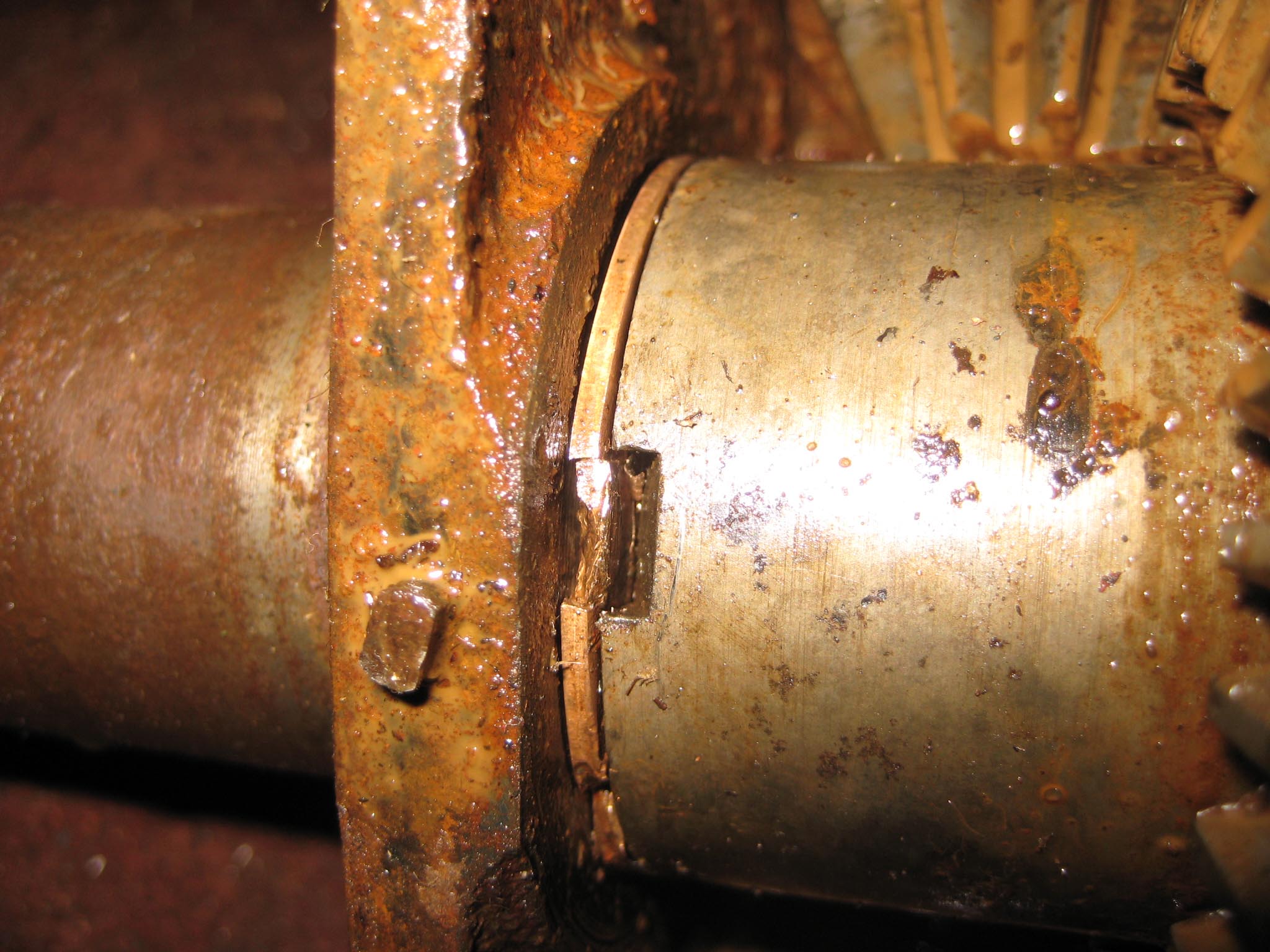

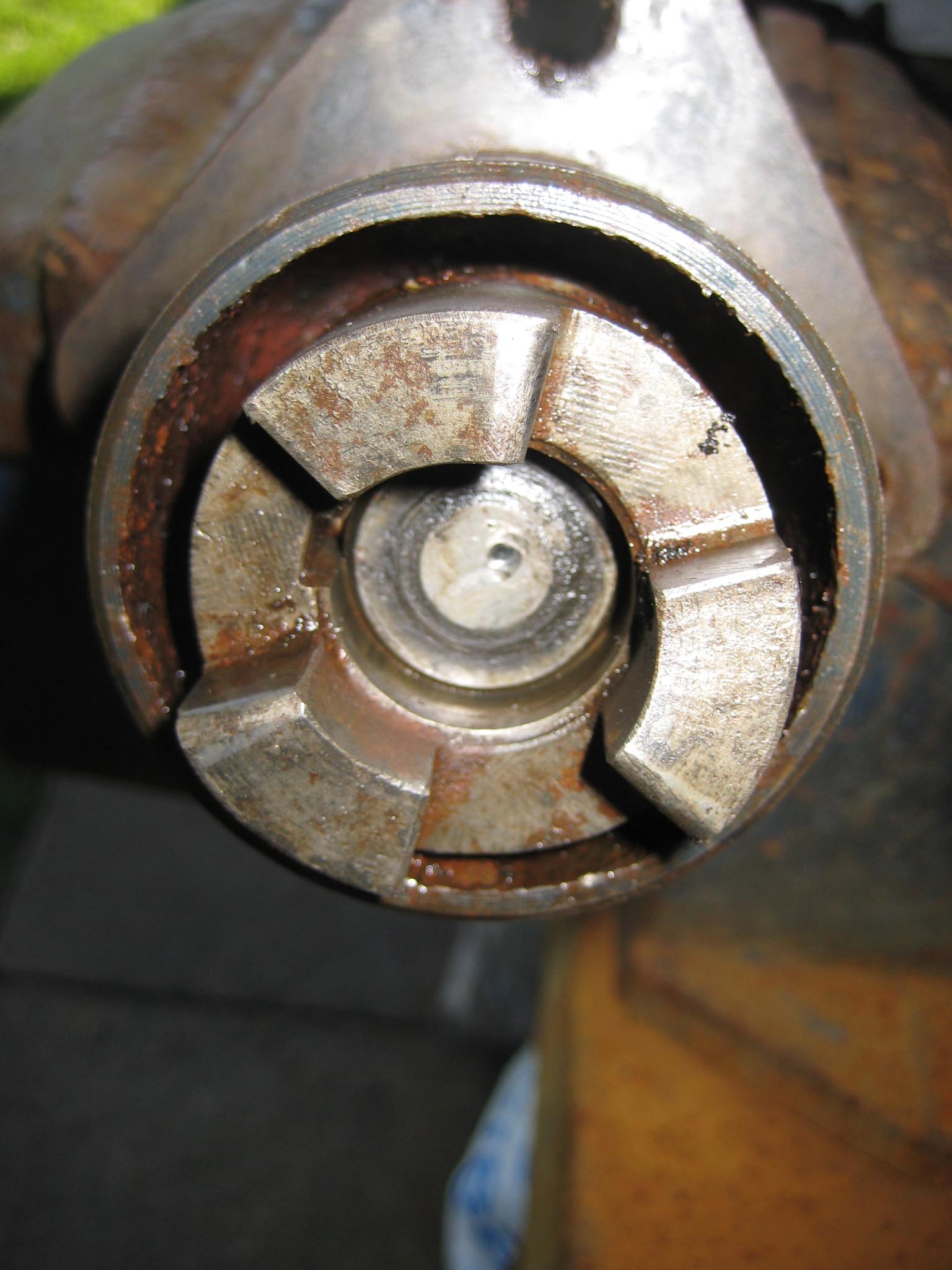

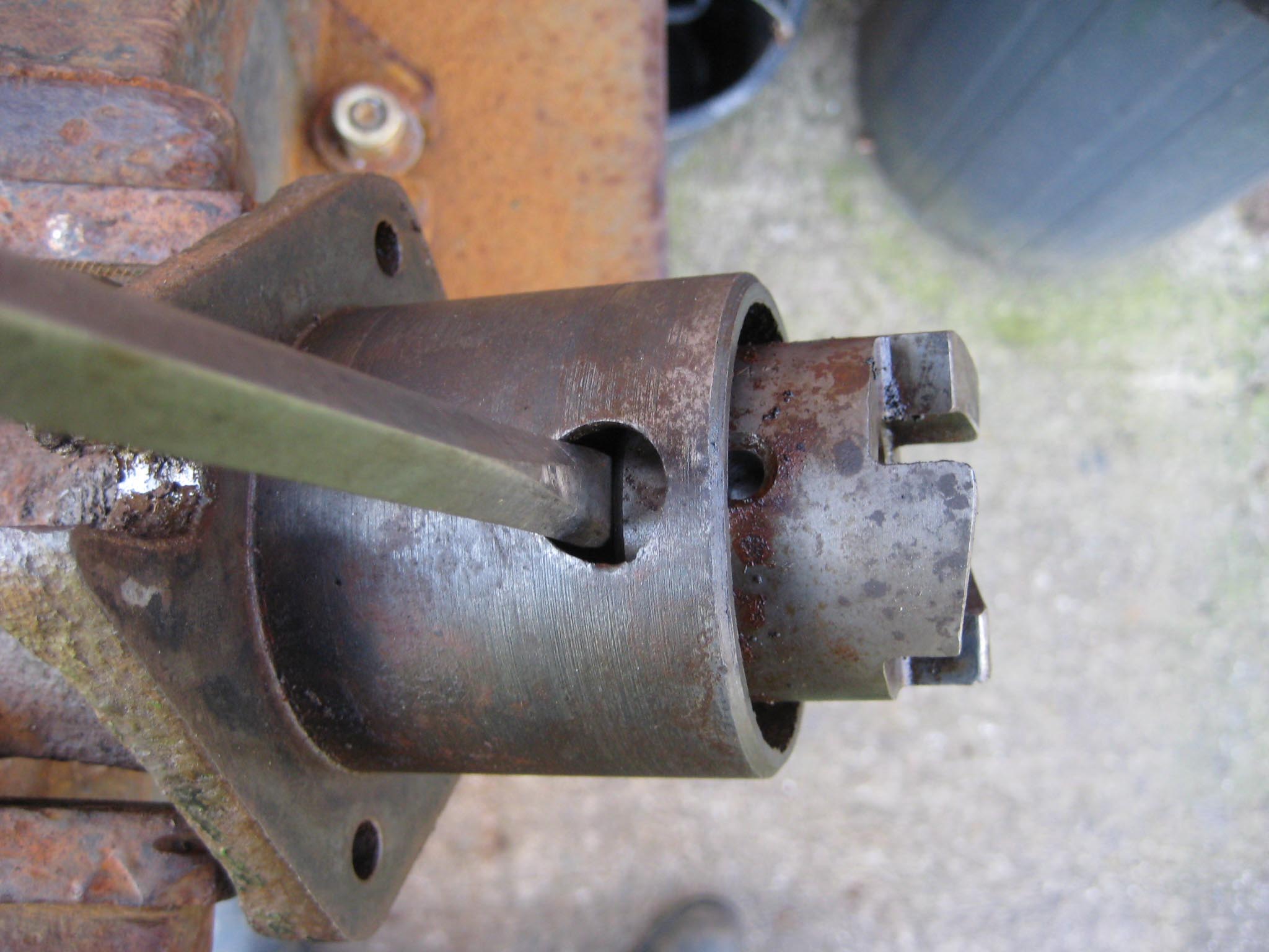

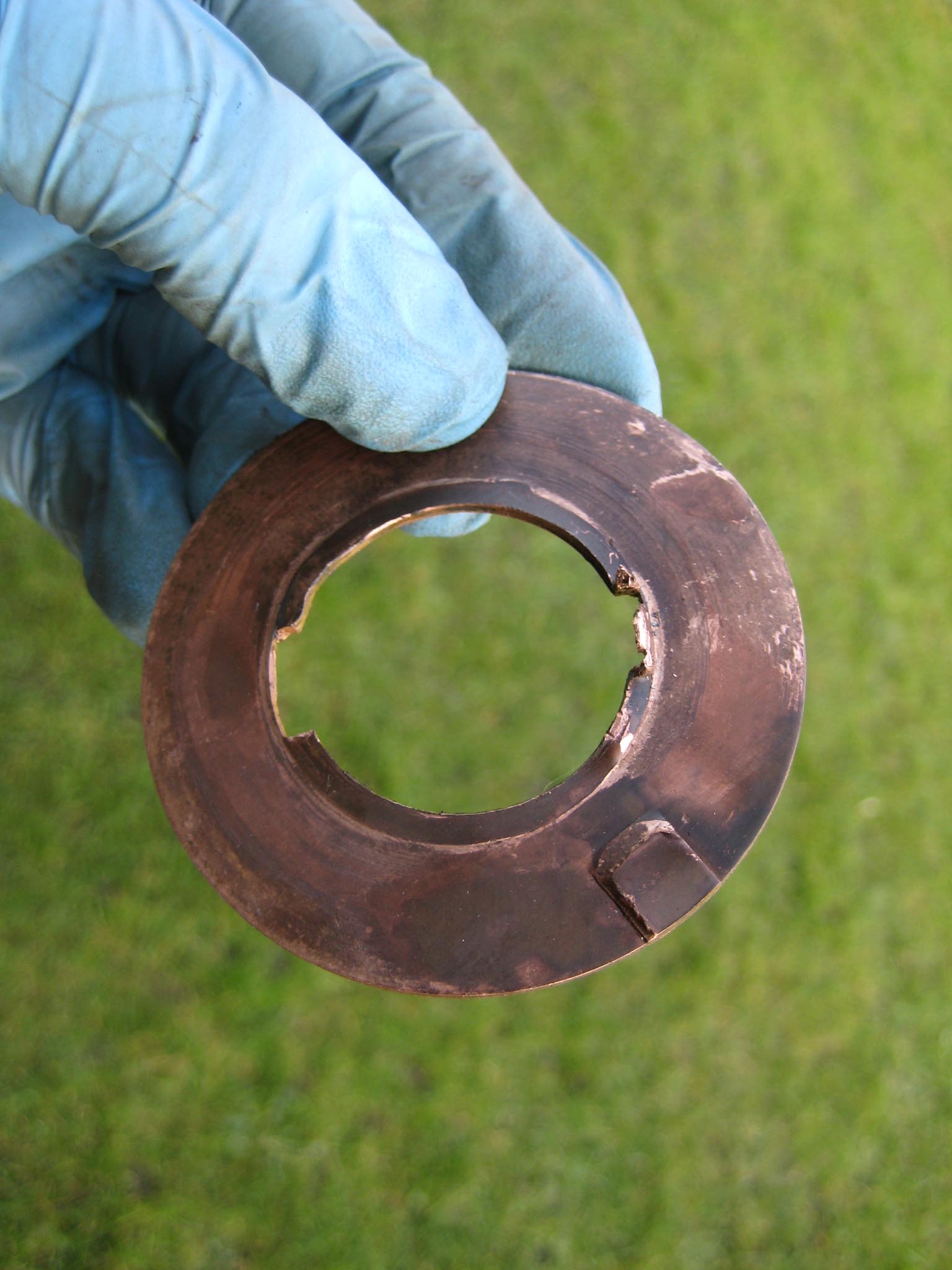

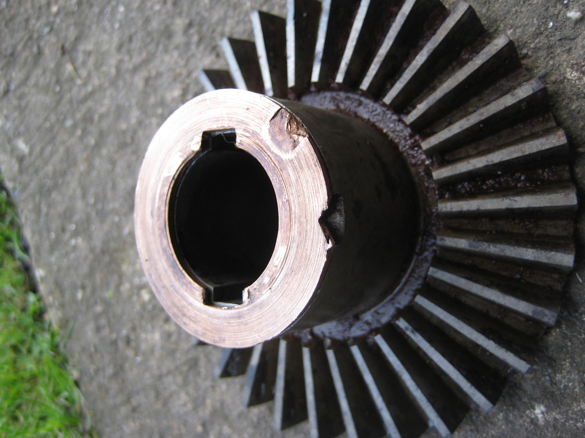

Next step is to align the bronze spacing washer at the left hand side of the crown wheel. This is done by rotating the crown wheel until you can see the locking tab on the washer which is bent over into a matching recess in the crown wheel. Bend the tab on the washer until it is flush, so the washer can now turn independently of the crown wheel. You should also see a ‘V’ shaped notch close to the locking tab. Insert a flat bladed screwdriver into this notch and gently tap the washer around until the notch lines up with the locking tab recess in the crown wheel. The washer has two rectangular notches cut out so the crown wheel keys can pass through. (see pictures 2 & 3). This means the miller drive shaft can only be pressed out in one direction (see picture 4). Unfortunately, all of the above did not become apparent until I had everything dismantled. Being blissfully unaware, sods law came into effect and I pressed the shaft out in the opposite direction, which damaged the bronze spacing washer which is on the right hand side of the crown wheel and does not contain the necessary key slots cut into it (see picture 5).

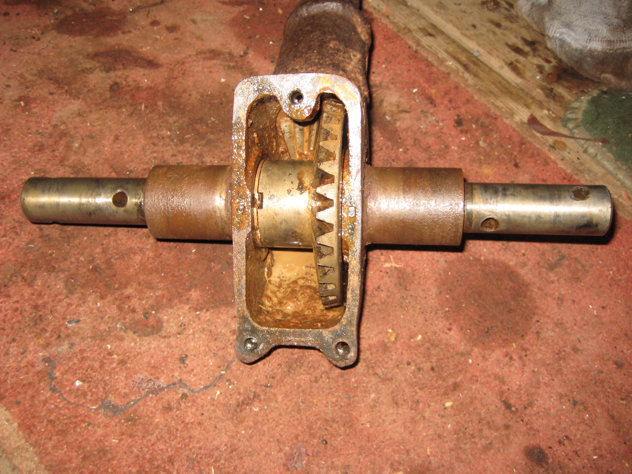

With the crown wheel and miller shaft removed, the pinion can be tackled next. Rotate the dog clutch until the roll pin lines up with the access holes and punch it out. The dog clutch needs to be pulled from the end of the pinion shaft. This is very awkward to do as the puller arms have to fit down the gap between the outside of the dog clutch and inside of the housing (see picture 6). An alternative method is drive the pinion shaft inwards a few millimetres, then from the pinion gear end (see picture 7) drive the shaft back the opposite way. What you are trying to achieve as enough room at the back of the dog clutch to insert a lever (in my case a stout screwdriver) through the roll pin access holes (see picture 8). It may take a few attempts of driving the shaft one way then the other to get the required gap, but it is important to do this in small increments as there is a bronze bush behind the dog clutch which will be damaged by forcing the dog clutch key into it. If you are not replacing the pinion shaft bush, make or buy a suitable puller. Lever the dog clutch from the shaft (penetrating oil and heat to expand the dog clutch may be required).
