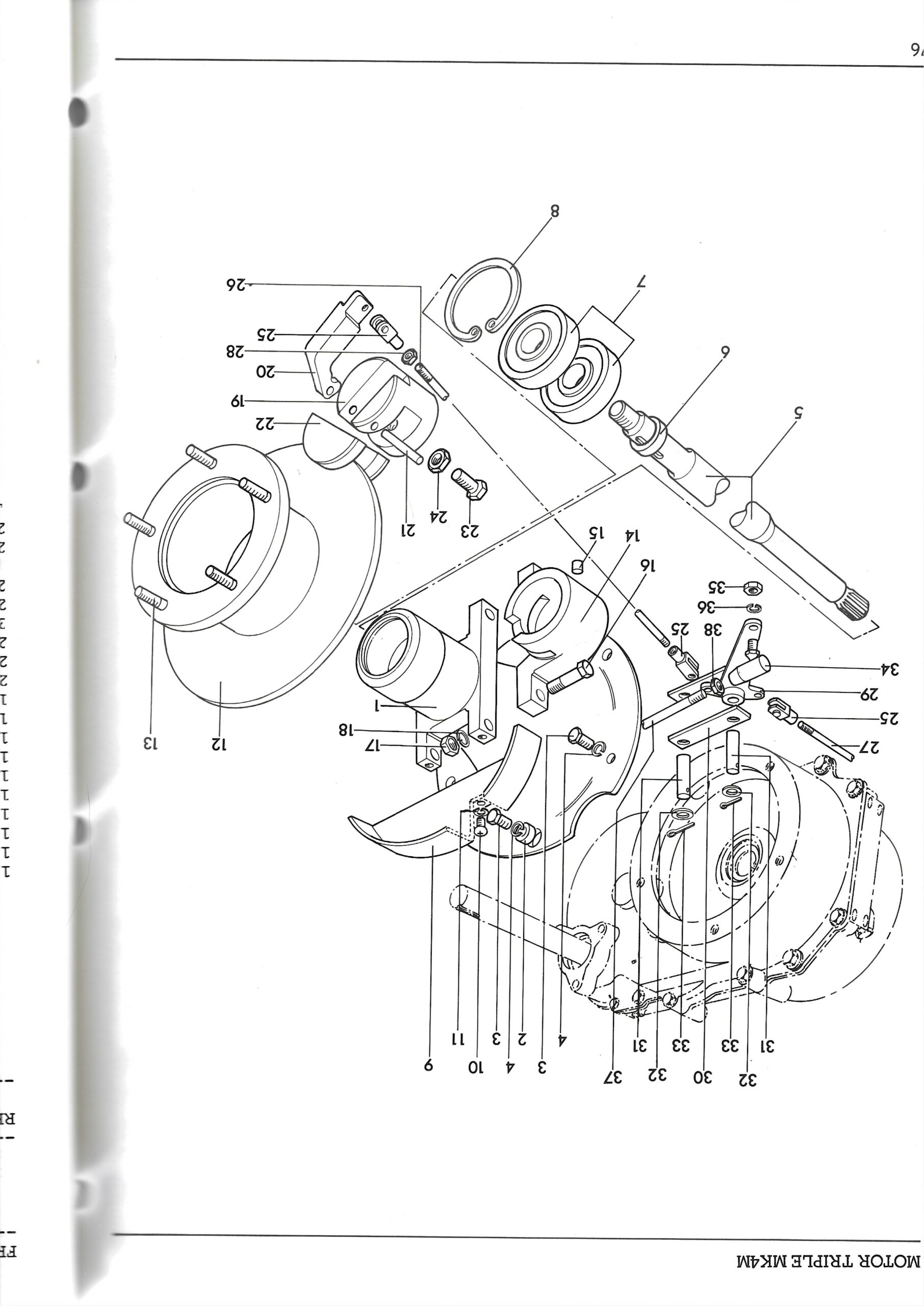

ParticipantHi it’s Will thanks for the advice on the brick cleaner I gave one assembly a good cook in a fire yesterday so fingers crossed I might be able to start a course of hammer treatment later. I just wanted to clarify does both of the round under parts come out (adjuster bolt side and lever side ) and do they both come out on the lever side. I can’t get my head around how they actually work I can’t find any parts diagram for them. I’m sure once apart it will be obvious.
Best wishes WilliamAugust 29, 2022 at 8:09 am #39868
trusty220KeymasterThe round parts that you see from each end are all one piece and are joined in the middle. It has a large cutaway portion to fit the pads into and to allow the disc to reach the friction material. I’ll try to find the parts diagram and post a picture for you. Be patient, I may be in trouble later for making a mess!
August 29, 2022 at 8:55 am #39869
trusty220Keymaster -
