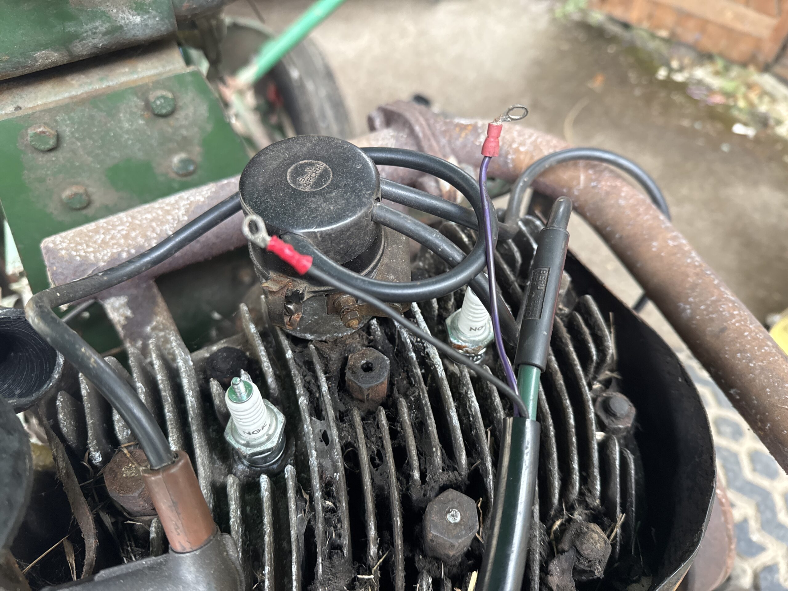

luckyman25
ParticipantI’ve recently become the owner of a Ransomes Motor Triple. It’s in a very tidy condition. I decided that the first thing to do is check the Mag engine runs. So with a fully charged battery the engine spins round very happily but there are no sparks from the plugs. I’m pretty sure the condenser is faulty but would like to check other options. There are two wires that are connected to the points one of which (violet in colour) eventually gets to the Cut out switch but where does the black wire end up? Any help or advice would be much appreciated. Can you still get the points and condenser for this engine?

sidevalve5ParticipantHi Mark,
Glad I can assist and hope the testing identifies the problem. Am unfamiliar with the machine or engine, but from the photos it looks like it has a Kettering ignition system where the ignition is run from the battery. The black wire goes from the ‘hot’ side of the points to the coil. You can test this with the multimeter and for testing would not fit the cut out wire. But again can test it’s continuity with the multimeter.
The most common problems are dirt, or corrosion on the terminals of the LT side. A breakdown of the secondary windings in the coil, or a failed condenser. All easily and cheaply fixed on a Kettering system as the only expensive part would be the coil. If that has failed, you can substitute one from another manufacturer. It’s when they have failed in a magneto it becomes more costly.
Best of luck and please get back to me if you want any further information.
Grahame
June 14, 2025 at 2:48 pm #43812luckyman25
ParticipantHi Grahame.
So after a few hours of playing about I found the issue. The HT lead from the armature to the distributor cap has what looks like an inline suppressor. It has screw threads at each end which screw into the HT lead. Well I unscrewed this gizmo and then re screwed it tight and bingo I now have a spark at both spark plugs. I’m now in the process of cleaning the carb and fuel system to hope fully start the beast tomorrow. For information the distributor manufacturer is S.E.V MARCHAL Can’t say I’ve heard of them but I think it’s French.
