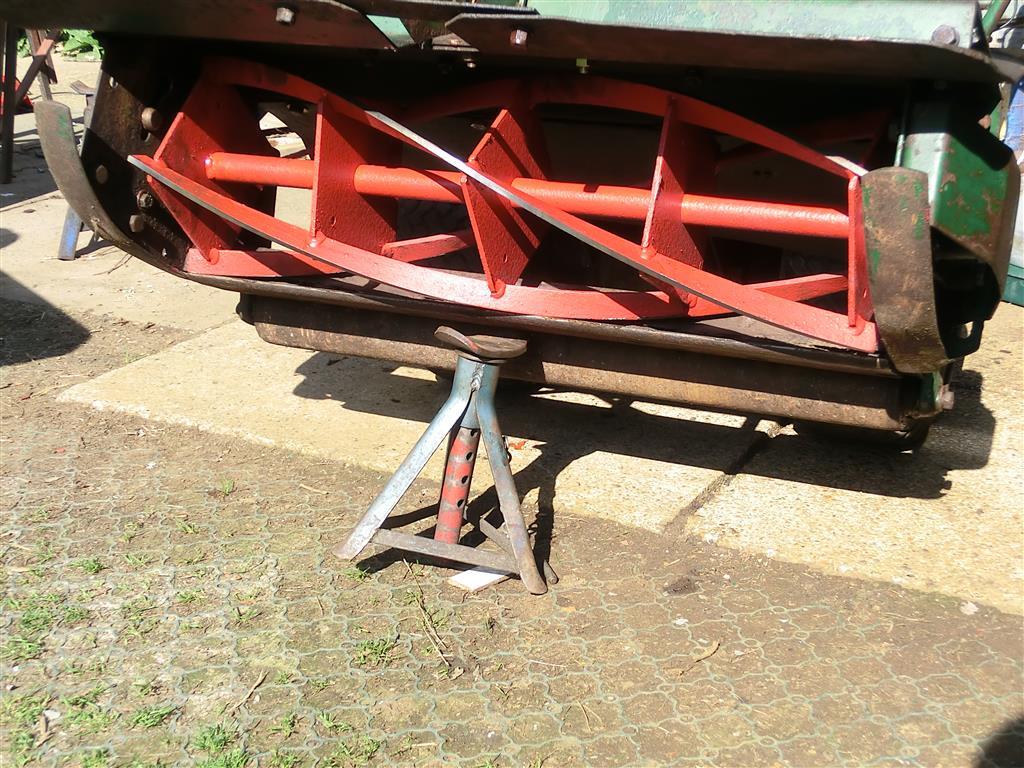

wristpinParticipantWonderful machines and as you say, very capable – so long as you don’t mind walking or nearly trotting when in high gear! We used to buy them ex-local authority in the 1980s and they all found good homes – then no one wanted to walk anymore!
The attached scan is for a JAP engined one that predates even the MAG but the chassis was more or less the same. May be the Kub engined one had an updated chassis? If yours is similar to this one, I can do you a scan of a parts manual, but it’s possible that you have a really modern one, The Vergecutter 76 ! I did a front end overhaul and sharpen on one of those a couple of years ago – heavy going for an old b****r!
I’ve got a 76 ops manual and parts list but not yet scanned. Let me know if that’s what you need.https://www.dropbox.com/s/1rjo6u2s0lxhvch/Ransomes%20reel%20cutter%20multimower0001.pdf?dl=0

wristpinParticipantSomehow I thought this was a flail mower but it’s a cylinder.
What, even after my posted image shows a cutting cylinder?
The early machines were the standard verge mowers used by local authorities . The cylinder could be swapped for a rotary deck but there was never a flail head. Ransomes did make a pedestrian flail , a lump of a machine on twin wheels. We had one that we lent out to tame overgrown gardens before customers burnt out the belts of their new ride-on mower, but it’s work capacity never quite lived up to its looks.

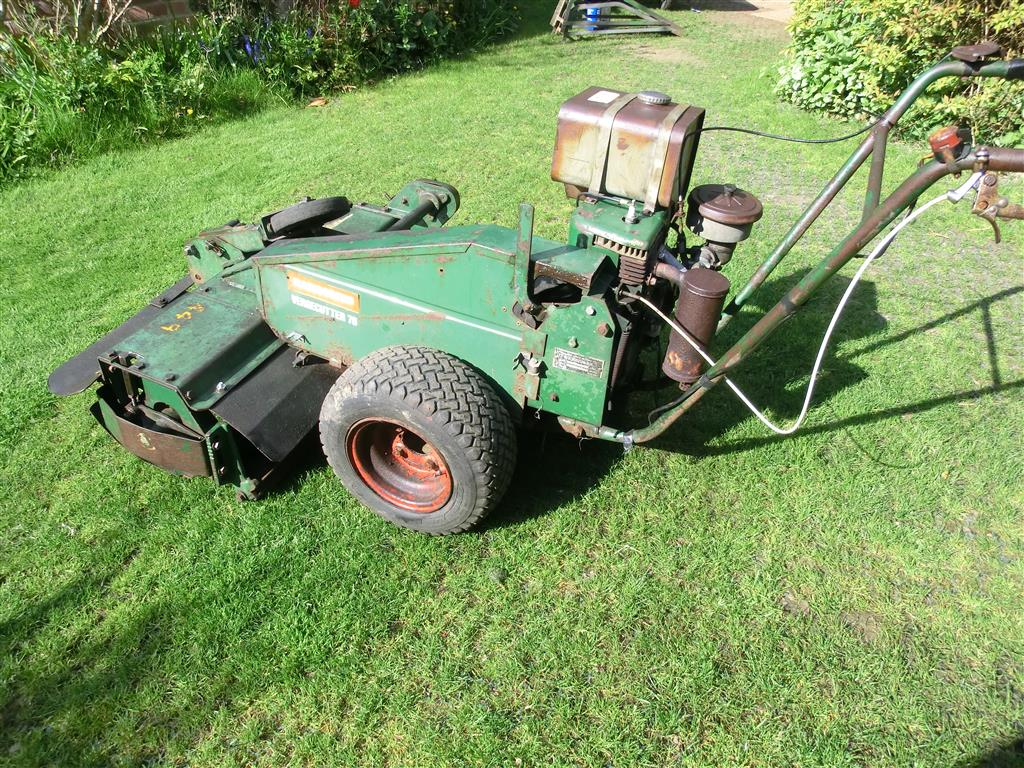

MickFebruary 2, 2020 at 3:34 pm #33160mickwhitt
ParticipantFebruary 2, 2020 at 3:37 pm #33162mickwhitt
ParticipantShows what a modern version of the machine it is, with handbrake and deadman lever that cuts engine when released.
Started to strip it this morning. Split the cutter head off the drive unit so I can service it separately. It is indeed a heavy lump.
