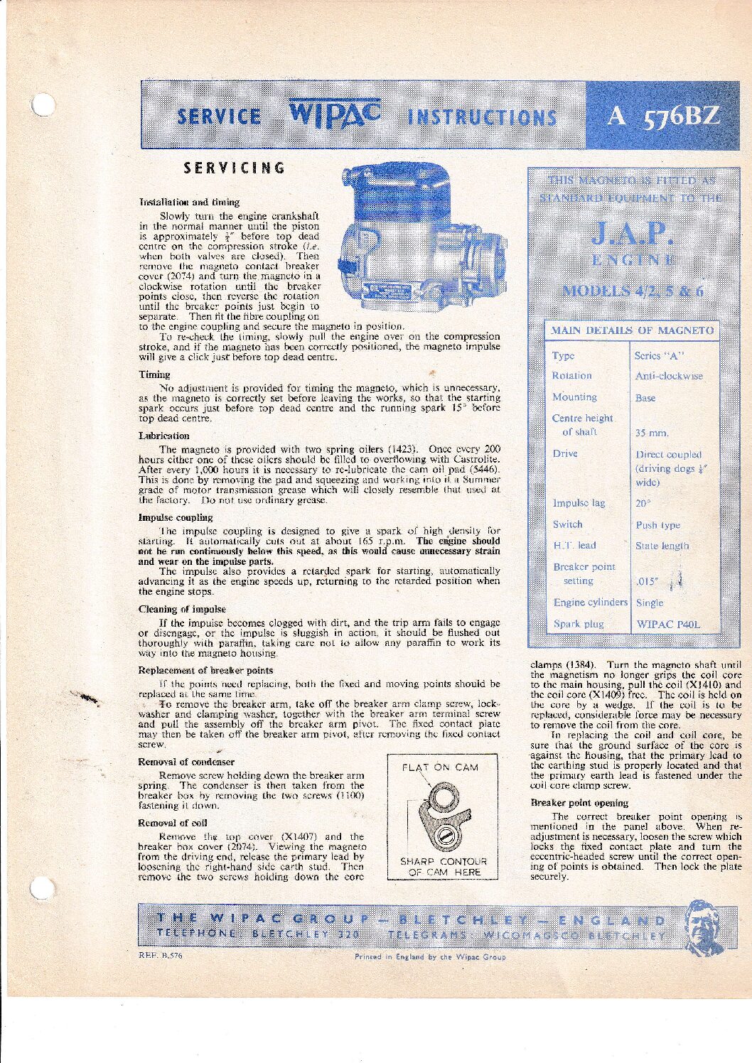

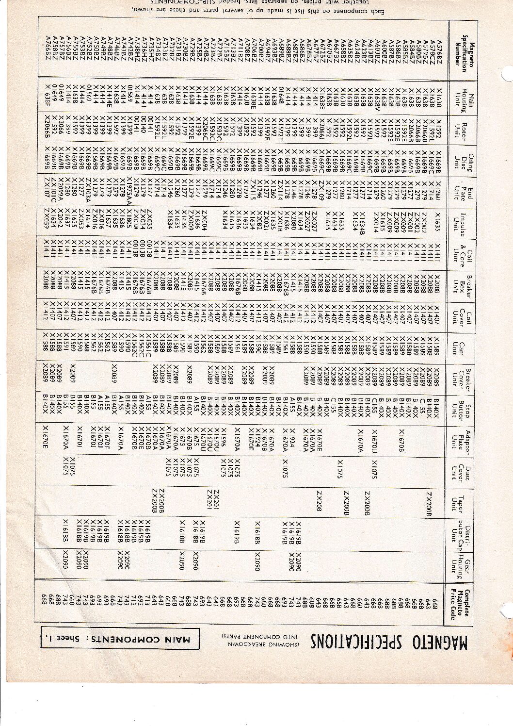

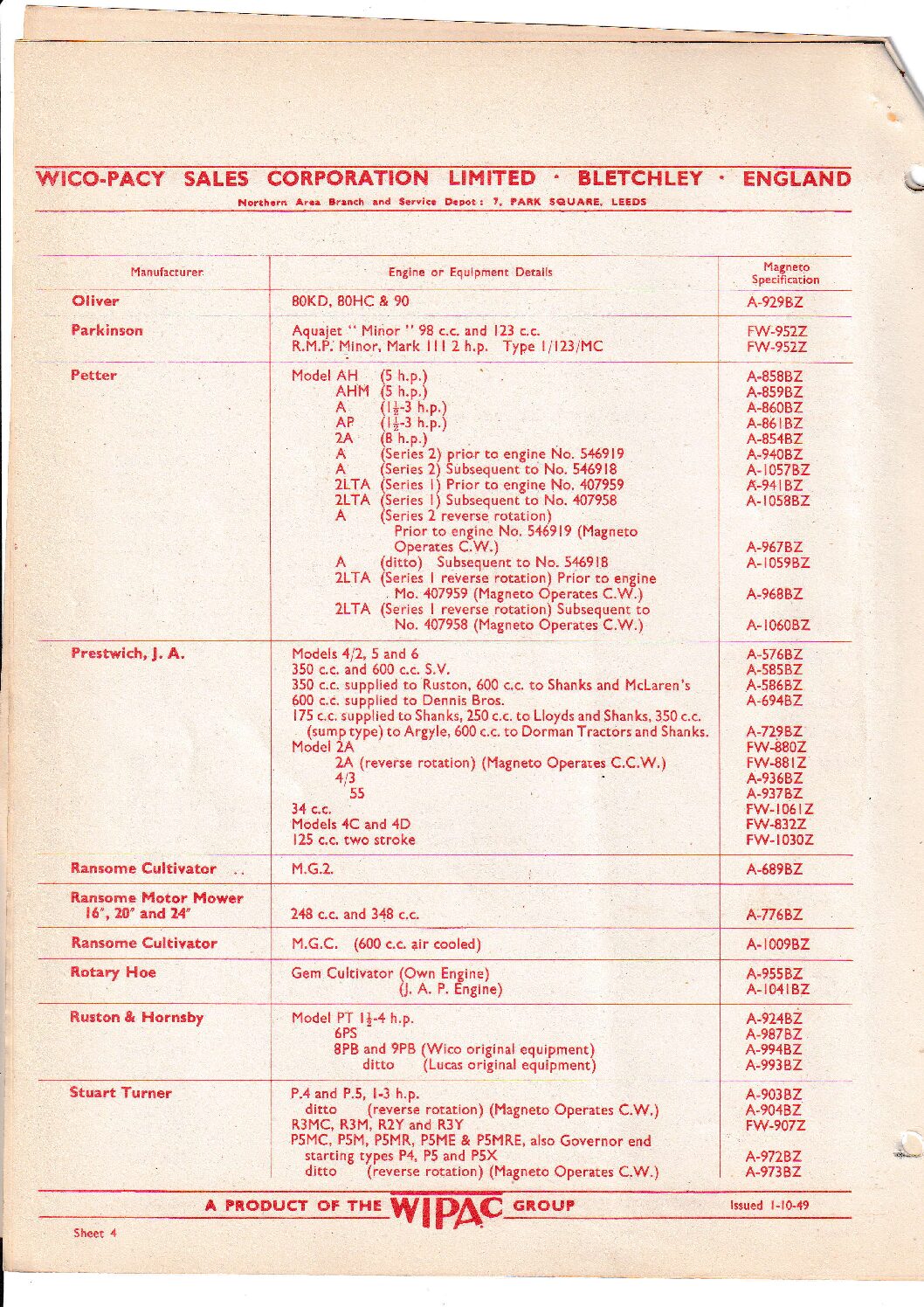

charlieKeymasterOctober 12, 2023 at 4:59 pm #41297disco2
ParticipantHi Charlie thanks for your reply that’s really helpful. Reading through it definitely looks like the timing is out so I will pop the magneto off and have a go at resetting it. There is a click which seems to occur at the time the points open and there is also a tdc marking on the flywheel so fingers crossed it will start.

ParticipantHi it’s Will I thought I would share my happiness I have got the Petter running and it’s running perfectly 😁 it was as simple as the ignition timing was 180 degrees out so took of the mag and rotated the flywheel half a turn and re fitted the mag and it started up. One word of advice though make sure when ‘re fitting the mag that the little clip that holds the points cover on is not trapped between the mag and the valve chest because you have to take the mag off again to free the clip. I found out the hard way.
