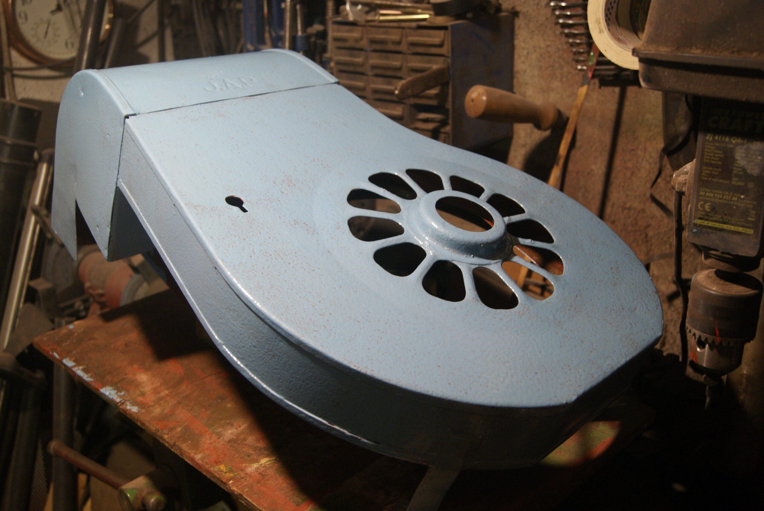

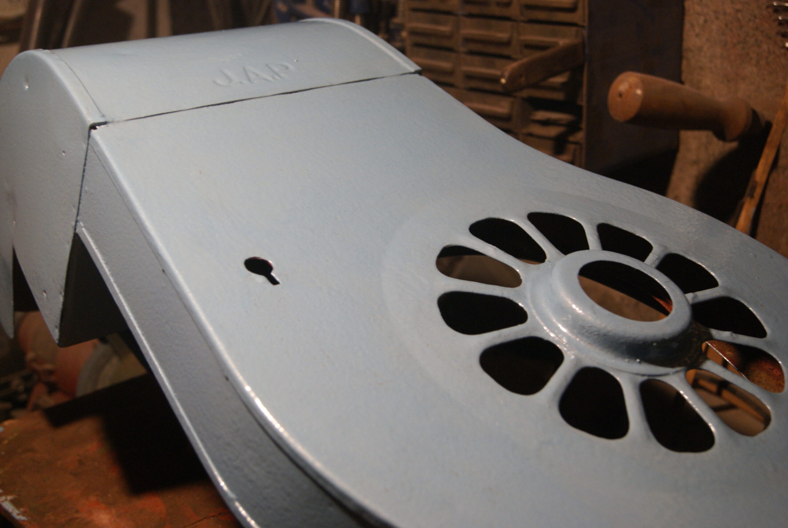

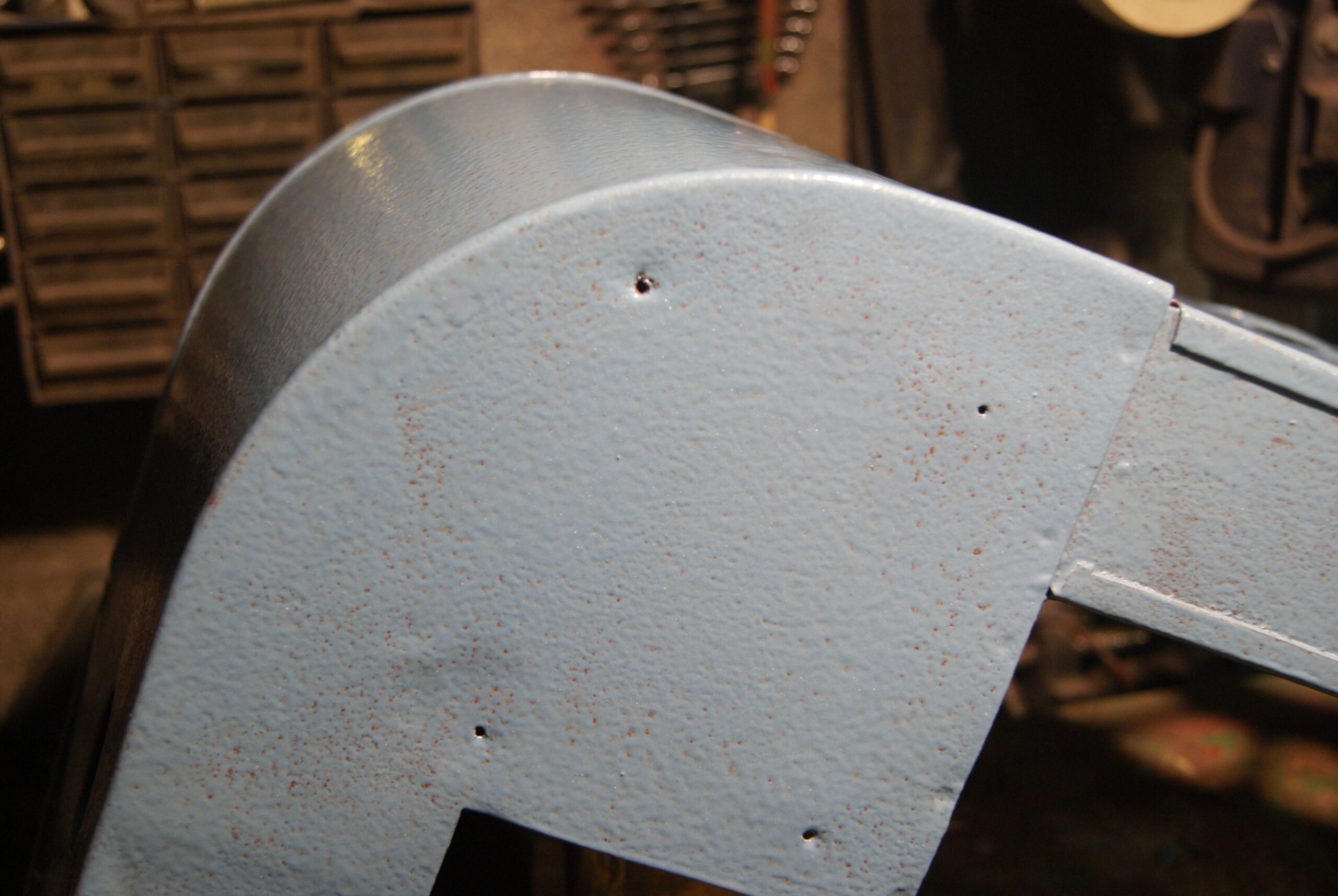

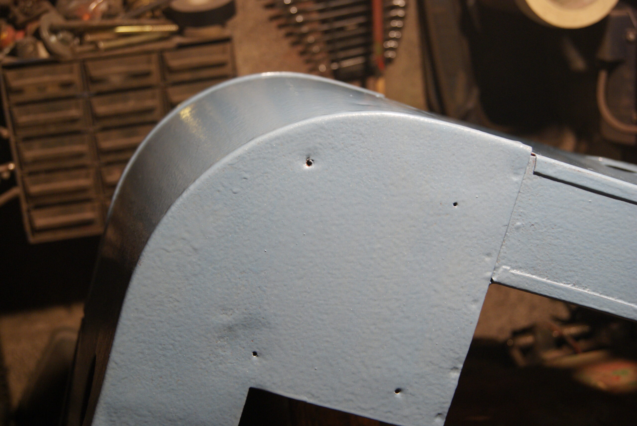

trusty220KeymasterThe paint came the other day and I found time to try it out. Unfortunately I didn’t read the instructions when I ordered it and it appears that it is most suitable for spraying- I have all the stuff to spray it but nowhere to do it!
I ordered the best brushes I could find locally and tried it out with brush application. At present it looks like three coats will be necessary to get satisfactory results; the pictures that I took are after two coats and show a few areas where the paint seems to contract to leave pock marks, very similar to silicone contamination when spraying cellulose, but these should clear up after a final coat.
The colour is spot-on and is a hammered metallic finish. Once I’ve moved and have a suitable workshop I will re-do it by spraying, but until then it will keep the weather out of it.
