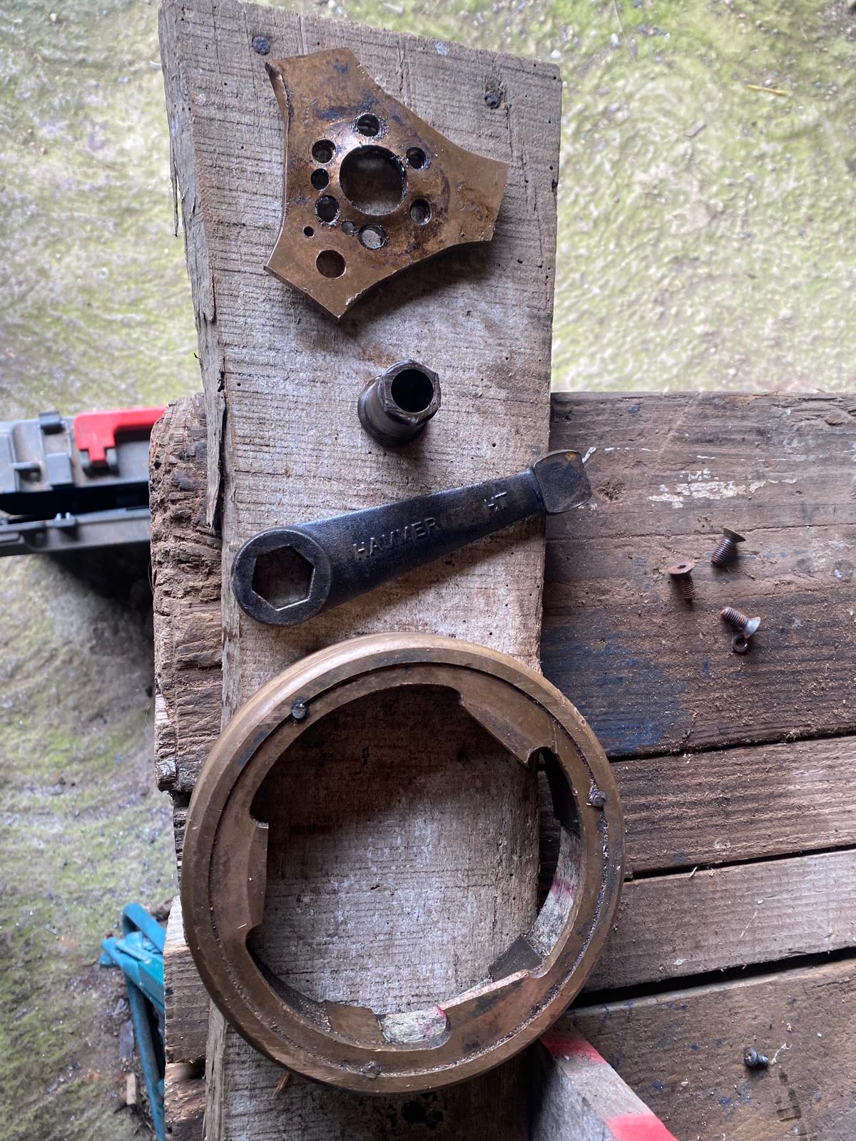

February 24, 2025 at 5:59 pm #43455forger0n
ParticipantHi Andy,
Here are a couple of photos of story so far. Visiting family have helped me dismantle the old boss which, as you can see from the photo, is still stuck on the crankshaft, and we now have prepared my ebay flywheel to replace it without disturbing the boss, and hence timing.The next phase is to reinstall the points and check the timing and, if OK, wire in a Kettering type ignition system. This way we abandon the Villiers coil and capacitor, using only the points to time the spark.
Best wishes…… DaveFebruary 24, 2025 at 8:35 pm #43460andyfrost
ParticipantDave , personally I would give it one more go at removing the boss give it as much heat as you reasonably can , and immediately pour cold water over it , if it doesn’t “sizzle” then apply more heat and repeat , then try your puller , tighten it up , and give the puller a brisk tap with your hammer.
There’s nothing to say your existing coil/condenser have gone , could still be OK, just remove them out of the way before applying the heat.Andy.

Way cheaper, and less bother than messing with coils and batteries.March 3, 2025 at 3:11 pm #43469forger0n
ParticipantMany thanks to Andy and Kevin for their posts.
After great attempts I am sure that I will not be able to get the flywheel off the crankshaft.
Cutting it off with an angle grinder does not appeal, and would need a correct replacement and the need to set the timing
The plan is to take the remains of the brass wheel off the crankshaft (drill out the rivets :see photo) and replace it with the wheel from a flywheel assy from Ebay (cost £17) Before fitting the replacement wheel I will have access to the points but not to the coil fixing which is screwed from the back of the armature plate. The original cam on the flywheel boss should be correct for
