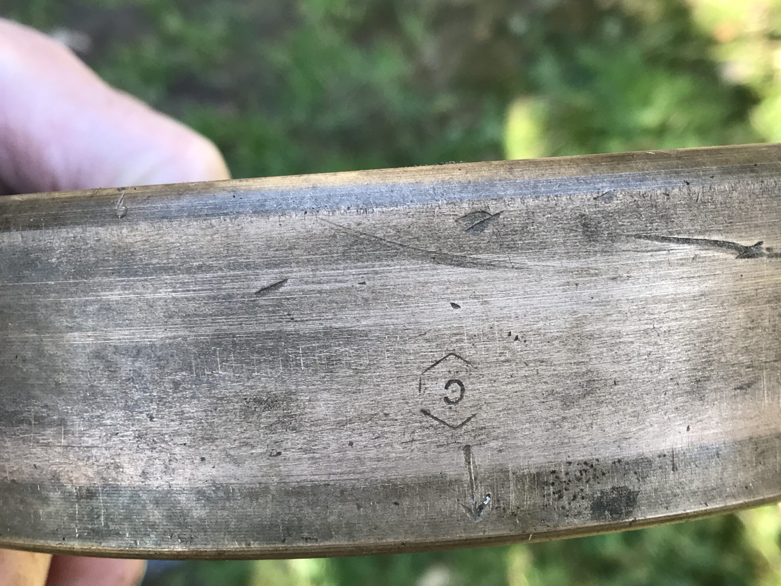

I have an Oxford Allen Scythe which worked OK about 14 years ago, but now seems to need magneto
refurb. Those in the know will understand that to remove the ign. coil I have to remove the Armature Plate. To do that I have to remove the flywheel assembly, and all efforts have so far failed. I’m thinking that I will have to destroy the flywheel to get it off, and then I will need a replacement. Looking for a flywheel for sale, they mostly have a reference No. stamped on the rim. Mine has no marking except for an arrow and <c> (for timing, no doubt) – see attached.
Can someone please help me to identify my flywheel. I have a parts list for the magneto which shows four options for the flywheel assy. and none of the numbers relate to those I have seen on the internet. The machine No. is 61747 – no sign of an engine No.

February 19, 2025 at 8:24 pm #43418andyfrost
ParticipantI’m still a little confused here , going back to your very first photo , it looks to me like you have(or had) the flywheel removed , it appears to be in your hand , and certainly not siezed on the crank ????
