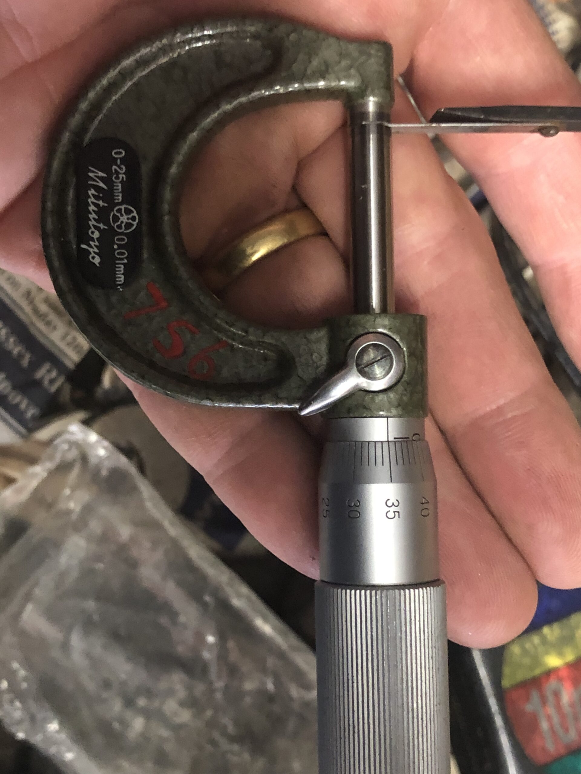

My father gave me a feeler Guate from another mower which he said should be about right ! This maybe the thing they was throwing me off.Picture of feeler Gauge attached.
I’ve now haves that gap and I HAVE A SPARK 😊😋

ParticipantYour points gap should be between 12 and 15 thou.
Do you have access to a vernier gauge , if so , remove spark plug , and reset timing so that your points just begin to crack open at 3/16″ before top dead centre, without Mr Googles help I’ve forgot what 3/16 equates to on a vernier. ALWAYS re-check after you’ve fully tightened the flywheel.April 14, 2020 at 9:54 am #33818

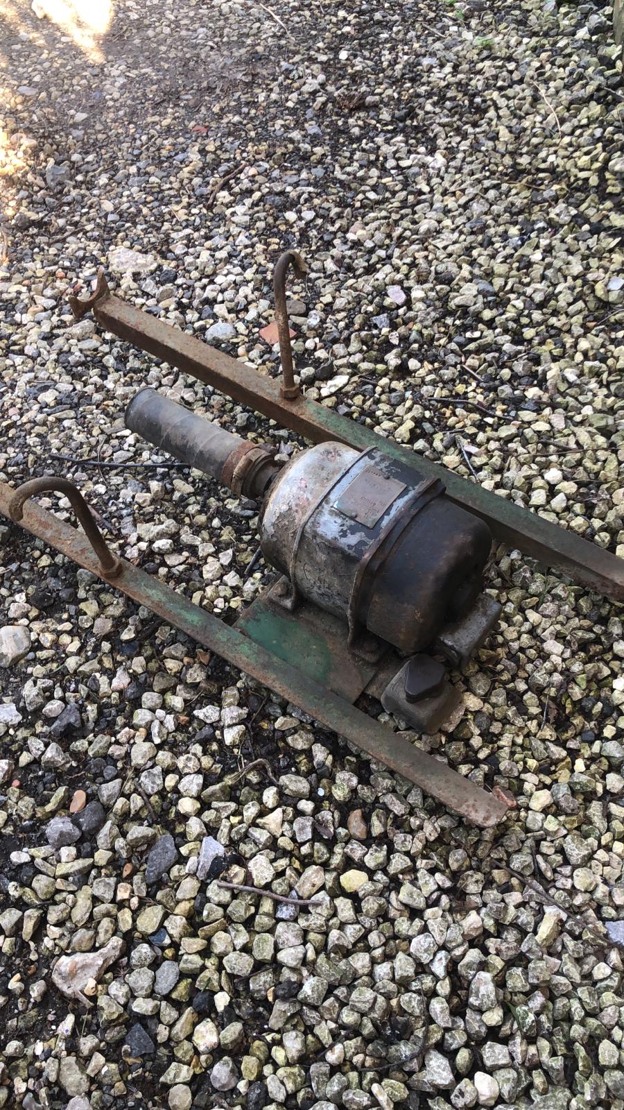

Next to test the 110v generator that goes on the back 😊

will-haggleParticipantTo move onto your generator, it looks like a Tuscan, 110 volt DC which were used with Tarpen accessories – a nice new avenue of collecting, there are plenty of 110 volt Tarpen hedgetrimmers out there, also chainsaws, mowers and even little tillers! It also doesn’t matter if they are AC or DC, as the brush type motors that Tarpen used will run on either!
