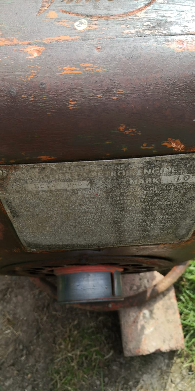

vhgmcbuddyMemberThanks for that. I had a look a bit further into it this evening. The dipstick didn’t show any oil at all in the gearbox so it must have escaped over the last 10 years at some point. The engine in a Villiers Mark 40 and runs pretty well. I filled it up with some new oil and cleaned all the moss and crap away from the clutch fulcrum. The clutch freed up after I worked it back and forward a few mm at a time and seems to be working fine.

I agree that the rotor box is heavy but not impossibly so. The tine situation is good. I did find that the Howard Gen tines fit the Yeoman. I suspect that the Gem tines are beefed up to cope with the extra power so they should last longer on a Yeoman. In my case it is essential as the original engine had to be replaced and now has a 13Hp Chonda unit rather than the orignal BSA420.

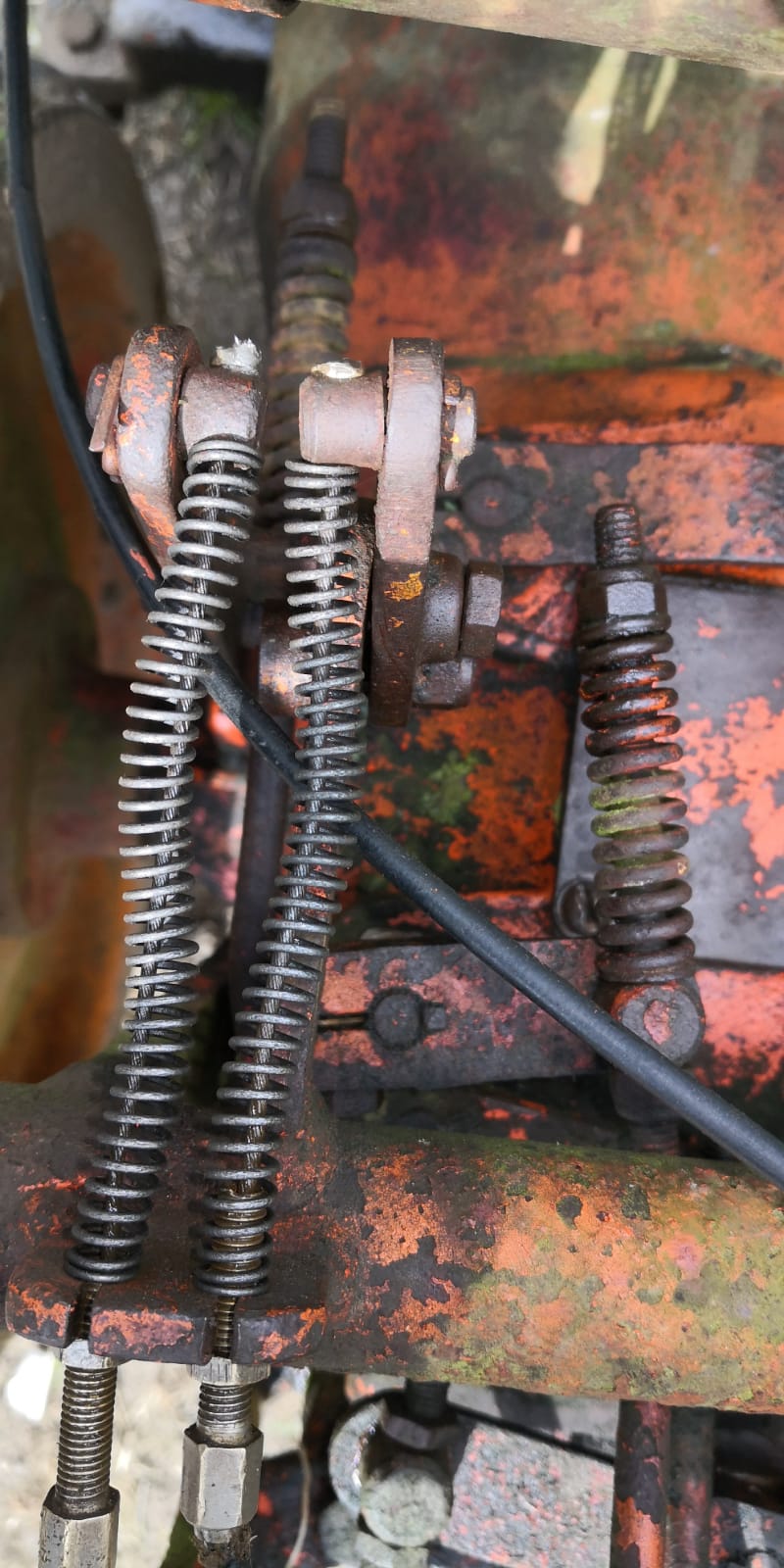

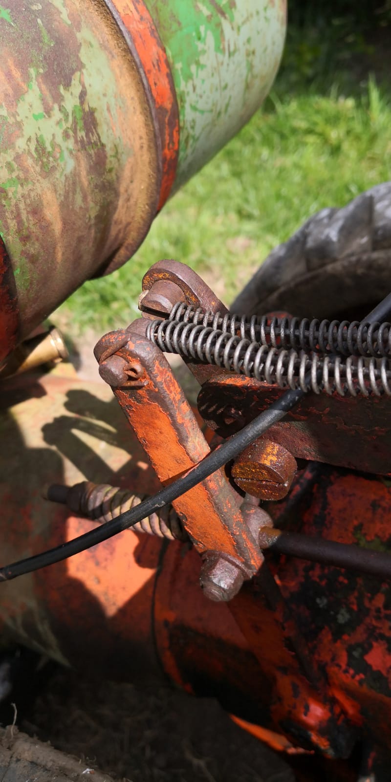

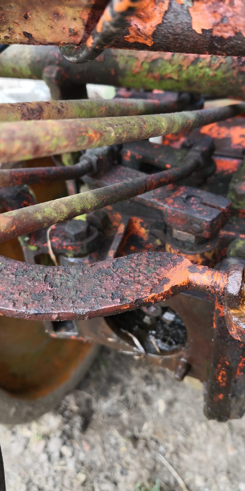

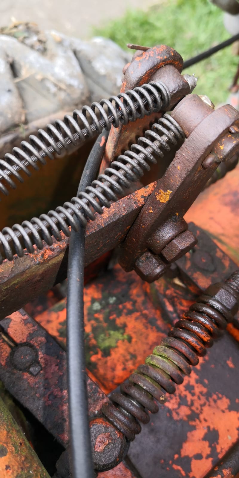

vhgmcbuddyMemberApril 4, 2020 at 11:32 am #33688
vhgmcbuddyMemberI don’t know if those are enough to make parts for it but I can take more if they don’t make sense.
There are 2 parts to it as far as I can see. One lever shown in the 5th picture is activated when the gear selector lever is pulled back to engage reverse. It is attached to a rod which pulls the clutch in too (its called the reverse lock rod on the diagram in the owners manual). Then the mechanism reengages the clutch when you pull the reverse interlock lever.Let me know if there’s anything else I can help with. My old mate just dropped off his owners manual into my letterbox. I think its an earlier one than the ones I’ve seen online. From my description over the phone this morning, he doesn’t have a dead mans clutch on his, it’s just same as usual, and his reverse interlock is missing too.
