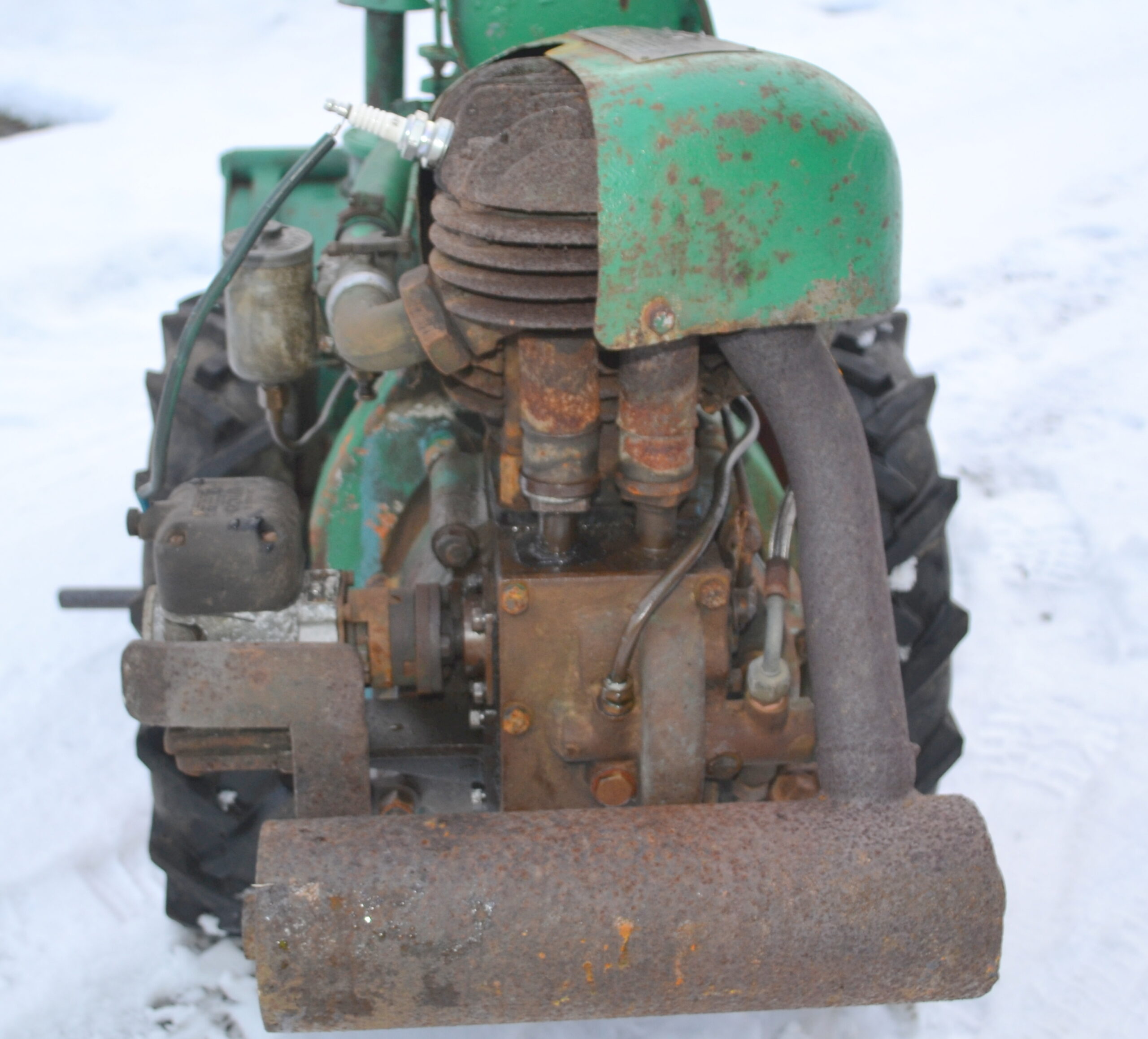

vhgmcbuddyMemberHi all, I have had owned a Howard before but not one this old. Its a Howard Gem with a BJ engine. People tell me its a dry sump and that it needs oil. Tried looking in the on line manuals but cannot find how to or when to put in oil and what type. Also any tips or help in starting the machine plus maintenance tips would help. Lastly, any advice on removing the covers to do some welding and replace the tines.

Participantoil goes in the front section of the fuel tank. it should have two filler caps rear one is for petrol front one for oil I use sae30 oil but make sure the tap under the oil tank is turned on ie straight down the dry sump system works by pumping oil from the tank and round inside the engine the pump is situated at the front of the engine as viewed from the handlebars dave
January 20, 2016 at 7:00 pm #15800
stuartParticipantThere should be a twin compartment fuel and oil tank on the machine.Petrol in one side where the pipe goes to the carburettor and engine oil in the other.The engine has an oil pump fitted and the oil then returns to the tank (or should do !!).

hortimanParticipantI would maintain at least half a tank full at all times.
When the engine is running you should see oil bleeding back into the tank, in spurts. Just take off the oil filler cap, look inside you will see a short stub of pipe just under the cap, this is where the oil should return into the tank. don’t expect a big gush, as it only just comes through in small spurts.Good luck
