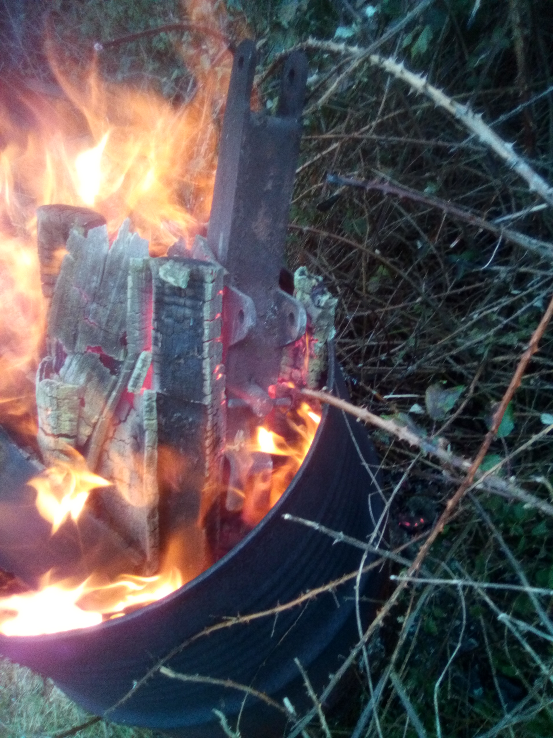

trusty220KeymasterI’m told that the artwork for these stickers is nearly finished so I’ve taken a little time out to fettle up a headstock to put the first one onto. I had the idea that I would make up a display of all of the Trusty tools that fit to the headstock, so this is the first stage.
I don’t know about you, but it’s ages since I’ve tried to get one of these apart and it certainly brought back many unhappy memories struggling with this one. All of the bolt-on parts came off easily but where I always struggle is getting the pin out of the front casting to separate the front from the back. The pin normally rusts itself to the casting and you just cannot get enough heat into it to get the pin to move- until now, that is! Back to the farm with a few wooden pallets I went, filled up the oil drum with them, chucked a bit of old hay in to get it started then go for a cup of tea. By the time I came back it had settled down to a lovely red glow all around the drum with a thick covering of hot embers across the bottom. I put the headstock in (minus the aluminium cast pieces) and filled it up again with more pallet wood. After a short while the whole assembly was glowing red so I left it to burn out and cool down. That night the pin came out with a bit of persuasion from the lump hammer but it wasn’t easy- the technique is to knock it backwards and forwards, dosing it with oil and WD40 every time. Eventually it moves more and more until it comes out completely.
I have now got it to the paint stage, so not long now!
PS Normally using this technique I pull the red hot metal out of the fire and plunge it into the stream to crack the rust seal by using differential expansion/contraction. This works well if you have a steel fabrication but I didn’t trust it with cast iron; you only break it once!
