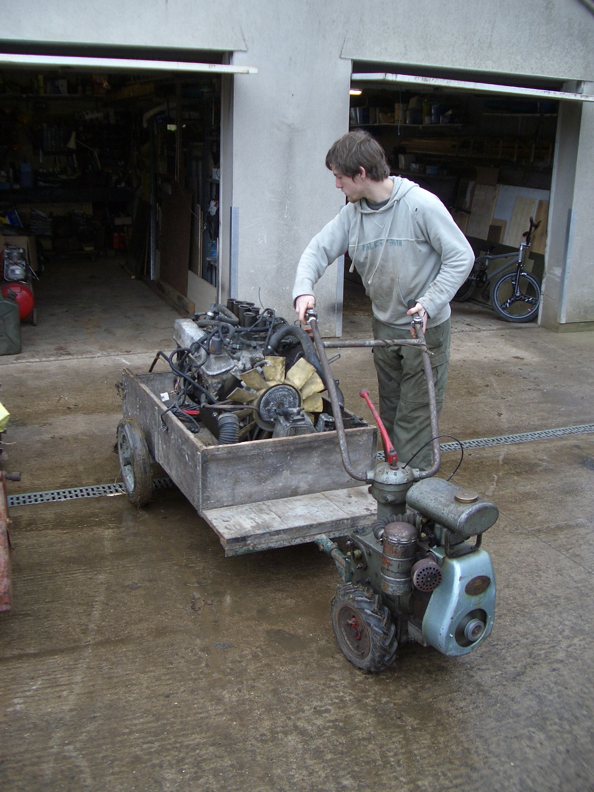

charlieKeymasterJohn, it sounds like it may be the original engine which someone has painted. I will send you some engine information. I have attached a photo of my series 3 machine, with genuine Monrotiller trailer trailer and my son driving. I had a go, not too successful, at matching paint colour which is why the engine cowl is wrong colour.

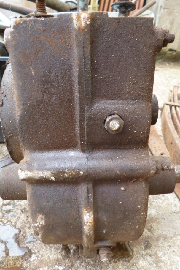

I have just rebuilt (successfully) the Mk15 engine for my rotovator. Now I need to know about the oil requirements for the two (gear trains?) just in front of the tiller unit. How do you drain the emulsified oil out as there doesn’t appear to be a drain plug, and what oil do I refill them with (20-50??). I was also surprised that the tiller shaft did not have any grease nipples at either end and the free end appears to be a plain bearing.

Gearbox oil should be a non EP grade,( ie GL4 not GL5), sae 140, I use Morris Oils AG140
To drain the gearbox oil there is a drain plug located towards the front of the right hand half of the gearbox casing, near the join between the two halves of the gearbox case. DO NOT attempt to undo the bolt towards the rear as this holds the gearbox oil pump in place.
Fill gearbox through the hole for long dipstick, operators manual details how to check levels. The level on the short dipstick can only be checked after running machine in neutral for 2 minutes as the oil is pumped up by the oil pump.March 17, 2021 at 9:18 am #36792john-e-w
