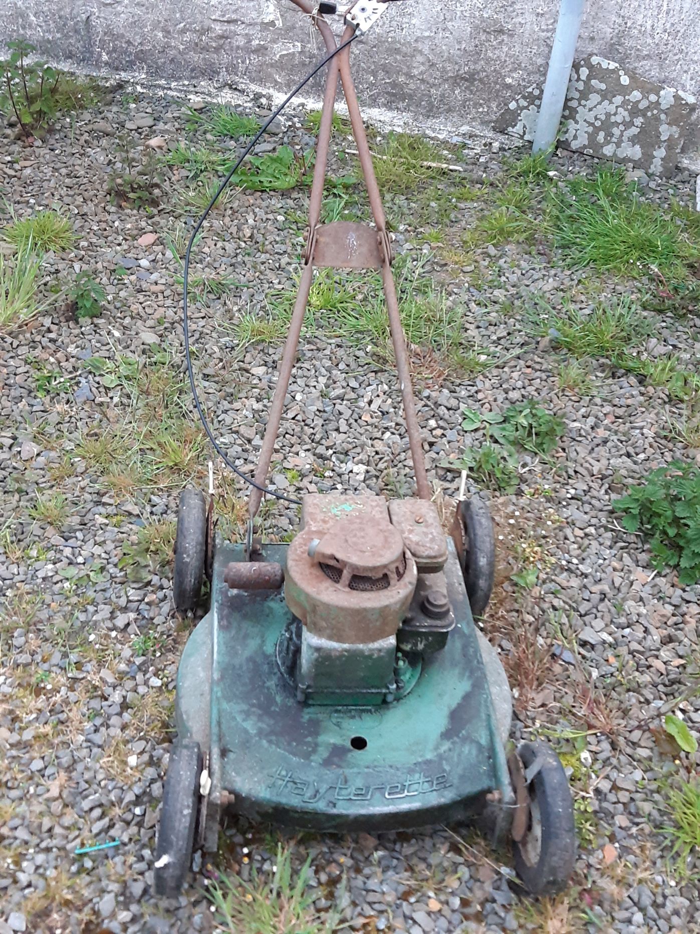

    I am looking for information on this old mower. Anyone know what date it is?

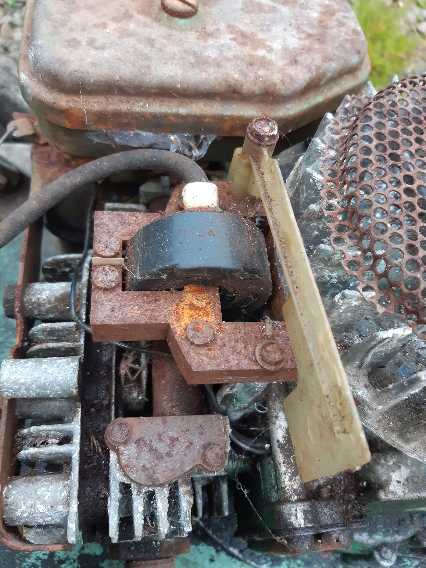

    I am looking for a coil, any idea where I can find one?

    Your old mower is a Hayter Hayterette. The engine can be dated using the engine number see Briggs and Startton website

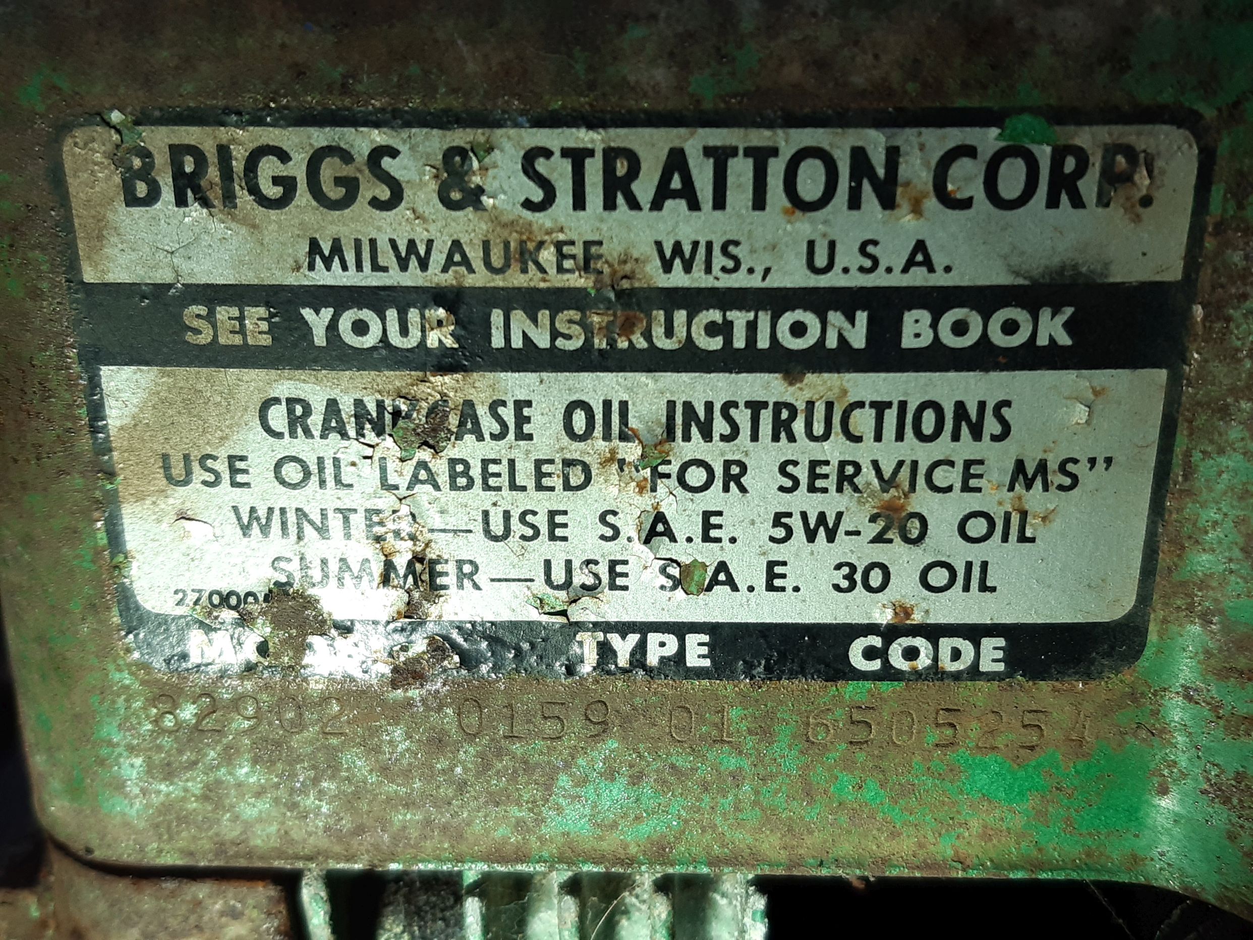

    Thanks for your reply, but the website does not seem much help with dating the engine. As far as I can make it out (its very difficult to read), the stamped number under the sticker reads:
    82902 0159 01 6505254
    This does not seem to follow the format shown on the website.
    Secondly, any idea where I would get a new coil from?

    Coils are readily available online , personally I would opt for a Magnetron version , does away with points and condenser , I’ve used the aftermarket ones and they appear absolutely fine.

    Engine date I recon is 25th May 1965 (650525 part of engine number).
    Why do you think the coil needs replacing? No spark could be as simple as corrosion on the points, easily cleaned with sand paper. I have used Briggs Bits in the past for engine spares.
    The Hayterette was launched in 1957 and continued in production, with various changes, for 62 years. I have a very early 2 stroke one.

    Date is the last numbers backwards you have 65 05 25 4
    4 is the line or factory
    so the rest works out to 25th May 1965! So they could trace exactly who built it!

    I swapped the coil on my 1968 Merry Tiller for an electronic one, easy job and it always has a good spark now. I wish i could sort the carb. as easily!
