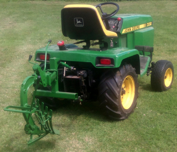

alanParticipantI’ve been slightly spurred on by Geoff creating the new ploughing pages for the website and I decided today that I’d get out my much under-used John Deere 332 and the plough and intend having a mess about with it this week.
The plough is really for a Merry Tiller but we modified it to fit on the back of the John Deere about 5 years ago but then never tried it. I don’t know what the results will be but it’s worth a try!

The problem is the weight: with a pedestrian you can push down on the handlebars with the whole driver’s weight but on a four wheels it’s impossible!July 7, 2014 at 8:44 am #9001mickattwo
ParticipantThe pictures are of a potato lifter not a plough
July 7, 2014 at 7:24 pm #9026andyfrost
ParticipantSorry , but that is most definately a Merry Tiller reversible plough.
July 7, 2014 at 8:06 pm #9027
trusty220KeymasterQuite a few of the plough makers in the 1980’s experimented with slatted mouldboards as a way of minimising the friction ( and hence the power needed to pull the plough) so that they could use a smaller tractor or add another furrow; this plough is one that was used on a very low-powered machine and so friction would have been a major problem. The slats also had a beneficial effect on the finished seedbed because they would break up the soil if you travelled fast enough, thus doing away with further costly field operations.
It should do a good job- let’s see the pictures of the results, Alan!July 7, 2014 at 9:33 pm #9040
terranoParticipantIt may plough ok on an allotment or light stubble land but I don’t think it would plough grassland or heavy loam. (no disc or landslide) but worth a try.
July 8, 2014 at 6:49 pm #9073
alanParticipantThanks for the input everyone, very helpful and good to have different ideas about how it may – or may not – perform. It might be a complete disaster!
I came across the Merry Tiller plough at York Machinery Sale, nobody wanted it and I purchased it and the accompanying wheels for something like £20. Oddly the chap that bought the Merry Tiller in the previous lot didn’t want the plough – perhaps he already had one. And that’s how I came to have the plough – it was either me or the scrap man!

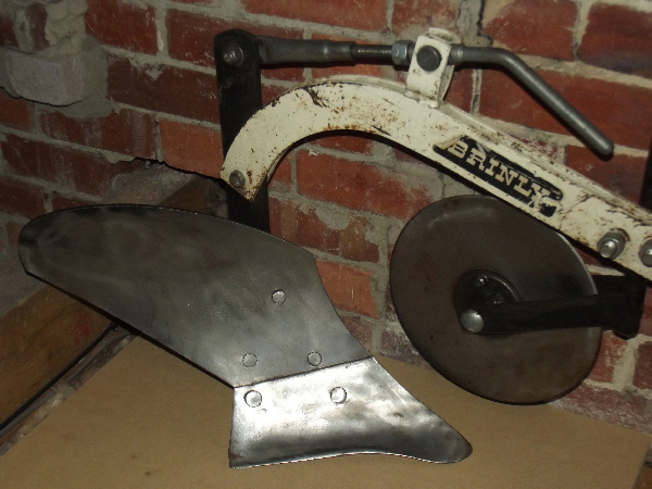

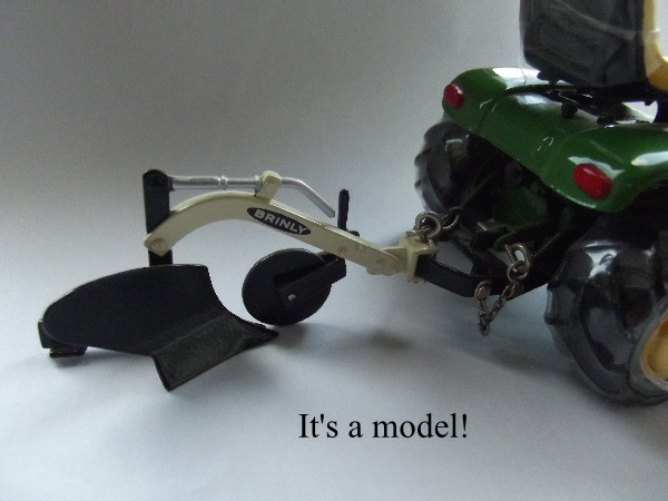

I do have the proper Brinly plough for the John Deere (also fits my Cub Cadet 100) but I’ve never used it or even had it attached to either tractor – it’s been in the loft for many many years, I’ve just taken a photo of it in the dust and cobwebs. I also have a photo of a John Deere model on my shelf with the same plough attached to show what it should vaguely be like.
Back to the Merry Tiller plough, I just intend to break up some good topsoil that was put in a garden last week so nothing difficult for it. I did try it in the field where the grass has recently been cut and it dug in well and was fine. However as Terrano rightly commented it probably wouldn’t be the best choice for where the going was a bit tough.
