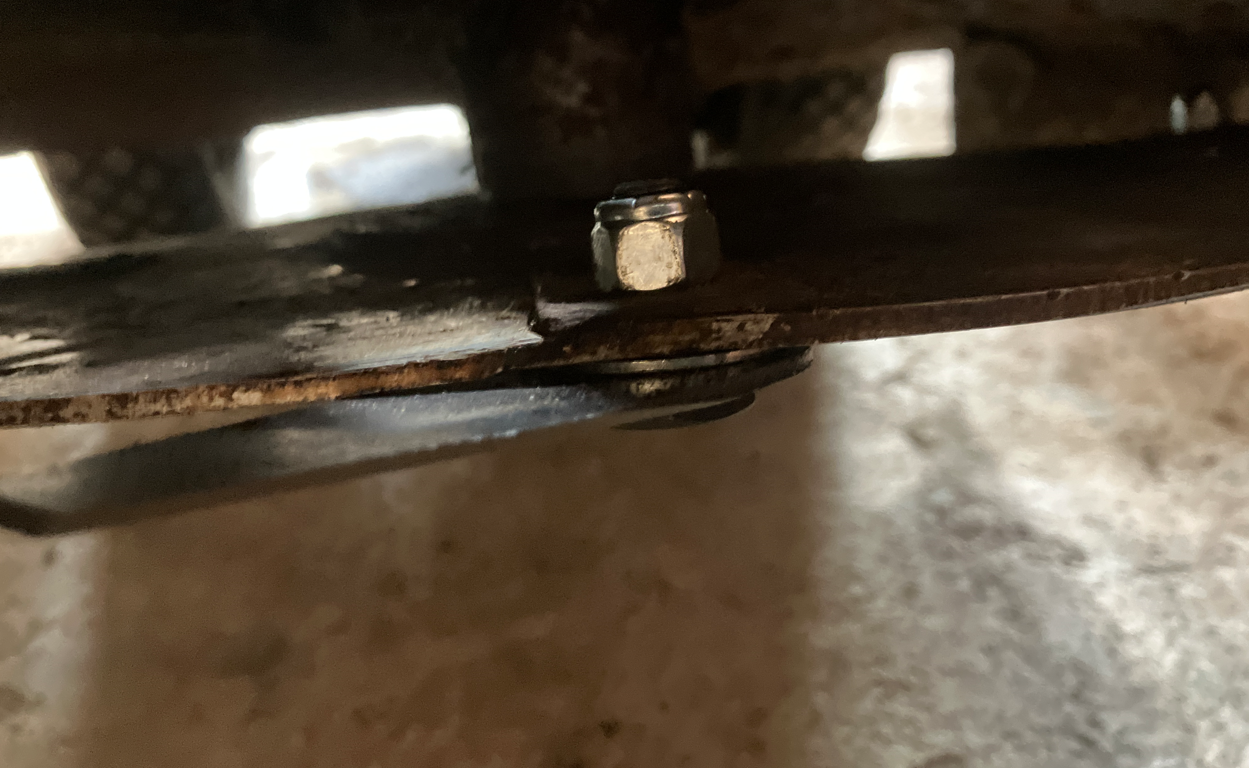

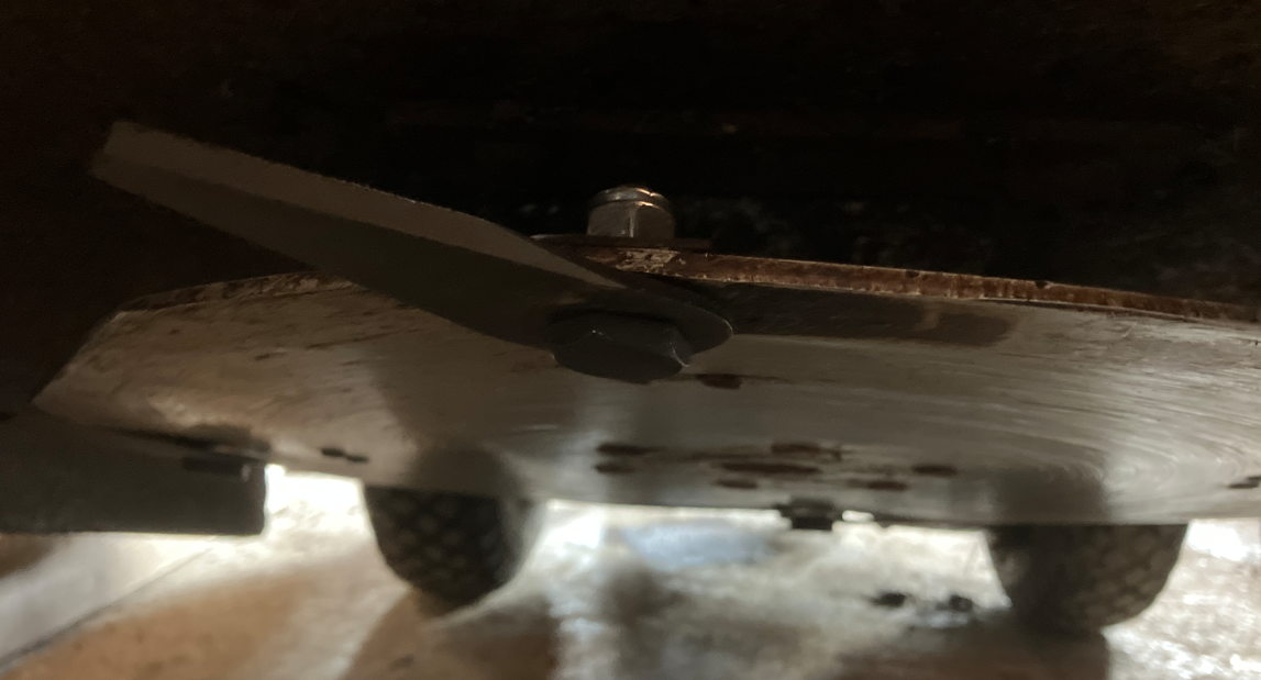

April 13, 2025 at 9:30 am #43614past-timer
ParticipantThanks for your attention. Photos attached. All the blades swing from side to side, but they all foul on the plate because it is not flat, and so will not swing 360′. I wonder if I am overthinking this, and just a bit of deflection is all that is needed.

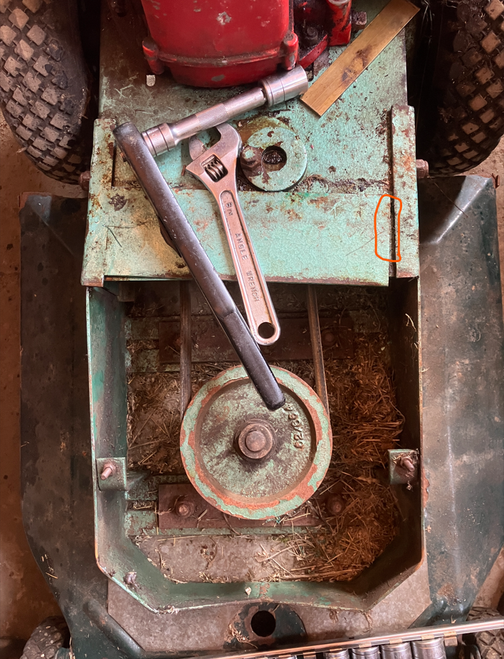

I went to tension the drive belt, and realised I need to weld up one side of the tensioner as at the moment one side is not welded/broken, and therefore the tensioner is twisting the frame. This looks to have been a long time problem that was ignored in the past.
April 13, 2025 at 7:28 pm #43618davidbliss
ParticipantWhen we had one never gave it a thought and fitted the free swinging blades the other way up so like all rotary mowers.

April 14, 2025 at 7:28 am #43620
charlieKeymasterThe blades do not need to swing 360 on their mounting bolts, they only beed to swing in if an obstruction is hit. I suspect the bolts have a shoulder rather than a plain shank, to ensure the blades do swing.
April 15, 2025 at 8:45 am #43622andyfrost
ParticipantIt’s quite a common problem with the 21/Osprey models , having the Duralinium disc , they tended to “bend a small set” where the blades bolt on (see pic 2) , take the carrier off and simply hammer back into shape using a suitable anvil/block, in other words until perfectly flat , the blades should rotate freely through 369 degrees.When these blades were used on the smaller Hayterettes , it was not so much a problem as they used steel discs.
April 15, 2025 at 9:42 pm #43624past-timer
ParticipantThanks for this – I’ll give the plate a fettle at the weekend. I have now welded up the front frame tensioning plate, and I have also found some nos bearings for the front wheels which were in a right state/ missing. The rear height adjusting wing nut and collar are missing, so I’ve bored out a hex nut to slip over the 1/2 adjusting screw stud and intend to drill it for a Clevis pin to hold it in place.
