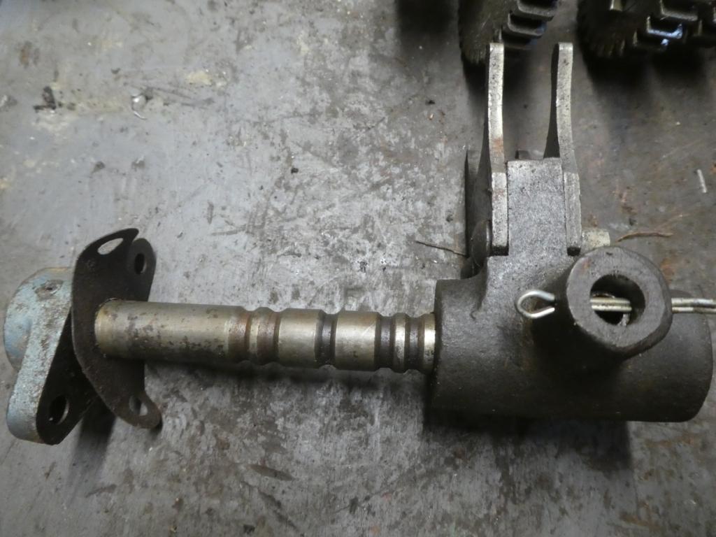

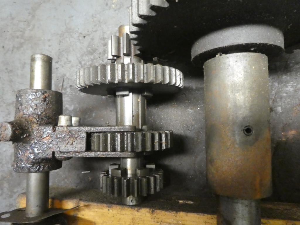

charlieKeymasterJon,
photos of gearbox internals showing gear selector mechanism. I would suspect the gear selector shaft MT569 may be rusted in the gear selector fork MT568. There is a spring and ball in the selector fork which might be rusted too, under the split pin. The only way to access these components is to split the gearbox, if you do this there is a nut and bolt underneath at front that is easy to miss, 9 fixings in total. The two halves will need gently persuading to come apart.June 12, 2020 at 12:55 pm #34705jonturner
ParticipantCharlie, thank you for the photos most informative. The heads up on the hard to find fastening also extremely valuable. I will let you know what I find on stripping down.
