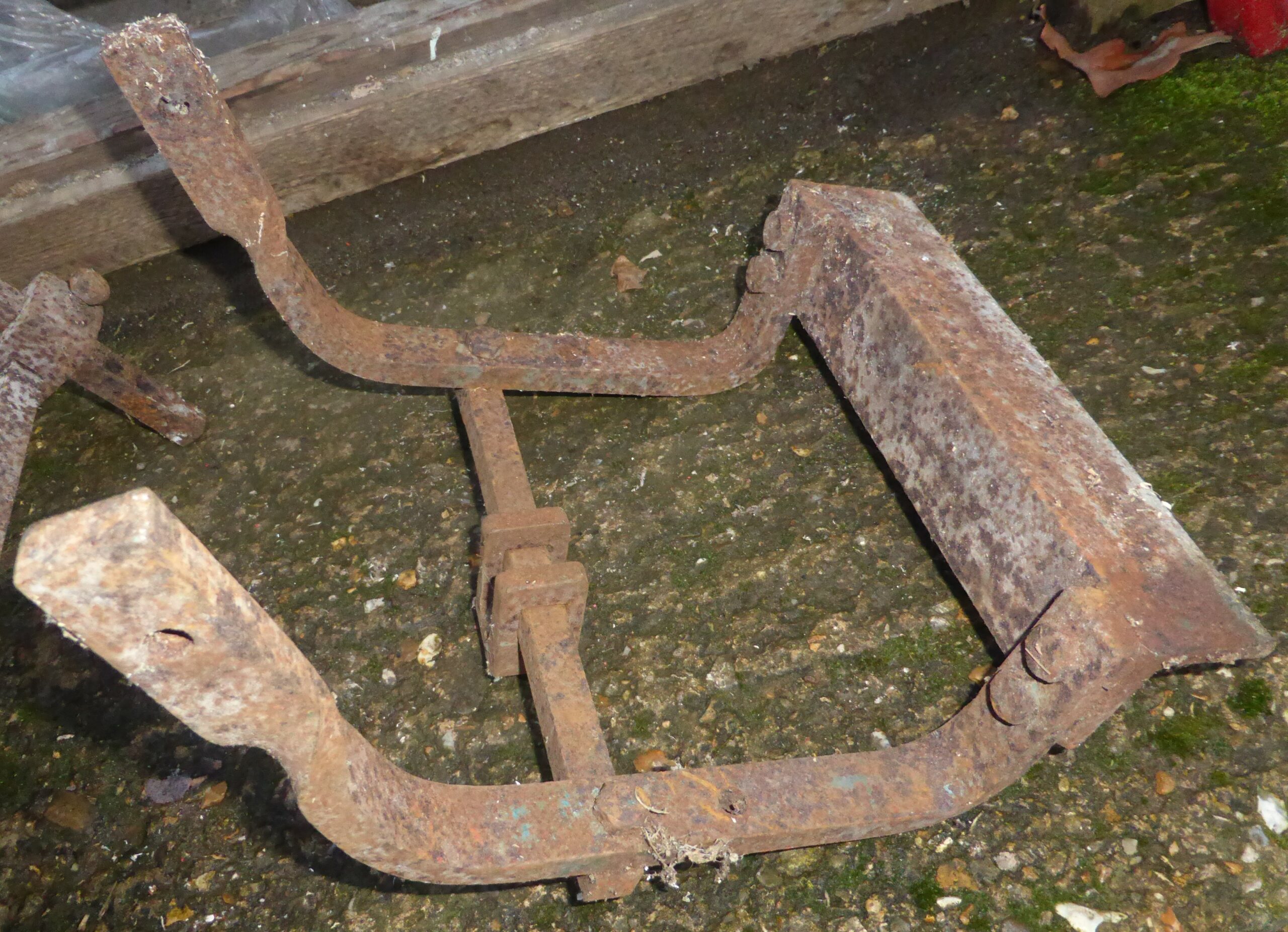

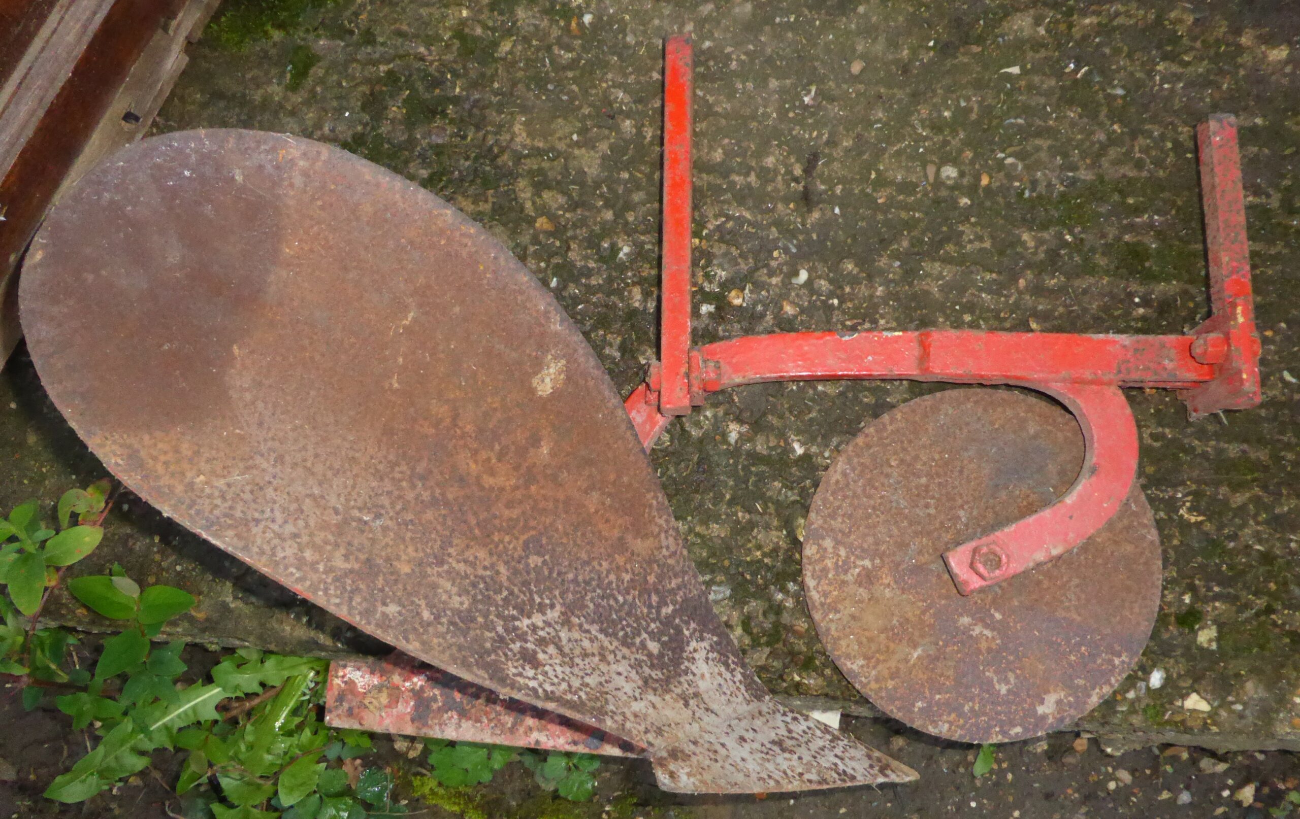

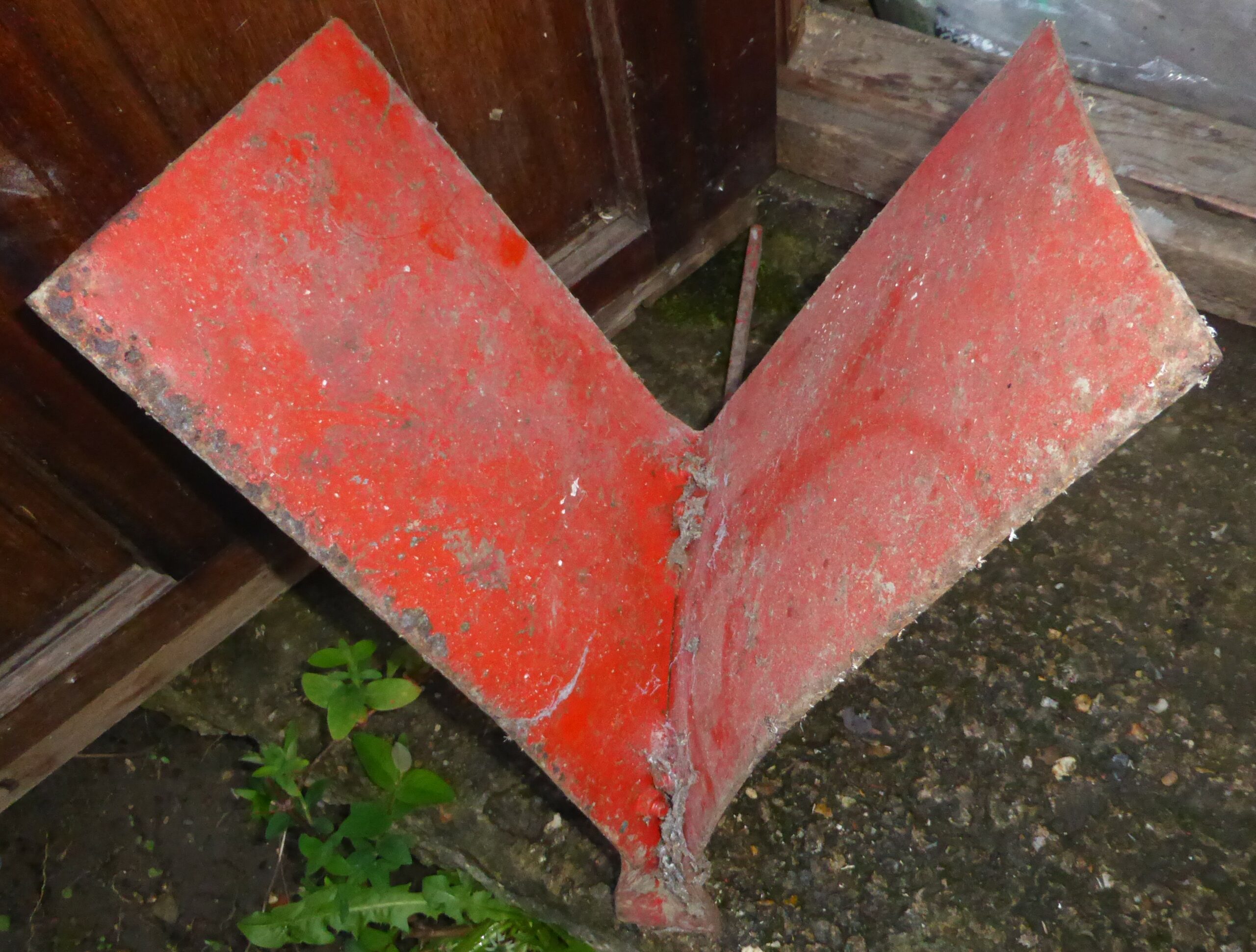

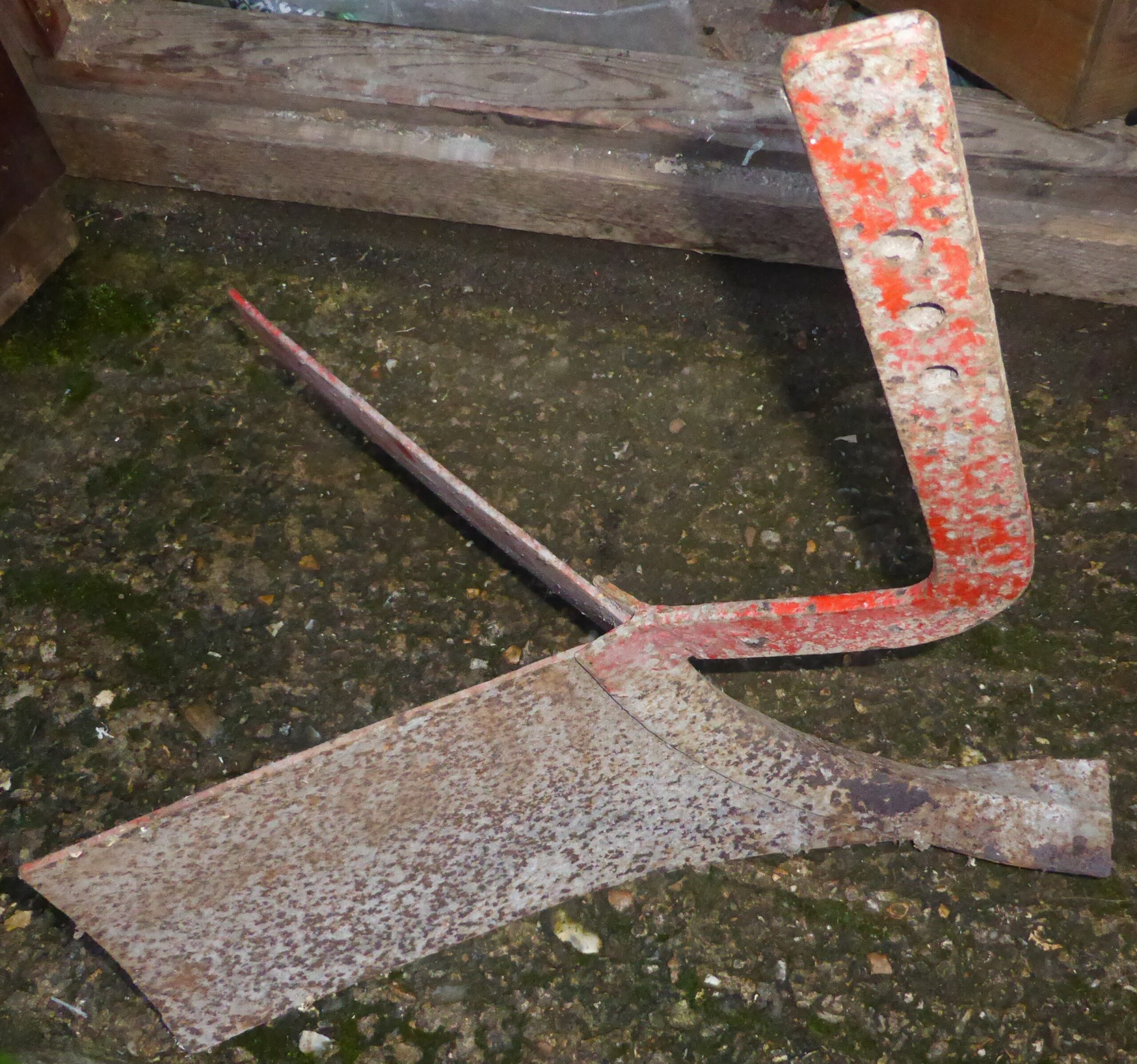

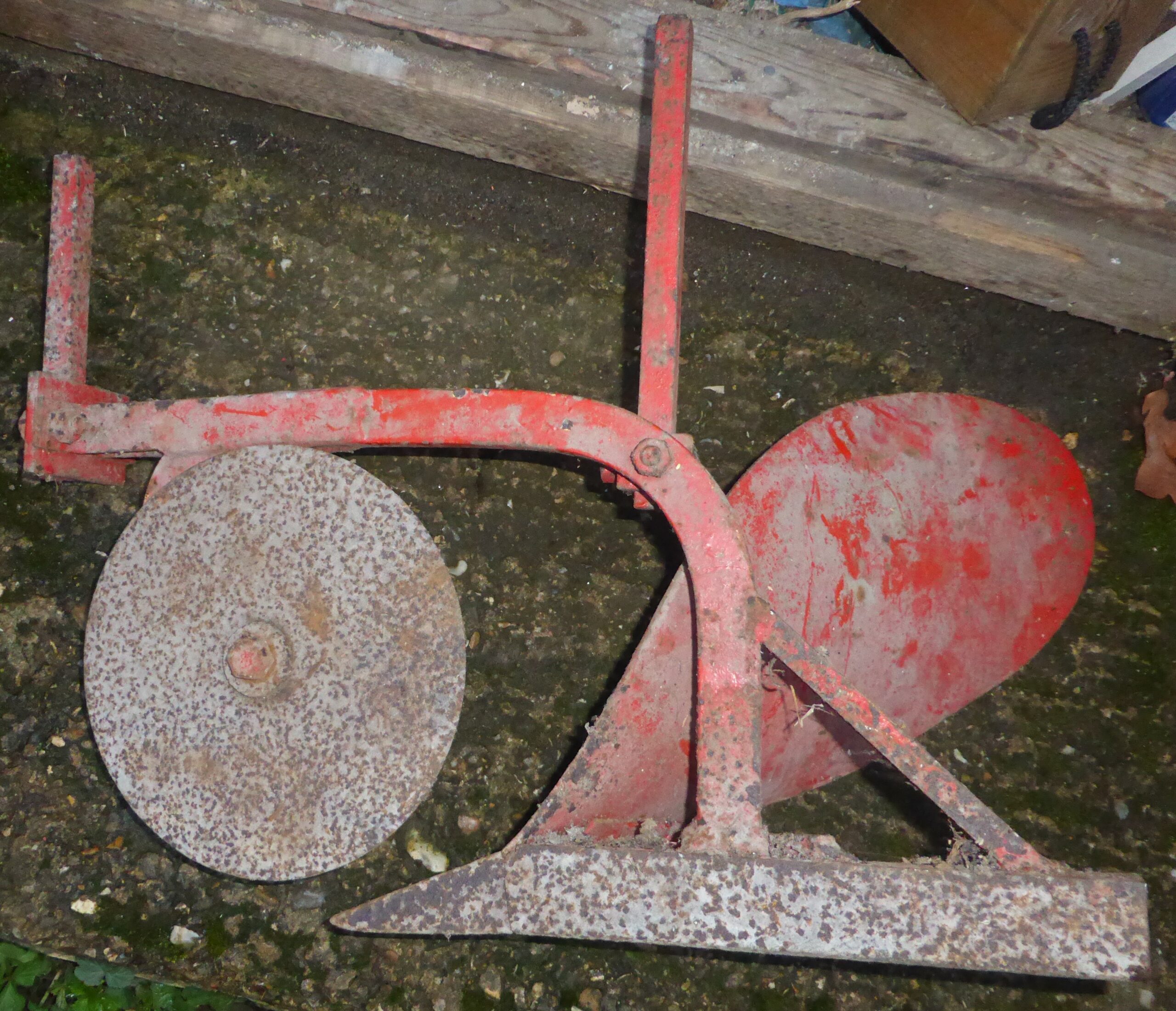

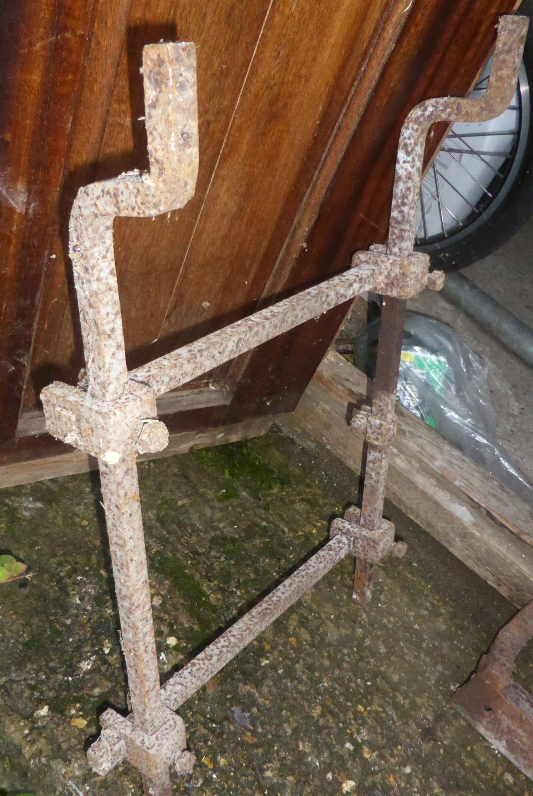

ParticipantWell, I’ve developed an allotment, and rotavated it. Excellent.
Looking at the stuff that came from North Cornwall, there are various attachments. Not at all sure they’re for Howard 350s.
Any ideas what these are?
THere seems to be some sort of ridger, a plough, and a couple of metal frames, quite rusty but very solid, which may have a trace of green paint on them. I suspect these are “old”.
This reply was modified 2 years, 11 months ago by
rjy.
April 7, 2023 at 7:29 am #40697ted20
ParticipantThe ridger looks home made and not Howard 350 none of the others also not Howard 350 in my opinion
April 7, 2023 at 9:34 pm #40699rjy
ParticipantI don’t think they are Howard, either, but I don’t know what they are! I could use a ridger (“furrower”).
April 7, 2023 at 9:35 pm #40700rjy
April 8, 2023 at 10:27 am #40701andyfrost
ParticipantThe tool frame I’m sure is AutoCulto , ridger I would say home made , the plough body is very similar to a Colwood , not sure about the fitting though
