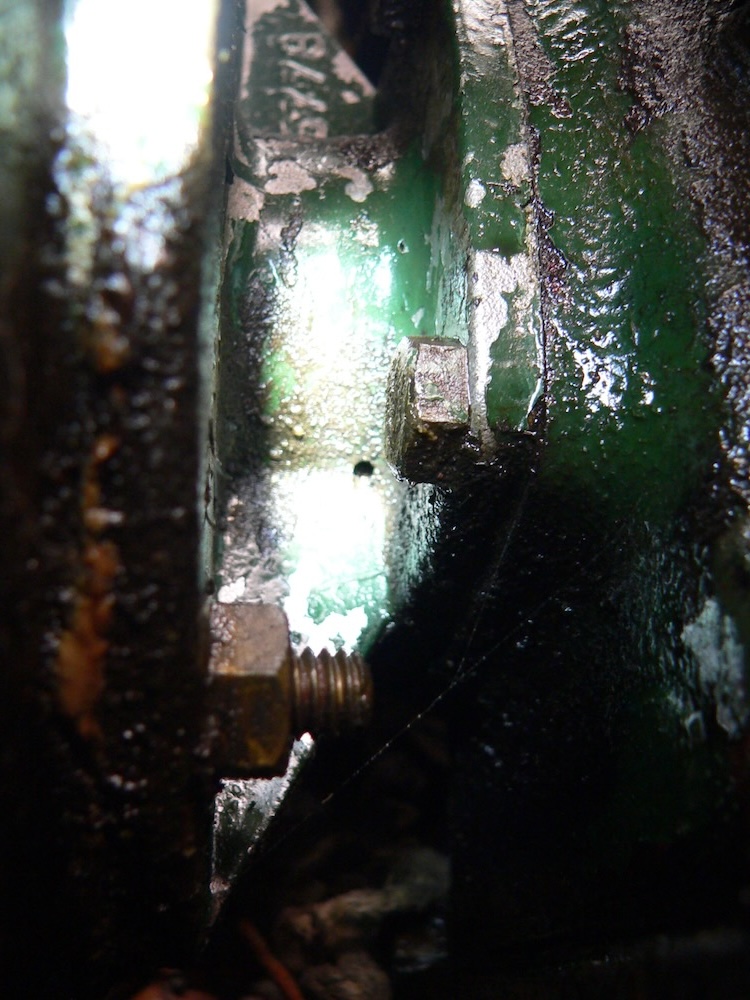

On both pumps there are non-return flap valves just inside the threaded suction hose connection, so not really foot valves but do same thing not on the pipe, and both pumps are sort of the same, the faster priming one has a smaller water re-circling jet and different housing where the ball fits. I did take it into Panks and they said never seen one like it and with difficulty of fitting a modern seal fitted the same type back from the other pump but that soon leaked again and swapped the crankshaft as was a little better and that’s been ok since, did put a drain hole so if it leaked again water wouldn’t be so likely to get into the oil, did the same but larger hole to the other when the left over’s were assembled, there are many differences between those engines as one has several extra bumps and the odd plugged hole for something, different valve chest thats sort of open, with a very heavy grove in the cylinder bore that goes round about a turn nearing bottom of piston stroke and the other is a much better engineered looking thing so what came first. The well used engine is numbered 36812/40 and the other has the Alcon plate 2334/132 so similar stampings, so crude in one part but better made in another. Was told who knows? Being Air Ministry was done for experimental or special job?.June 24, 2025 at 9:30 pm #43845andyfrost

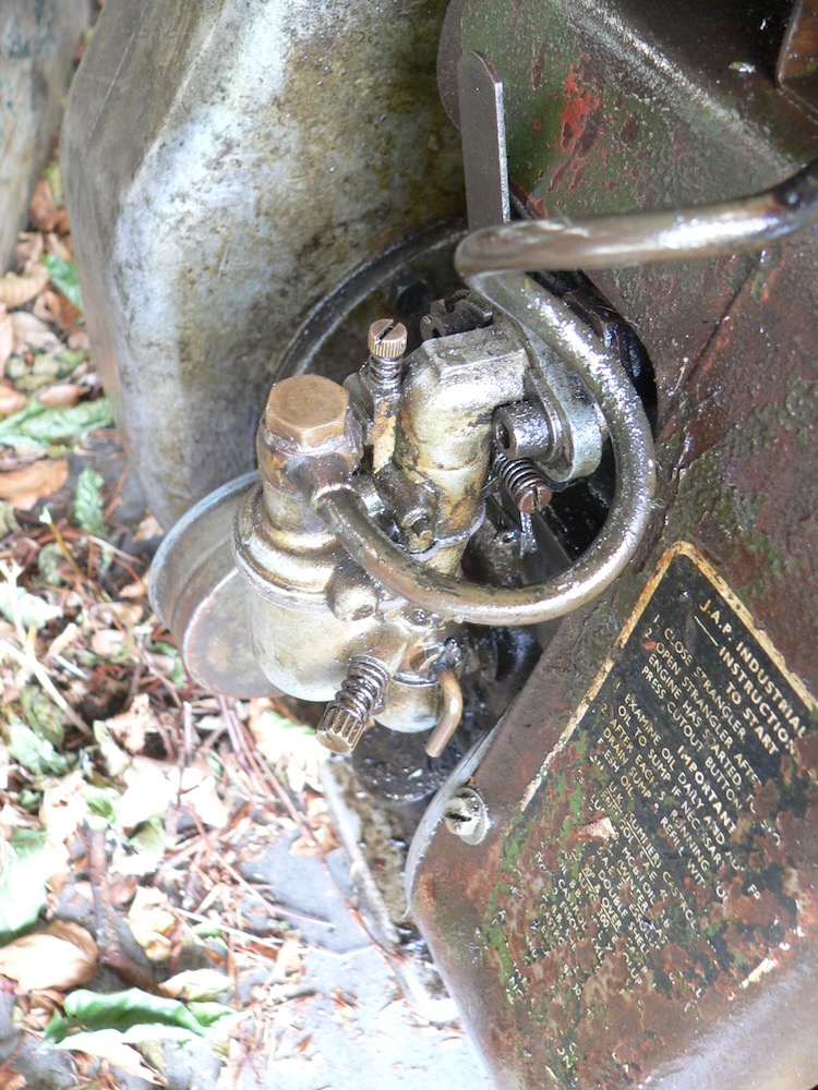

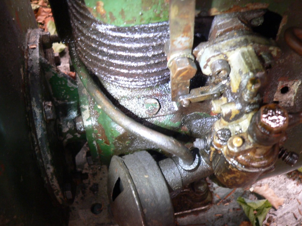

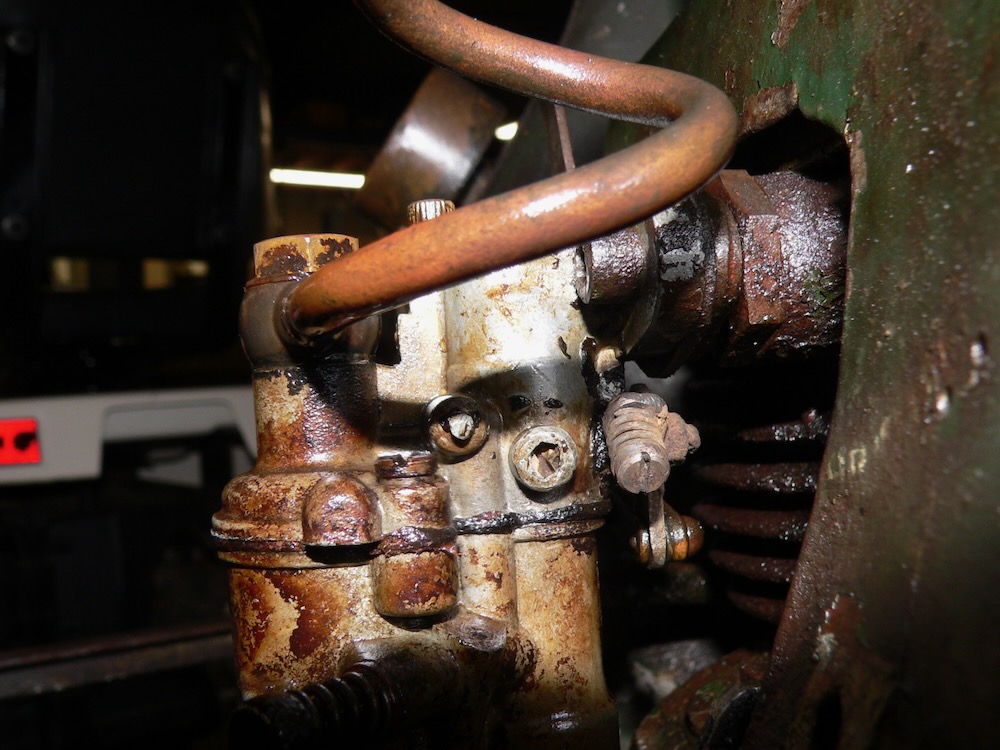

ParticipantDavid , the groove you refer to was an idea/design that JAP toyed with for a short period , it was also used on 4/3 , 5 models , but was quickly dropped. So in it’s original format that engine would have been fitted with a carb with the JAP logo cast into the fuel bowl , it was a very similar looking carb to the Zenith13. Traces of yellow paint on the carb in one of your pics tells us quite clearly that it is a mixture of old/new bits and pieces.

It isn’t yellow paint and for some reason with the LED light ether over exposed bits and changed material colour, its 60 years of crud from evaporated petrol, some places it was on very thick but did blow off a bit. that carb in my infancy I fitted for my father, as originals with the ball floats being dented looking like golf balls often after being left would go back to start it only to find been leaking. Looking back that pump was a real life line as the farms only water supply was the Bore hole that Panks put down in 1942 that regularly was out of action in the driest times so was a great help watering stock from ponds. Original carbs had T 12 and T 13 on with C1266? no JAP script, ordering a new carb I somehow was afraid when asked for butterfly orientation had got it wrong? well if I hadn’t would still have got the blame, luckily that carbs neck was universal moulded and I re-drilled and plugged and he never knew. In those early days my equipment to make anything was gutter bolts, hacksaw, file and Black&Decker drill, that carb number 01433C type 13TCA-2 and the later new correct one I fitted 01392 from just over 20 years ago.June 26, 2025 at 8:15 am #43851andyfrost
ParticipantOK David , but I can assure you the first 2As were fitted with the JAP carb , the Zenith came much later.

Have checked my 2a pump set and there is a hole on the section of casting that goes from the engine to the pump body on the carburettor side next to the bottom casting web. So if any water gets past the seal will drain out and not get into the engine. But I think my pump is a bog standard one, whereas David’s may have been a special order. The Villiers/Alcon has this section of casting spaced off the crankcase and I recall water coming out of it before I replaced the seal. Have thought again about the Villiers/Alcon not achieving what seems to be the recognized reading of a minimum of 20 in-Hg on a vacuum test for single stage water pumps. As it only has a head of 66ft, it may correspondingly have a lower ability to lift. It will be interesting again to test the pump and make some comparisons with others now I have more experience with them. When I last did it 14 years ago I was more interested in getting enough pressure to operate the Hunter system.
