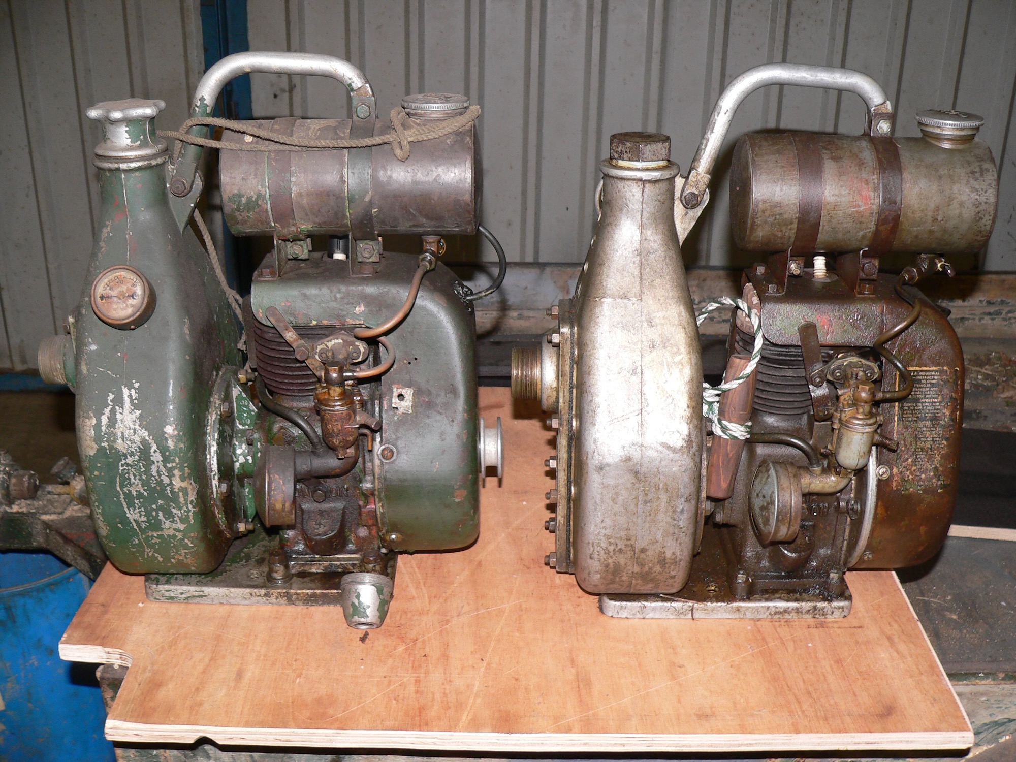

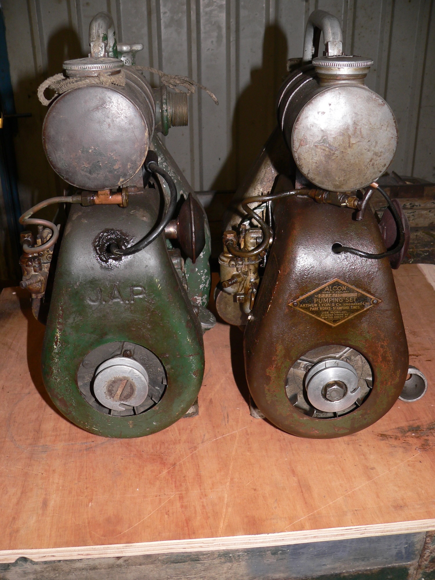

ParticipantThese were bought sometime in the 1950s, ex air ministry. One was seized and was only used for spares. The other one also came crated with a multitude of spare parts, this was used for years and we never realised the differences between to the two pumps.
The one Jap engine has no governors and internally the valves only have the normal single guide, the cam shaft has large gear teeth. It also had screened ignition with what looked like and aircraft plug in. This was difficult to get but this was replaced with a normal plug lead and plug.
The other engine had governors and the valves were supported in two guides, which is unusual. The normal guide at the top and another below the spring. The cam shaft had fine gear teeth.The one without governors revd upto 4000 which way above the 2400 that the manufacturers said. It also fast primed which is probably why.
With me being inquisitive as a young boy. I pulled the spare pump apart, but it then got pushed into an empty bath for 40 some years in bit. In the end for something to do I got it out, reassembled and it actually goes.
Does anyone know what the differences in years are and also why they had these differences.

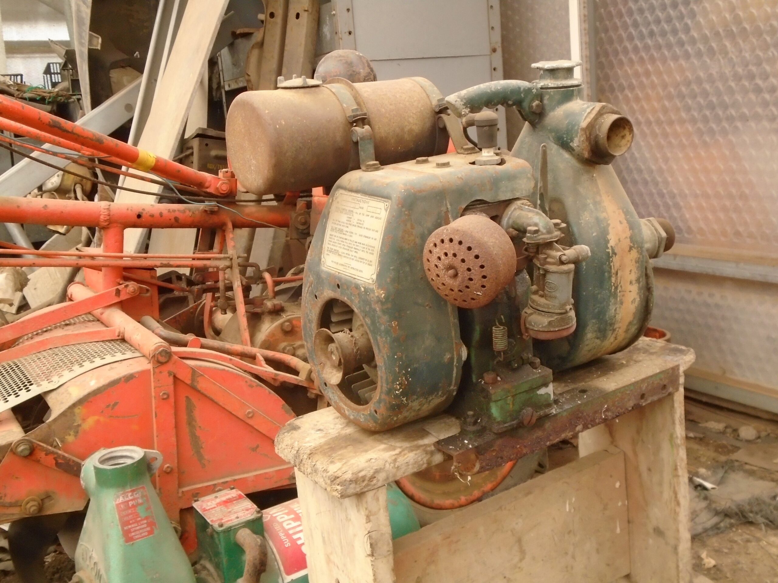

sidevalve5ParticipantAn update the Alcon 1½” pump. Went to an auction on Wednesday, there were two pumps there in one lot. One attached to a JAP 2a, the other to a 3 phase electric motor. The latter had an embossed ali label on it stating the pump had a head of 66’, so around 20m. This compares very poorly to even the cheapest Chinese modern equivalents if it is to be used for an irrigation system with even a medium pressure requirement. Am assuming the pump had a market for lower pressure irrigation systems and simple water transfer use with the smaller horsepower engines that were available.
The auctioneer had to drop the bid to £10 to get going, still no hands up until muggings put his up and won it. It’s worth it in scrap alone because of the heavy electric motor. But the JAP pump set is very tidy, as is the electric set up. The JAP set is painted lime green and was wondering if anyone has seen this colour before. Am not sure if it’s factory applied paint by Alcon, or someone has done it when it had a reconditioning. Both the Villiers engine pump and the electric one has the usual dark green paint that I have seen on other Alcon pumps. Whatever, it looks very clean, but without any compression. A stuck valve is suspected. Will have a play when I have some spare time and see if I can get it going.

ParticipantGrshame, daughter has done a video of the two Alcons today it might be a time before i see how it came out, I can tell how long the one pump was in work to as stamped date in 2002 as that was when I resurrected the donor parts pump back into working order and used that, So stood twenty two years. Bit disappointed as had to give it two pulls before it fired up, flat out that you say they can’t run long like that and that now frightens me a bit but been doing that for now 70? years and still hanging in there. I then started the other engine and they take 5-10 minutes to prime so both had ben making some bit of noise and noticed I hadn’t dropped the old faithfuls hose into the water, so no wonder it was a bit more noisy, dumped the hose into the pond and it only took seconds it seemed and was primed so that is quick, but once up and running there’s no difference, think running just under 20 psi and doubled up more or less double the pressure. Just as I had nearly cleared up the friend that had put his rev counter on that old engine 50 years ago came over and he remembered the 4000 rpm. Both engines differ with the well used engine having a serial number ending in 40? date, and other has nothing, both were in the AM green the resurrected one still is what paint still there. just recently was give a few Jap bits and looks like was from a generator going by the head, tin cowl good no dents and sump, and if you find the loss of compression isn’t just a stuck valve and was a cam-follower I have a spare so all free to anyone.

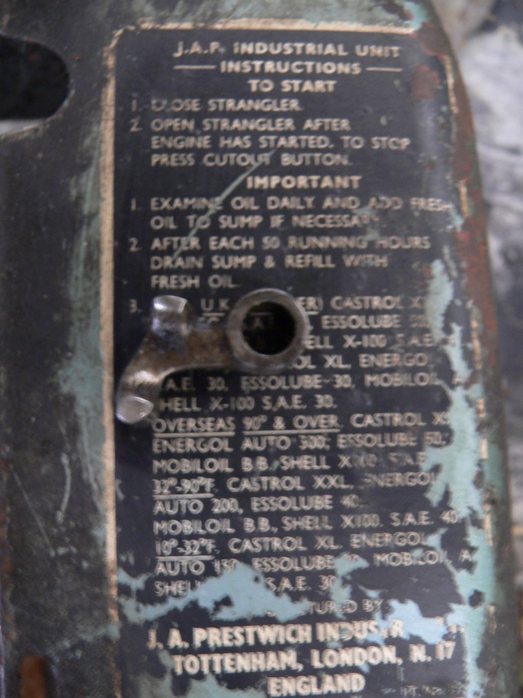

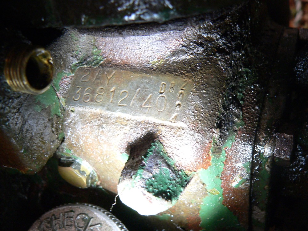

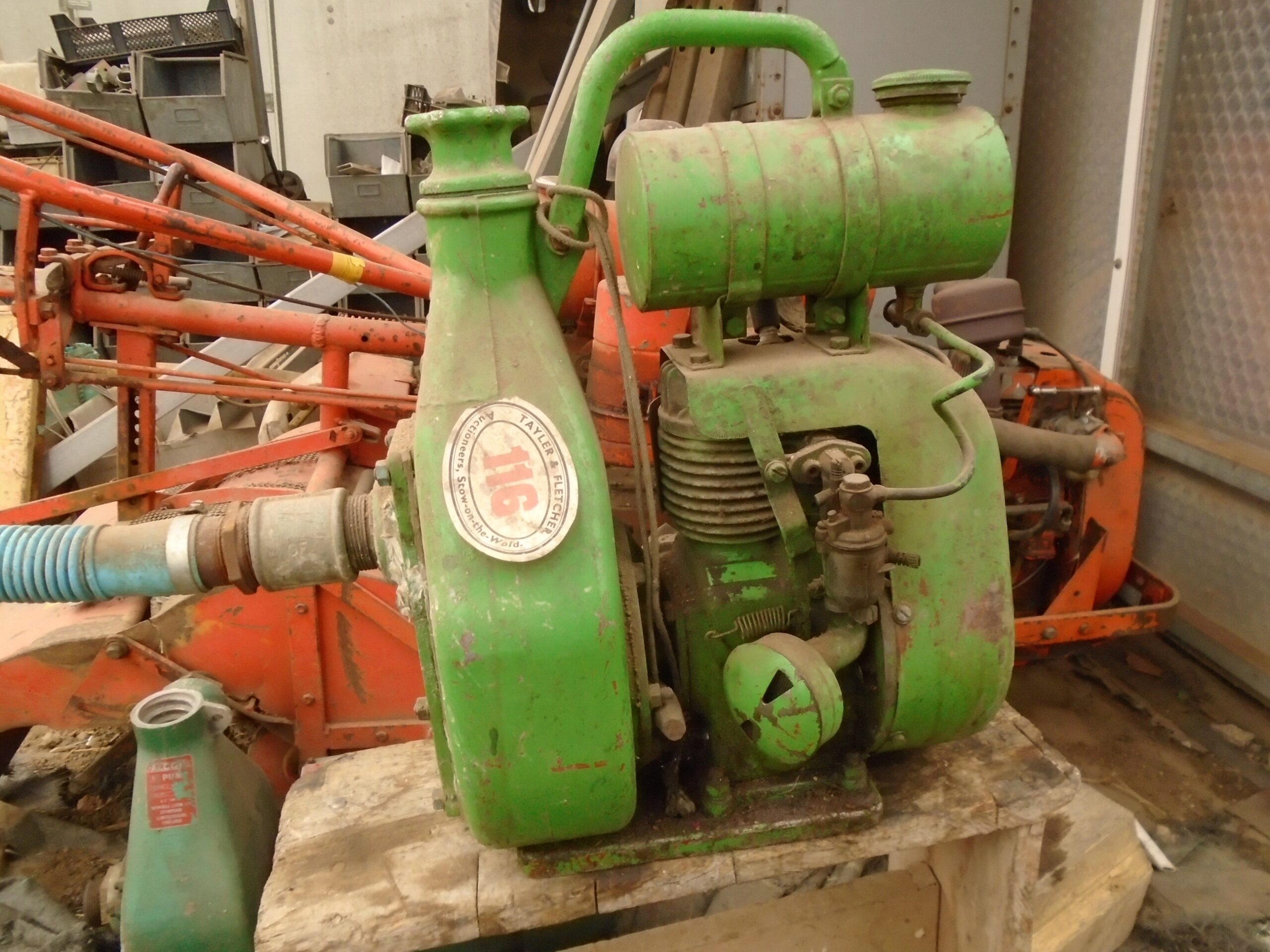

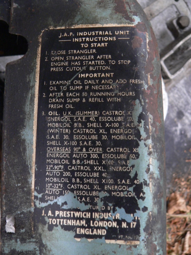

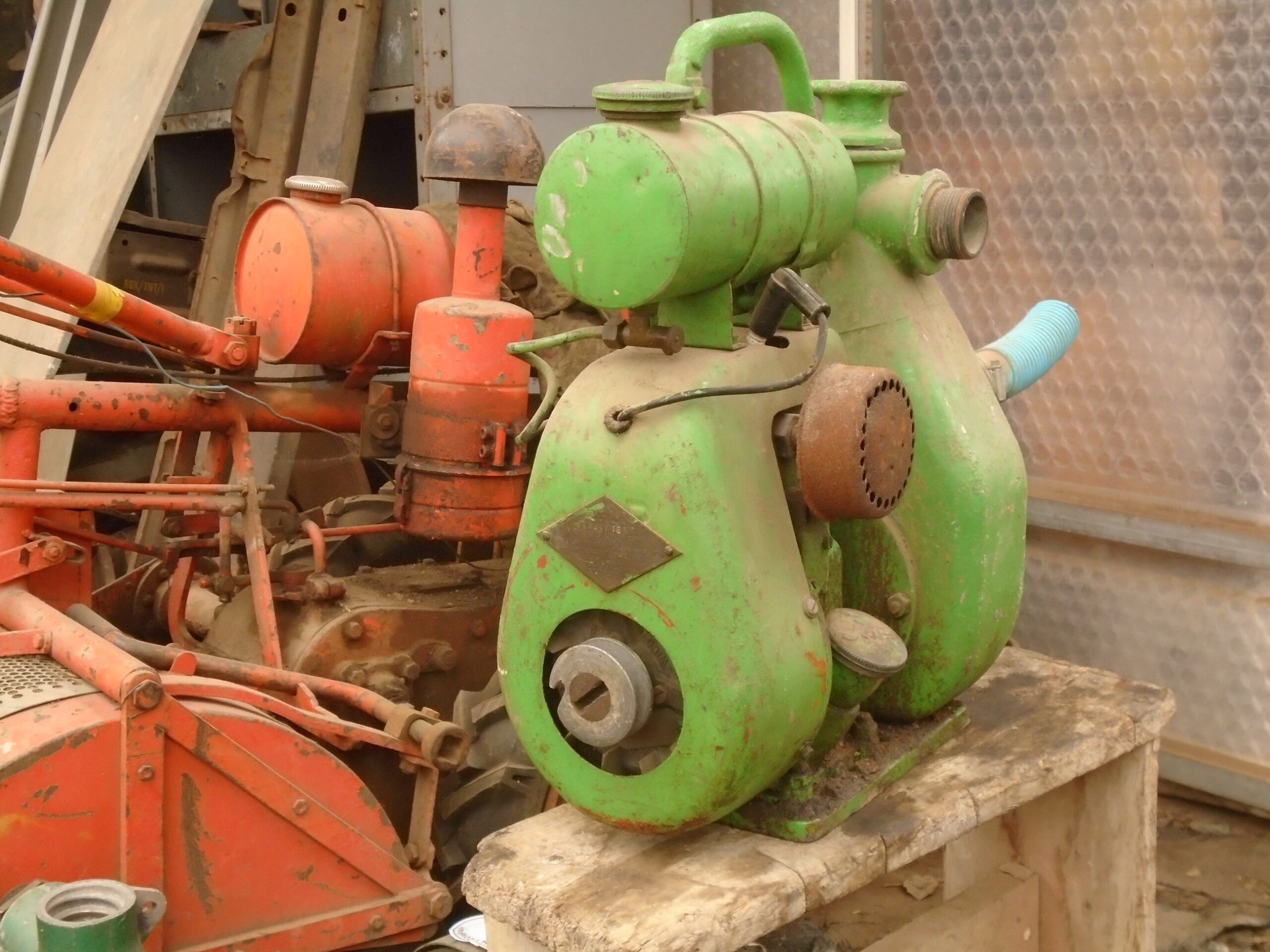

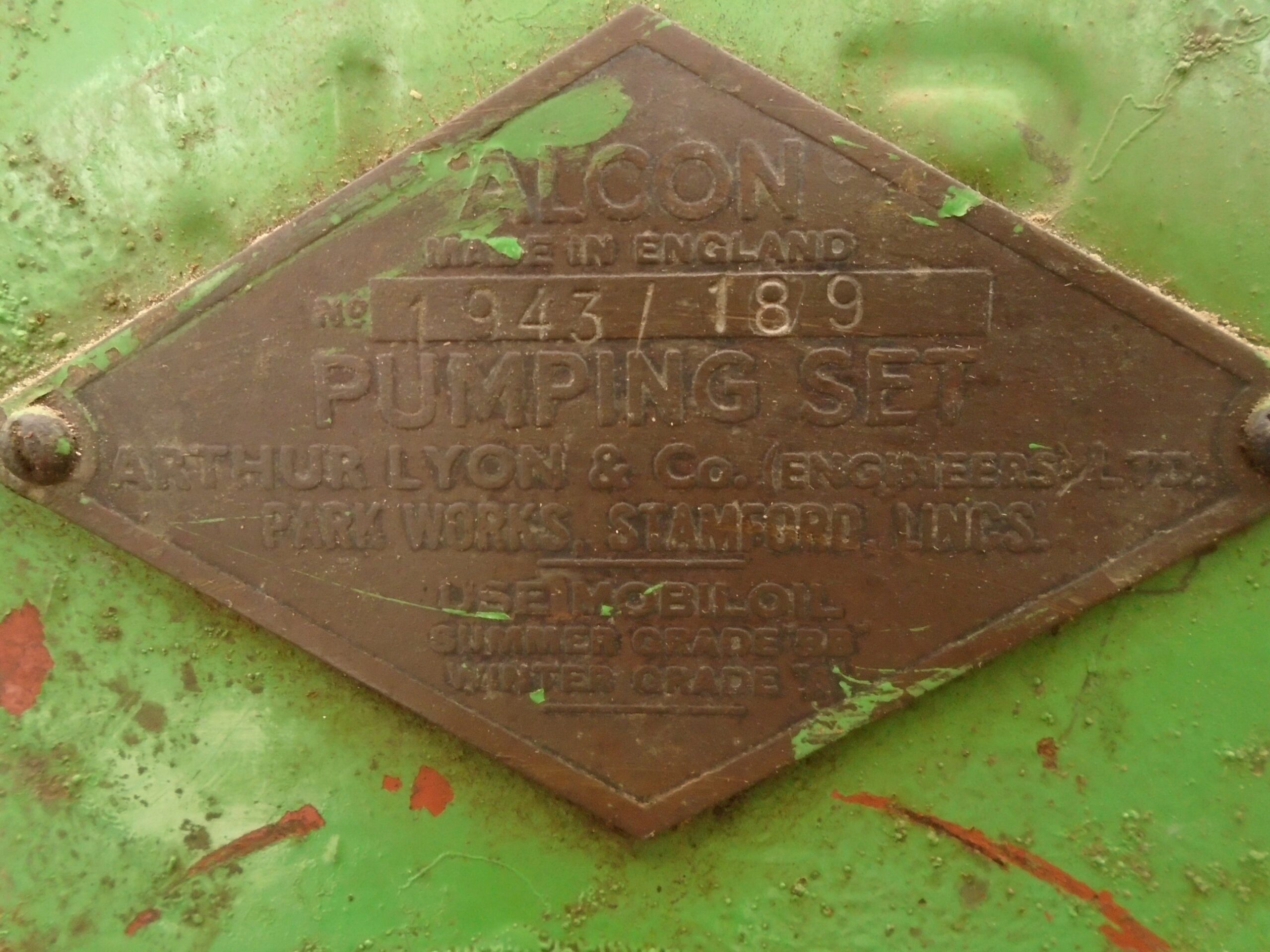

Took a couple of pictures of the one I got at the auction. Also my old original Villiers pump to add context. The JAP pump has a nameplate on the cowling with the first number being 1943. Do not know if that is the date it was put together, or if it is a coincidence. Also do not know if Alcon purchased the engines unpainted, then painted them all over in one colour. Or if it was reconditioned at some point and it was then it received the lime green finish. Be good it anyone could shed more light on this. The most important thing though is to get it working again and from the time it was painted, do not think it’s done much work. The oil is clean and the lot number shown is from a different auction. So it was likely purchased then, either the just stored, or the new owner could not get it to go until the farm clearance sale when I got it.

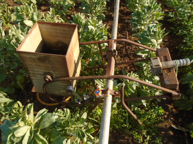

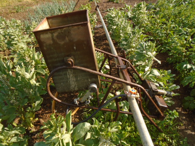

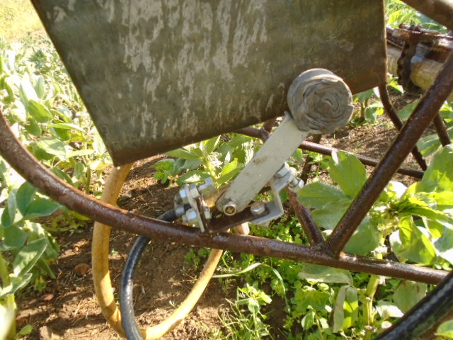

Did some watering yesterday evening and took some (not very good) pictures of the Evenproducts Oscillating Sprayline. In the Vale of Evesham when I was growing up most market gardeners had this setup. You do not see them now as traditional market gardening has died out. The oscillating system is really simple, with the tank filling from a nozzle and as it gets heaver it moves downwards against the effect of the counter-weight, twisting the sprayline (anti-clockwise in the photo). When the tank is near the ground the pendulum swings (to the left in the photo), the water from the nozzle is stopped by the 3 port valve and the water in the tank slowly drains out through the valve, the falling counter-weight twisting the sprayline in the opposite direction (clockwise in the photo). When to tank is nearly empty and raised up, the pendulum moves again, the tank starts to fill and the cycle starts over again. You can adjust flow rates and the pendulum stops for oscillation speed and irrigated width. The downsides are they are more labour intensive to move around, the irrigated area is small and precipitation rates low. None of this is a bother to me though, because it has upsides too. It is quiet, the application more even than sprinkers and they are better suited to pumping from a well with a limited volume.
