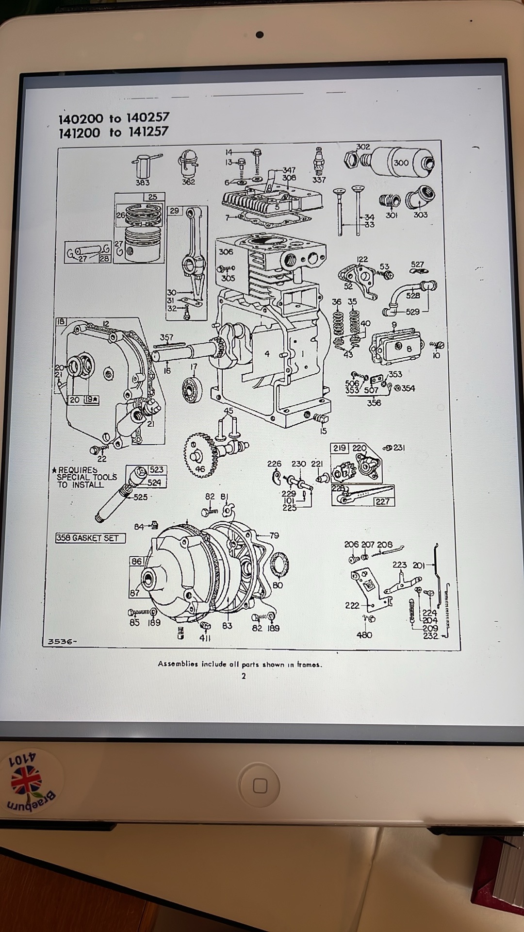

ParticipantHi l have a Briggs side valve aluminium block engine on a Howard 300 rotavator
The block is scored , l do have a genuine Briggs replacement oversize piston and rings
Does anyone know of anybody who rebores aluminium block such as this
I would like to keep Howard original rather than fit another engine and crank size is smaller on many newer engines
