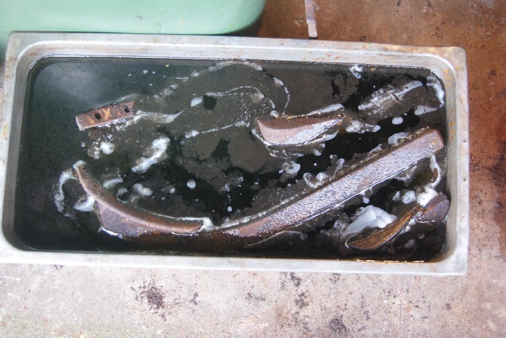

Most of the smaller parts I am now soaking in Brick and Mortar Cleaner from Jewsons. This is a dilute Sulphuric Acid which lifts the rust out of the steel but it must be done in a well ventilated area because it gives off toxic fumes (Hydrogen Sulphide). By the time Mrs. Geoff starts complaining about the smell- after a few days- they are normally ready for a soak in water and bicarbonate of soda to neutralise the acid. My biggest problem with this method is the size of the tub that I use and the cost of the acid; if I have to de-rust large parts I don’t have a tub big enough and the cost of filling it with acid would be prohibitive. I may experiment with the electrolysis method, but then again I’m going to have to buy a bigger tub, find somewhere to put it then find a convenient point to plug the battery charger into the mains.

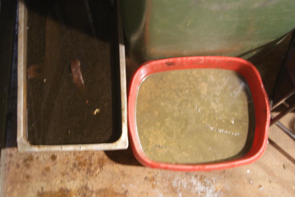

trusty220KeymasterA few people have asked about my method for cleaning rust off using the dilute acid. Here are some pictures to show the results during the process; you can see the rust floating on the top of the acid bath (the stainless steel tub) in the one picture and even more rust in suspension in the Bicarbonate bath (the red washing up bowl- don’t tell Mrs. Geoff!).
Because the acid has been used quite a few times now I’ll leave the parts in there soaking for about a week; new acid should only need a day or two at the most, but it loses it’s potency after a few times. When I soaked the parts of the Trusty Sawbench they buffed up silver like new steel, not old and brown like you would expect old steel to look like.
I’ve now moved the clamps to the bicarbonate solution to neutralise the acid, so in a few days I will start to refurbish them. The aim is to make all of them identical with matching threads so I will have to reduce the holes in some of them- it could be interesting!

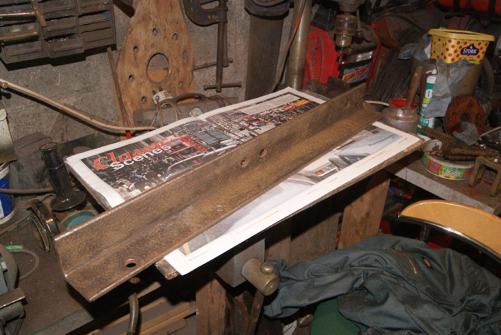

trusty220KeymasterRain again today, so I thought I’d have a go at some of the larger pieces that won’t fit in the tank. No problems encountered and I used a small angle grinder with a wire wheel attachment which really made the rust fly! At one point the neighbour rushed in thinking the place was on fire because there were literally clouds of dust blowing out of the garage door and they thought it was smoke!
One nice surprise was that the cleaning process uncovered stamps in the metal; on closer inspection they both proudly read “British Steel” framed within a stepped outer surround. A nice find, I wonder if we will ever get those businesses back in the future? Somehow “Tata Steel” doesn’t have the same ring to it, does it? I will try to make these stamps more visible when the restoration is finished as they do add something to the whole job.
I took the opportunity to fish around in the bicarbonate tub and found a clamp that had been rusted solid with a bolt stuck in it. The bolt came out with no trouble at all so I continued with the wire wheel and it came up bright metal. You can see the difference by comparing the two pieces- the clamp is silvery whereas the angle iron is still a brown-ish colour with rust still colouring the steel. Once it’s painted and sealed from the atmosphere it should be fine, so that’s what I’ll do with the larger pieces.

Anyway, here are the results of the acid versus non-acid de-rusting techniques.

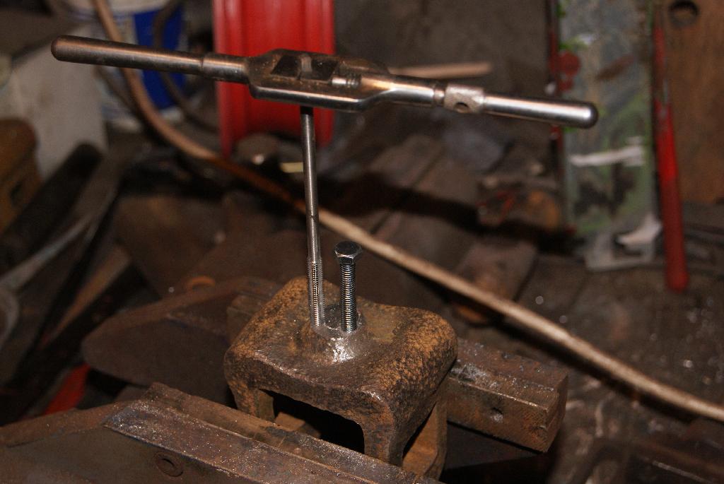

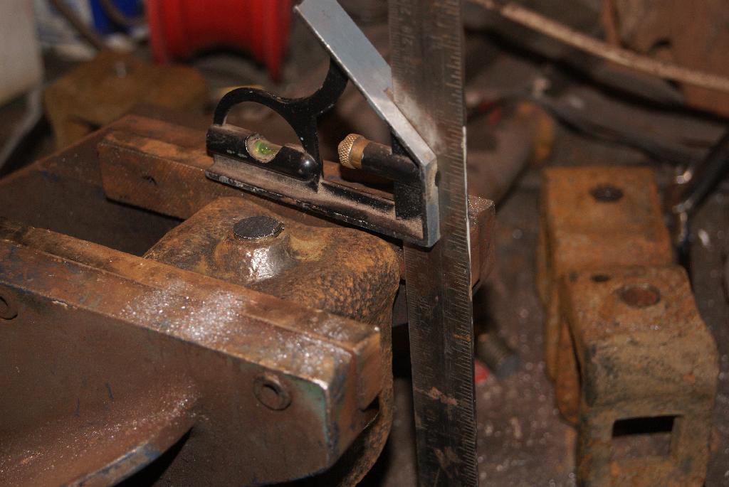

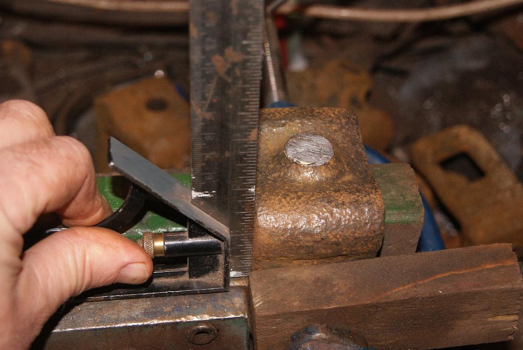

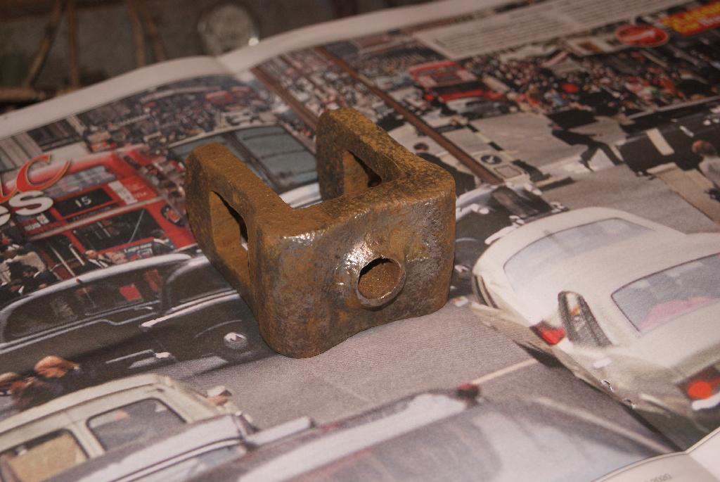

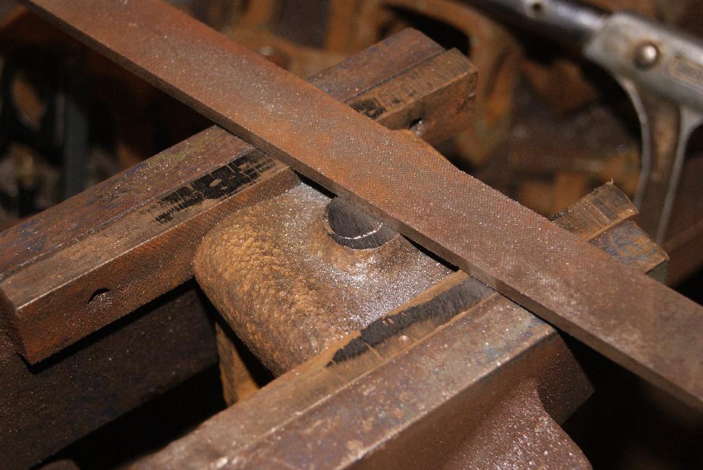

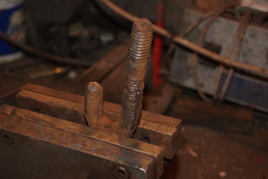

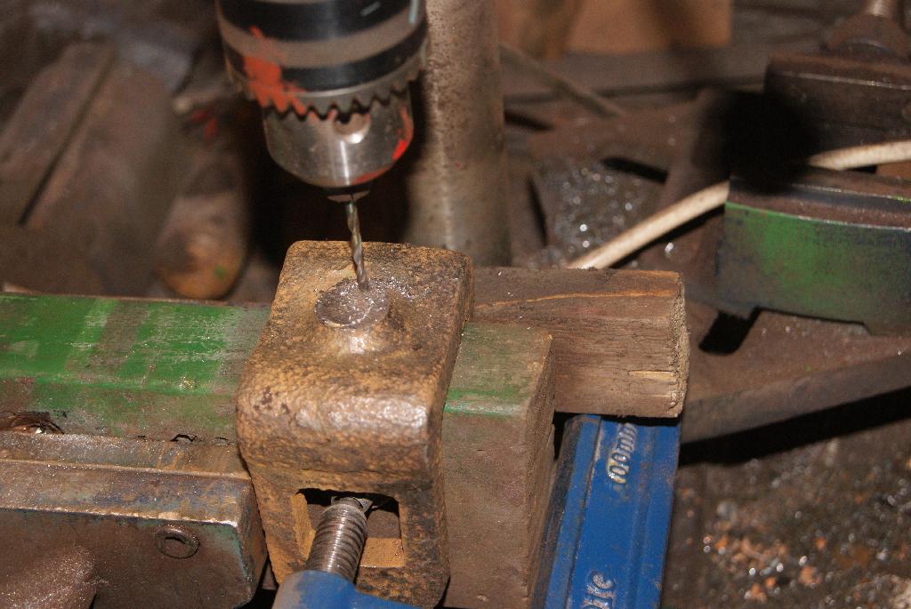

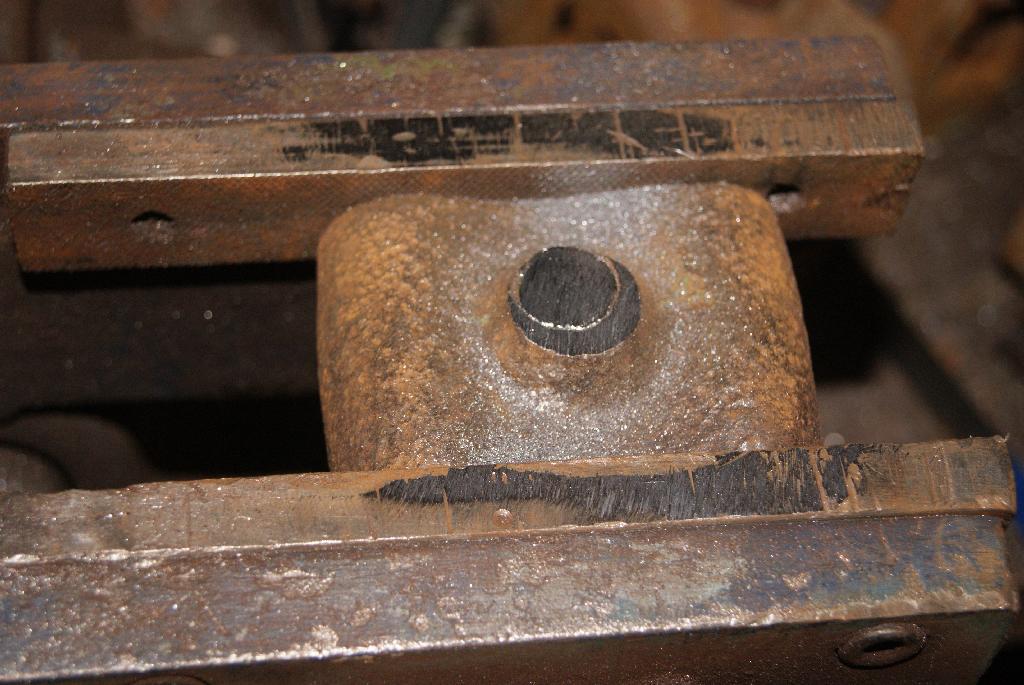

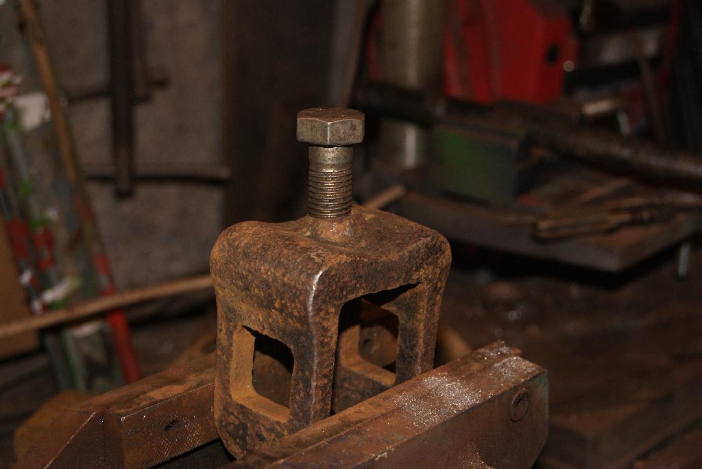

trusty220KeymasterI plucked up courage today to attempt the repair of one of the tine clamps on the cultivator. If you remember the clamps are cast iron, and so very brittle, and somebody had “repaired” most of them by drilling out the bolt hole and re-tapping in a larger size. OK, a working repair that probably got the owner over the immediate problem, but why drill the hole off-centre and at an angle? I’m not OCD (or I don’t think I am) but things like that just can’t go unaltered- besides, the way it had been left would have been difficult to use with every clamp needing a different spanner size.
Normally I would just fill the hole with weld, trim it all back and drill and tap but you can’t do that with cast iron, at least not with any success. I had to do it the long way round which involved plugging the hole with a mild steel bolt, drilling two dowel holes down the threads and tapping them to accept small bolts which will prevent the larger insert from rotating when I drill and tap it later. The pictures explain it better, but the large insert was a 5/8 Whitworth bolt that I cut off and dressed back with a hand file to give a flat surface on the original boss. To prevent it rotating I clamped it in the vice and positioned the pillar drill to drop a hole straight down the edge of the larger bolt. I tapped these holes to M6 and wound in a couple of metric bolts covered with loc-tite so the hole thing is now rigid.
My local bolt supplier is closed under the lockdown rules so I can’t see if he’s got any 1/2″ Whitworth bolts, otherwise I would have drilled and tapped it as well. I’ll leave that until I know what size bolt I can lay my hands on just in case.
Only another six clamps to go- wish me luck!
