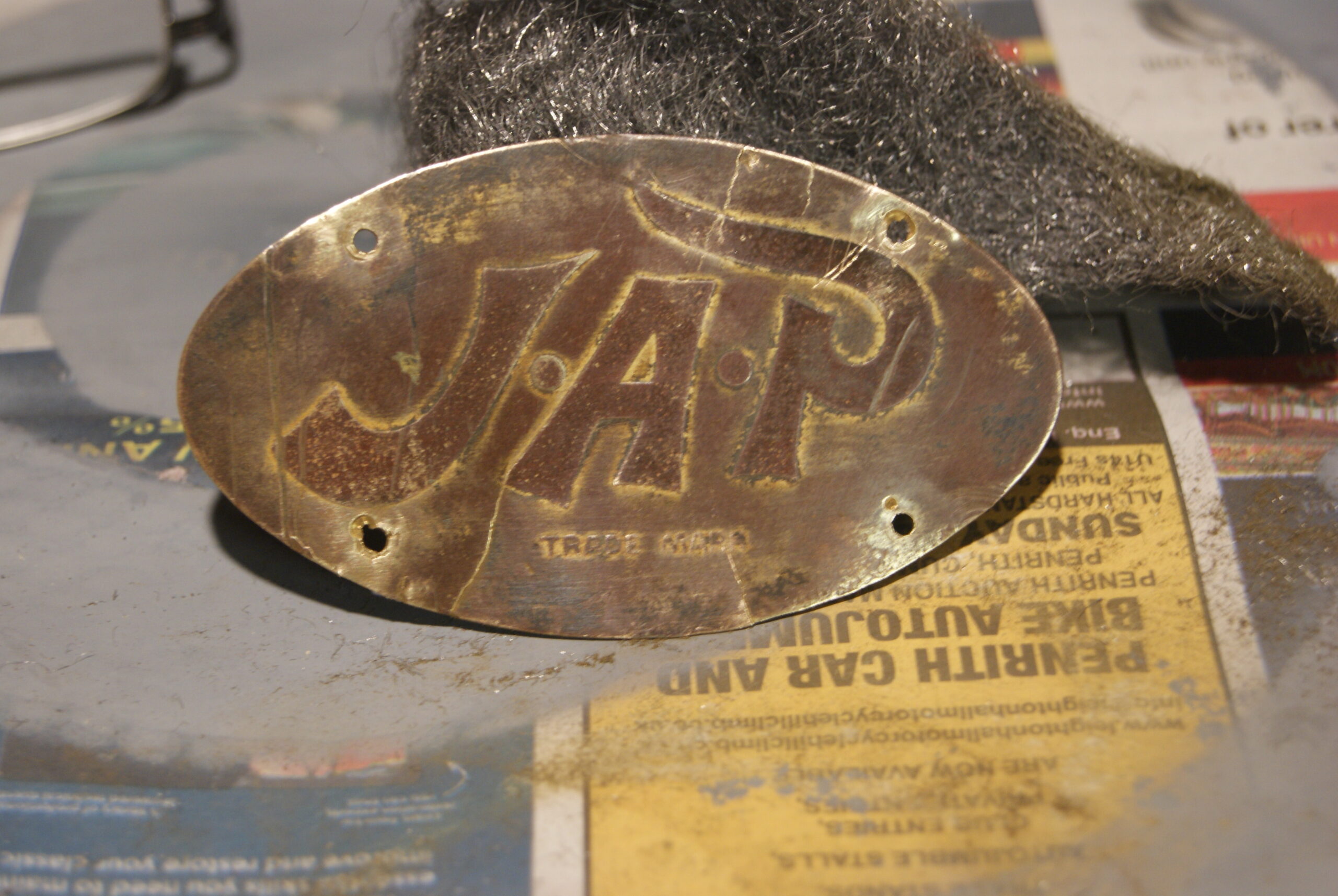

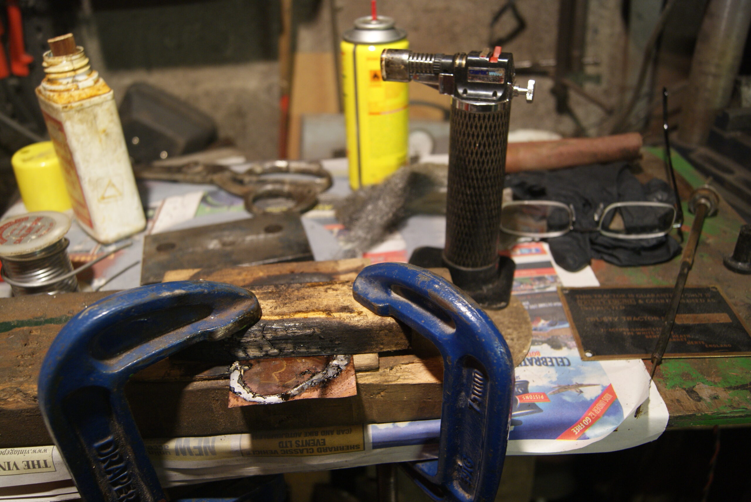

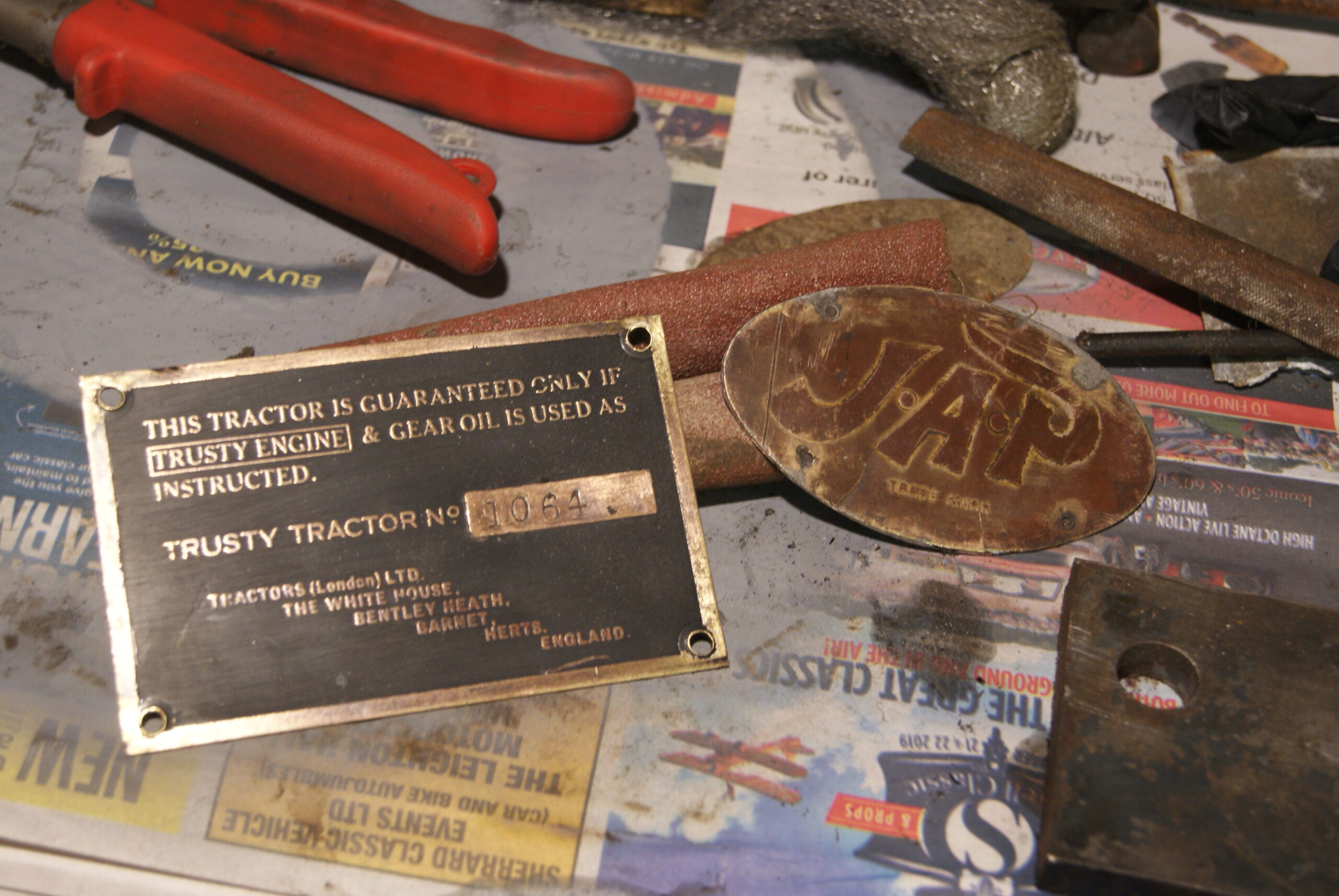

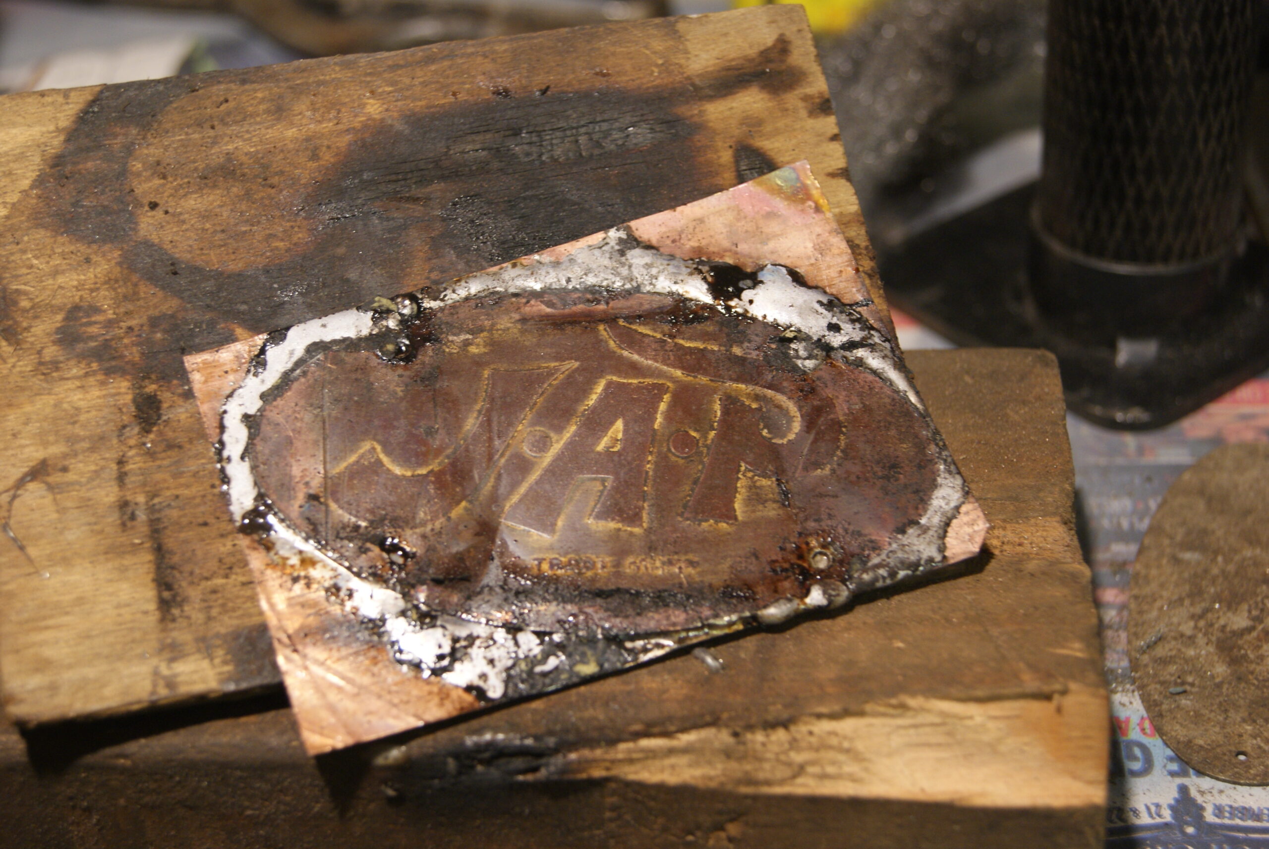

trusty220KeymasterNow I’m really stating to get into the swing of this rebuild! As a challenge I thought that I’d tackle the badge on the cowling just above the flywheel- the early JAP 5’s had an oval brass plate rivetted to the cowling instead of having JAP embossed into the steel like the later ones had.
As with all older machinery they have survived much longer and been through a lot more wear than some of the younger ones and so there is usually more to repair. This is no exception. The oval brass plate was still in one piece but only just- it had cracks all over it and the rust behind it had pushed it into all sorts of stretched shapes around the rivets; still, it hadn’t been forced with a screwdriver in an attempt to steal it, so I thought it worthwhile to try to repair it.
First off was to re-heat it using a little butane blow torch that I have. This will anneal it and make it more pliable, otherwise the cracks will spread once you try to work the material. I flattened it out as best as I dared on a flat anvil using a small hammer, then turned it over and spread solder thinly and evenly over the back of it using the blow torch again to get a larger area warm. The knack is quite easy once you’ve tried it a few times and you can get the solder to flow to the warmer areas using the flame of the blow torch; if the solder is too thick in places all you have to do is warm it up again and it will spread out.
Now, here comes the clever bit- I turned it over again and pressed the soldered side against a thin sheet of copper. A flat block of wood underneath and another, narrower one clamped across the top with G-clamps made sure that there was plenty of pressure pushing the two together, then I heated the sides of the brass plate that were still exposed (that’s why I used a narrower block of wood on top, so I could still get to heat the brass and melt the solder whilst the pressure was till on).
If you’ve done it right you should see little beads of solder squeezed out of the join between the plates but if your plate is still a little wavy like mine was you will need to re-position the blocks a few times to make sure that you can get to heat all of the brass plate. Patience is the key and I found that every time I re-positioned them the two plates came that little bit closer together until the whole assembly was flat.
All you have to do then is clean it up with a file and it’s as good as new- well better, really, because it’s original!

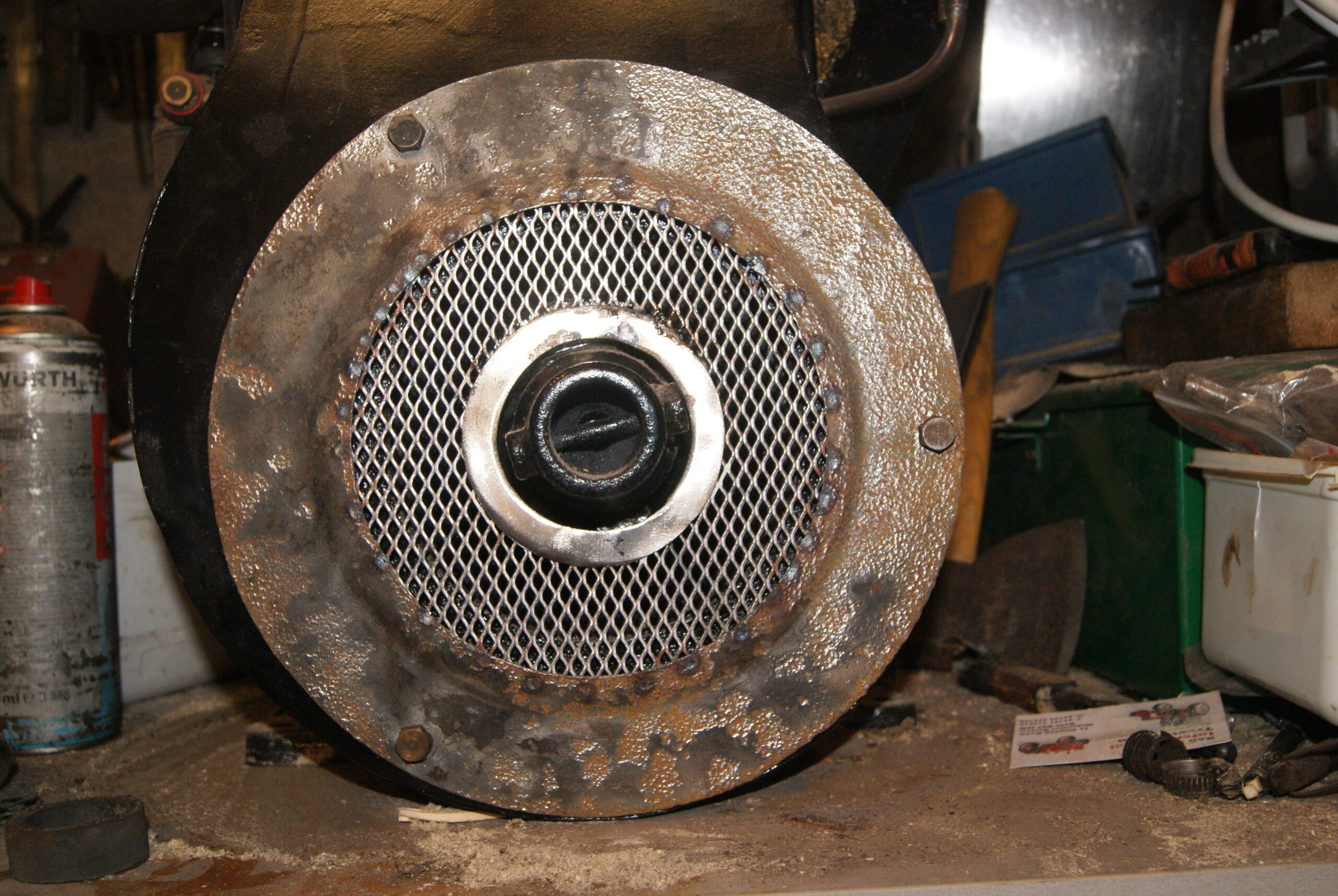

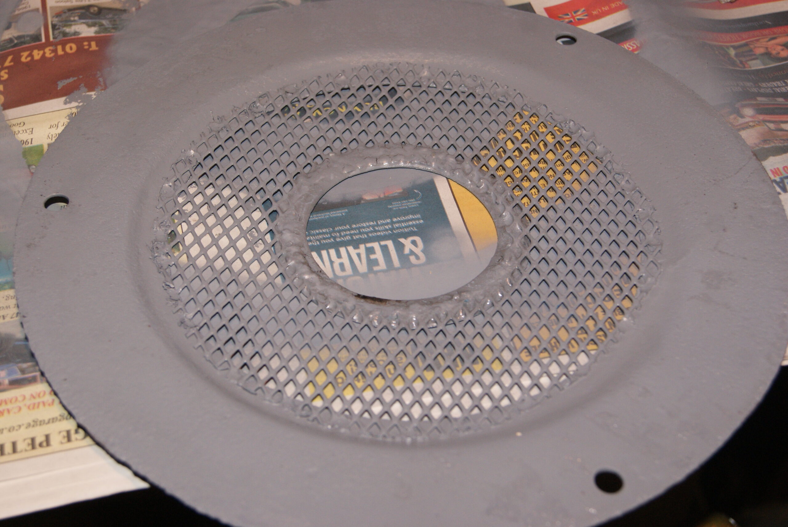

trusty220KeymasterAnother part that I’d put to one side was the grill for the cowling. The original outer ring was still there with pieces of expanded steel mesh welded to the back of it, but the complete centre was missing entirely and so the mesh needed replacing and a new centre around the starting dog was needed as well. Having researched it quite heavily I came to the conclusion that the centre around the starting dog was only a flat steel ring instead of the pressed dome of the later ones, so that didn’t look too difficult.
Luckily I had some mesh in stock of the right type and so I spot-welded that to the outer ring. the centre ring wasn’t so easy, though, but a little patience had one cut out with a jigsaw and filed up ready. Now- how to attach it without distorting it? the outer ring was easy because there was quite a lot of metal to support the welds, but this ring is so narrow I couldn’t guarantee a good finish without it buckling up and so the thinking cap came out again.
The solution was to use the same method as the engine plate- tin the reverse side of the plate heavily with solder, position the ring correctly on the mesh by doing a dry assembly run and marking it’s position with paint, then remove it all and put it face down on the bench. So long as the ring is in the correct position it’s then easy enough to heat the solder up and let it flow into the mesh. Just to be certain I added a little more solder to mine as well in places where it hadn’t quite flowed into the mesh all of the way, but the end result is an even spread of solder and a lovely flat steel ring in the centre of the mesh grill.
Another hurdle overcome!

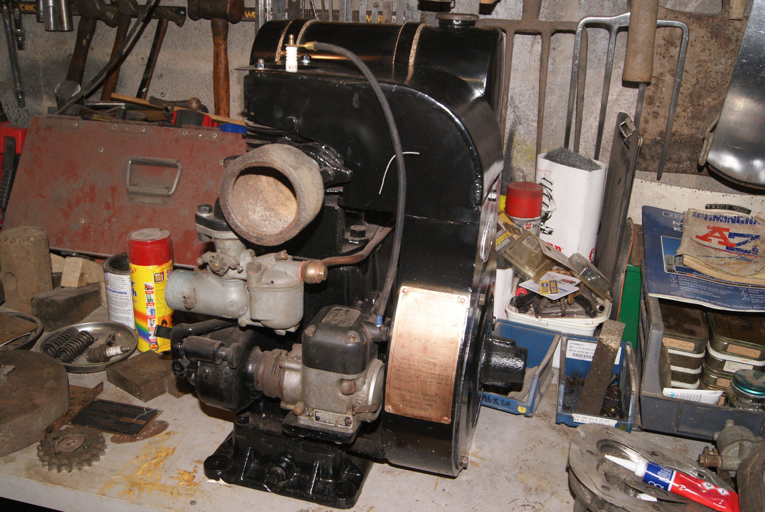

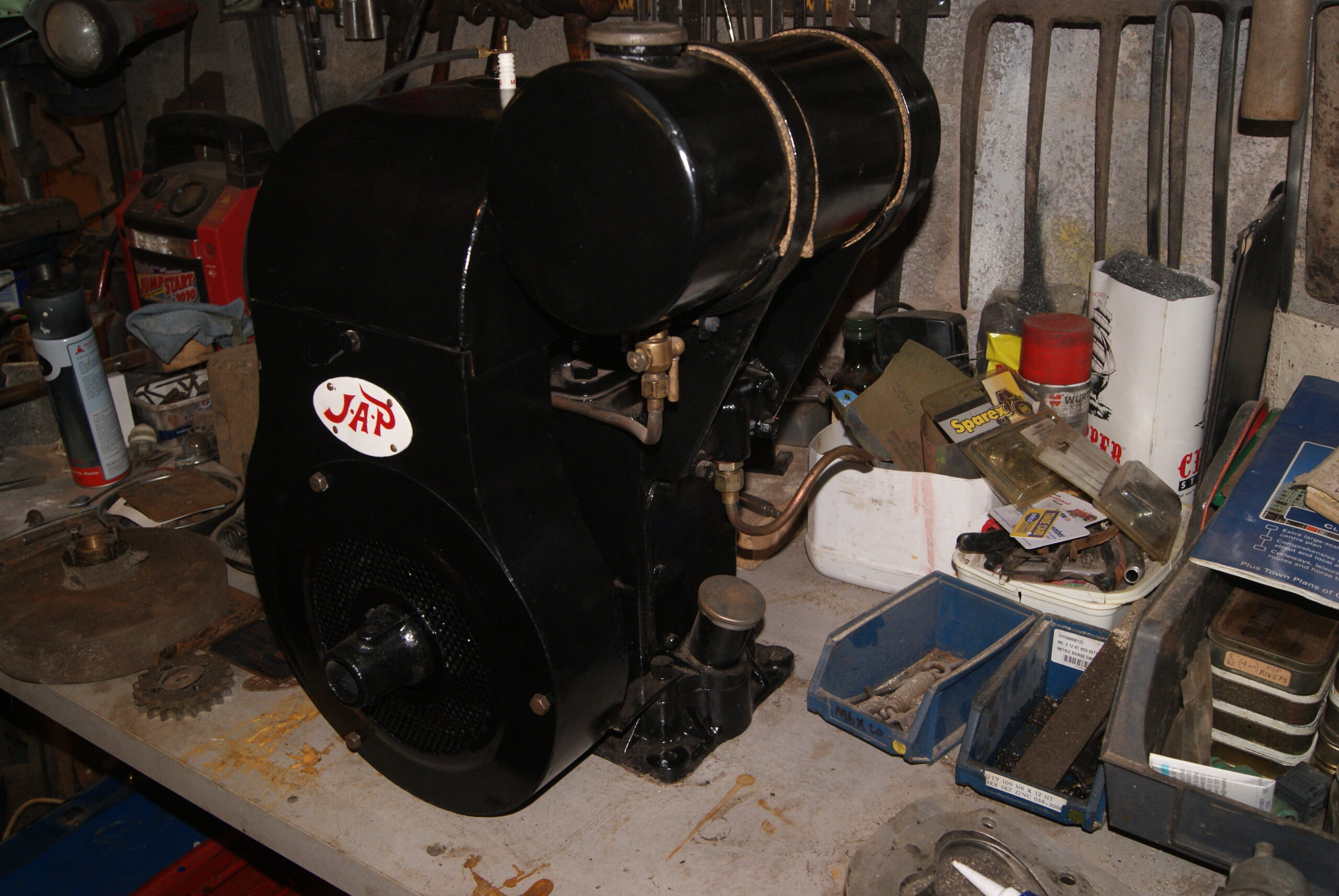

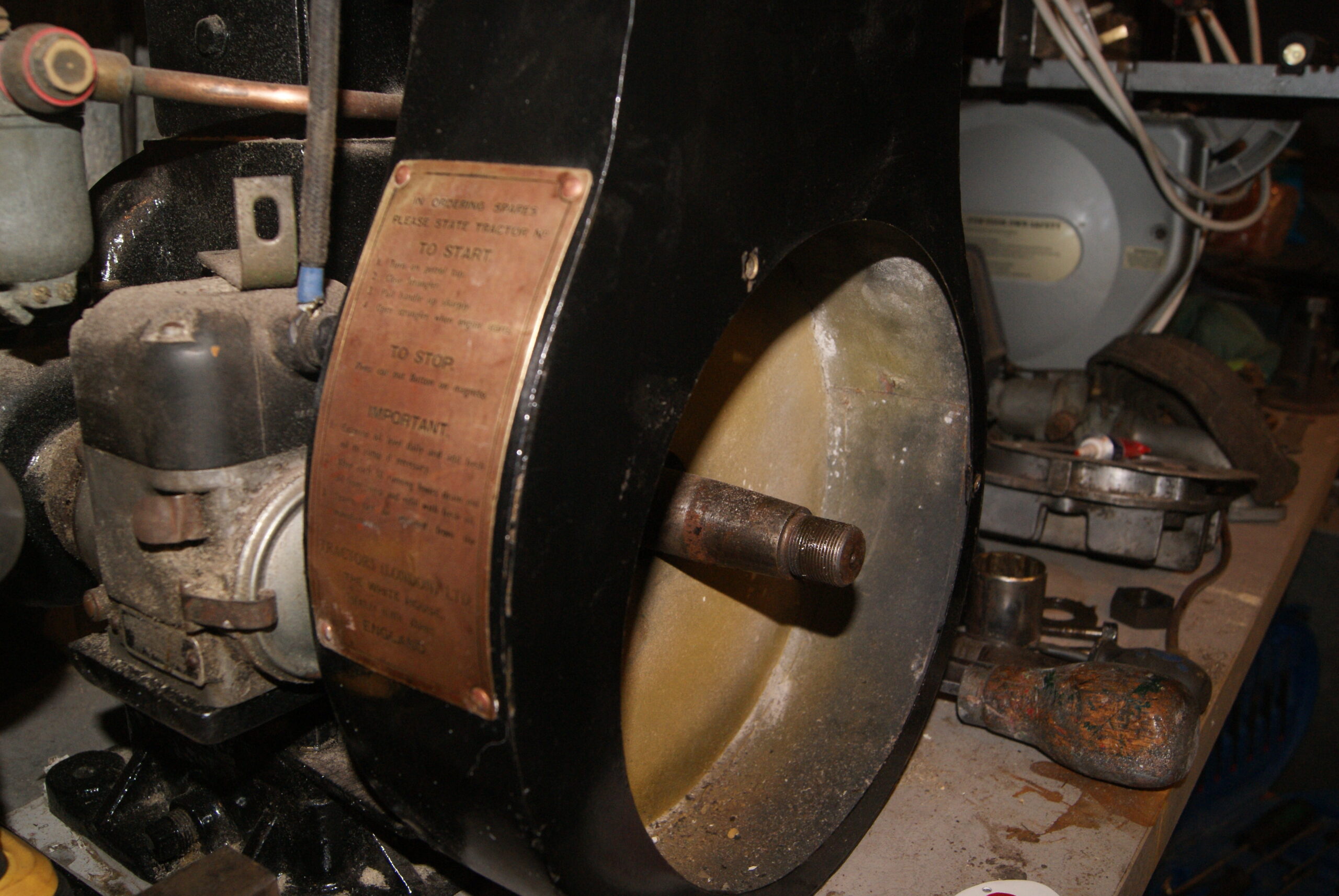

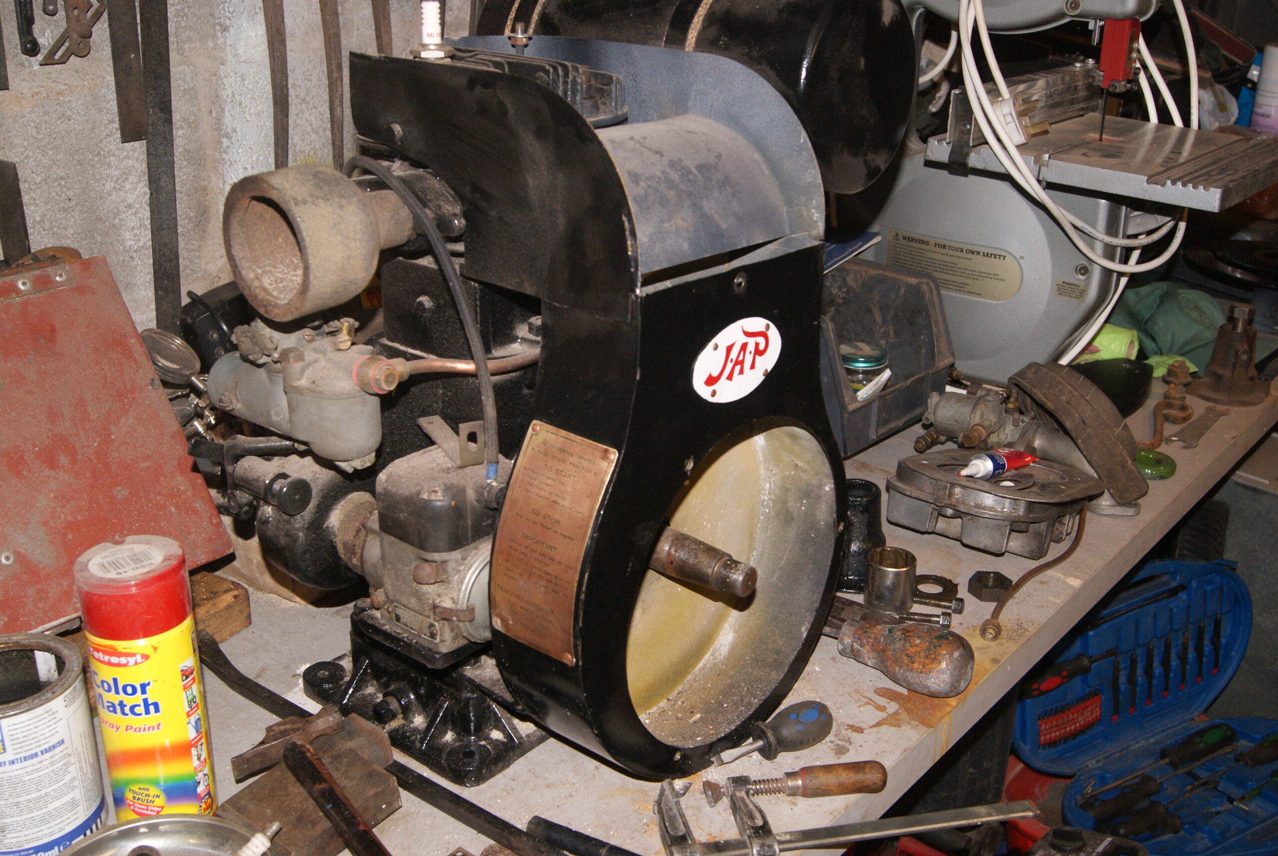

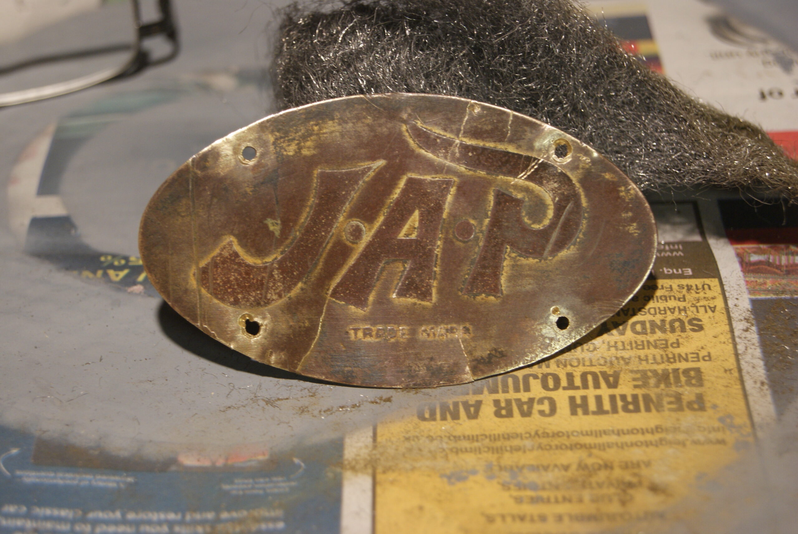

trusty220KeymasterI think your imagination should be sufficient for now, Dave, my face isn’t a pretty sight on the best of days! Anyway, I can now vouch for the quality of Plastikote Gloss White Radiator Paint in aerosol cans because it resists all attempts to remove it! It’s even in my right ear (so Mrs. Geoff tells me)!

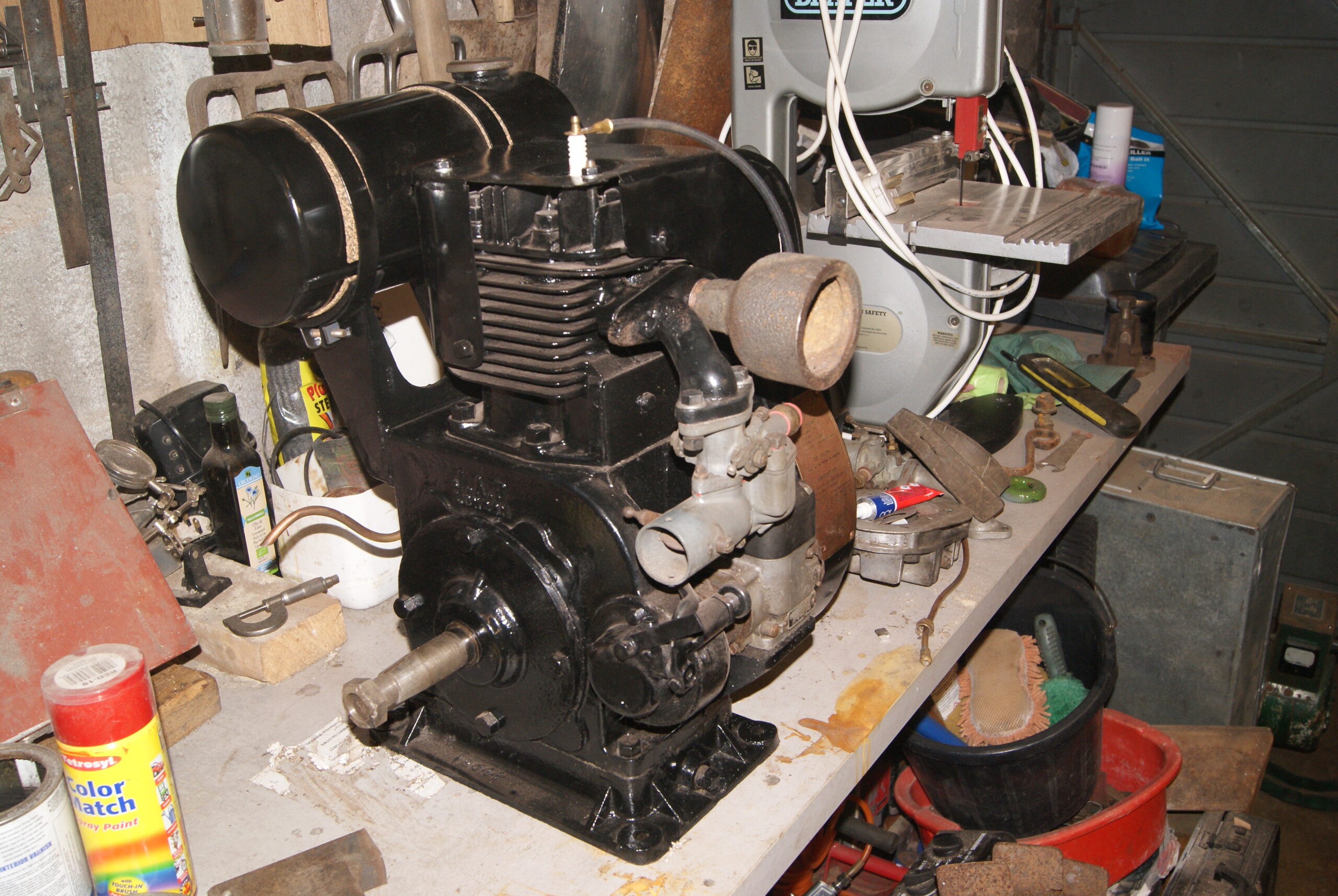

Onwards with the rebuild- now that I’ve got the paint can working I sprayed a generous coat of white onto the etch primer and left it in the sun for a day. Next day I picked out the letters in red enamel (I’m not going to use aerosol cans for a bit) with a very fine brush. It seems to have worked out quite well, but the words “Trade Mark” underneath the main letters were too small to attempt. The embossing for the large letters wasn’t deep enough to try the trick with the wire wool, so I discounted that method before I started.

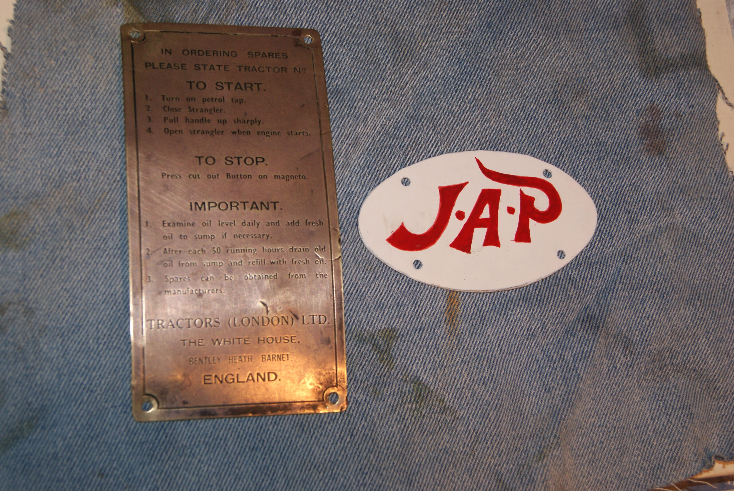

The other plate for this engine is the one that appears on the front of the cowling next to the magneto. Originally it would have had a similar plate added by JAP at their Tottenham works, but the cunning people at Tractors (London) Ltd. saw an opportunity to make more money by selling engine parts for their Trusty tractors; they used to remove the manufacturer’s plate and substitute it with their own. The two were identical apart from the last few lines which asked tractor owners to buy parts from Tractors (London) Ltd.- the original plate had J.A.Prestwich’s contact details in Tottenham.
The plate is made from brass with letters etched into it this time, so a quick go with the black spray can (I knew this one worked!) had the plate painted completely black all over. The wire wool rubbed off all of the paint on the flat surfaces leaving the letters picked out in black.
It only left the job of rivetting these plates back onto the cowling and the engine could be put aside for the time being. I found some copper rivets which would do the job well, being both soft and the right diameter, and so the flywheel had to come off again to give me access to the inside of the cowling to round the ends of the rivets over.

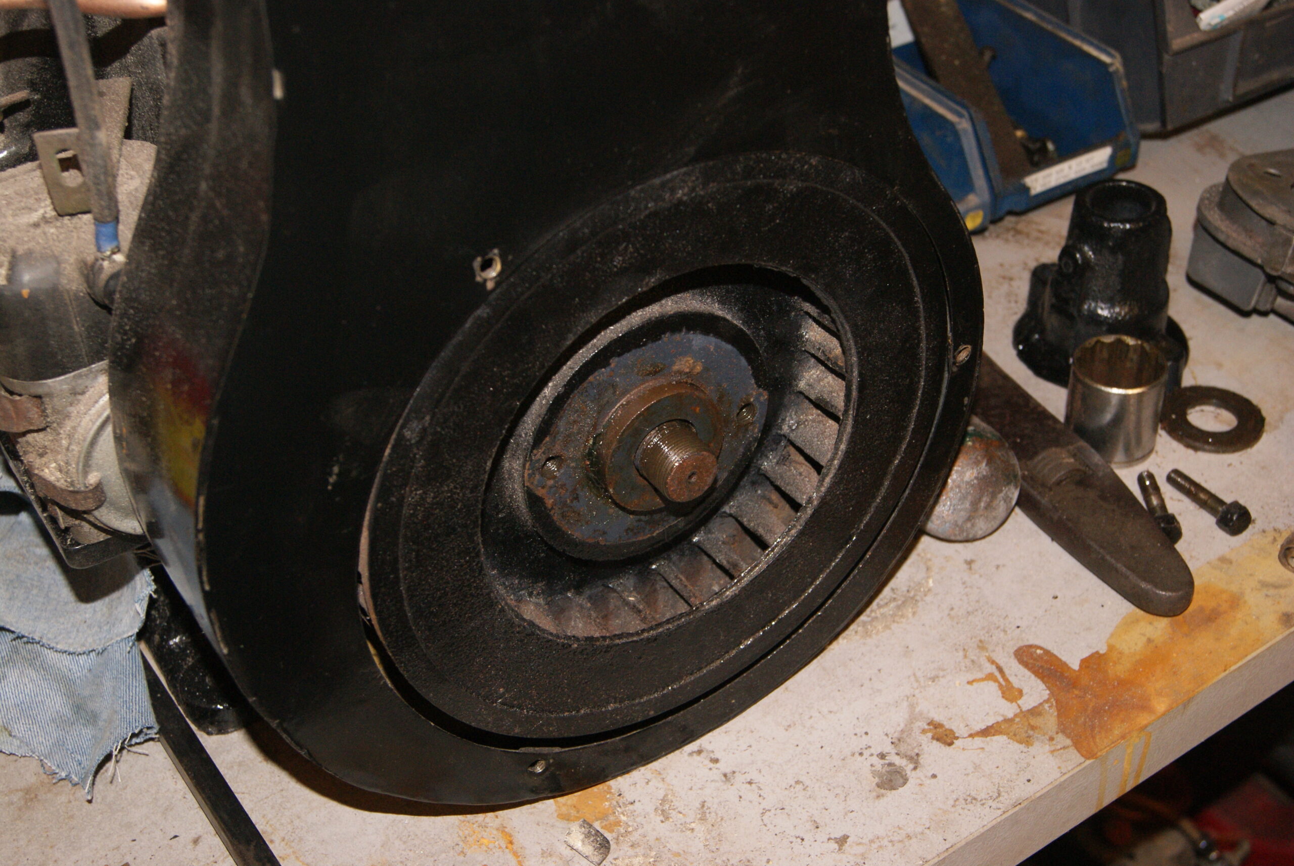

This is an early JAP 5 engine which has a very different cowling to most. The cowling continues across the back of the flywheel making it impossible to remove the cowling without taking off the flywheel- later JAP’s were modified so that the cowling will come off more easily and leaving the flywheel in place. The JAP 5 and JAP 6 engines are well engineered and incorporate their own flywheel puller to help the job along. If you look in the centre of the starter dog where you fit the starter handle there is a Whitworth thread through the centre of it; all you need to do is to remove the round bar that the starter engages with and find a bolt to fit down the centre. You will need to take the starter dog off to slacken the flywheel bolt underneath, but once you’ve done that you fit the starter back on and wind the centre bolt in until it bottoms on the end of the crankshaft. If it won’t shift by pressure alone on the bolt, give the bolt head a sharp tap with a copper mallet whilst it’s under pressure and that should be sufficient to pull the flywheel off it’s tapered seat on the cranshaft.
All that remained then was to drill a few holes and rivet the plates on, then re-assemble it all and stand back! During the rivetting process I did discover the way to remove the white paint- I managed to chip a little with the hammer whilst rivetting, but there’s no way I’m going all round my face with a hammer to get the rest off!
Enjoy the photo’s.

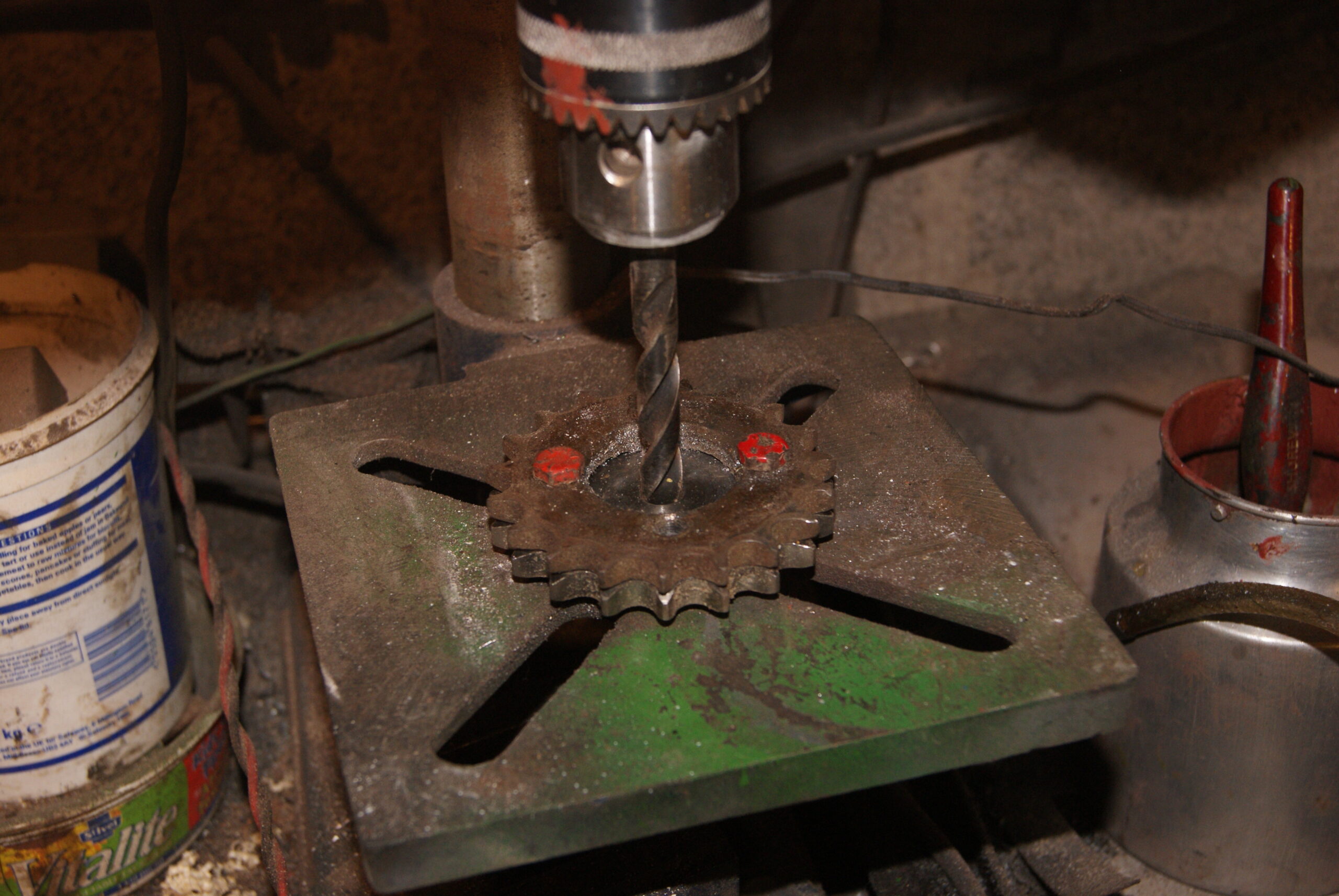

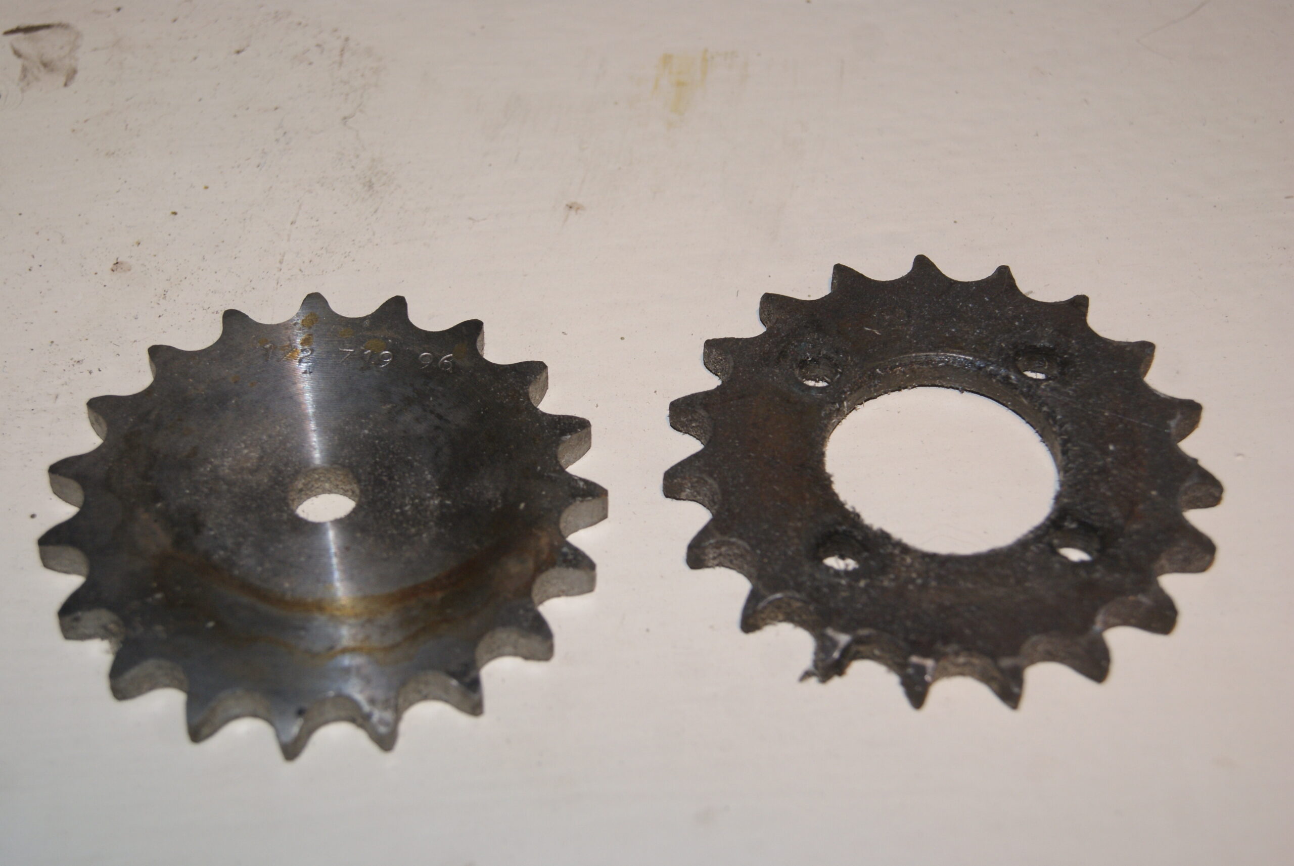

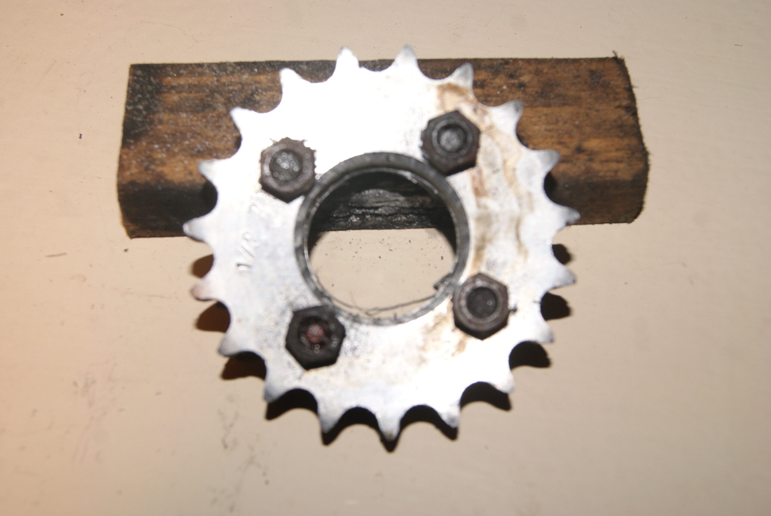

trusty220KeymasterNow, the next problem to overcome- I can’t fit the clutch until I’ve sorted out the chain sprocket on the clutch drum. Normally I would just mount it in the lathe and turn the centre out to the diameter that is needed to clear the centre bush, but everything is packed away in storage so I need to find a simple way of doing it without using machine tools.
If I clamp the two together I can drill out the four securing bolts using the old one as a template, but how to enlarge the centre? I’m stumped at the moment, anyone got any ideas?
April 22, 2020 at 1:45 pm #33952

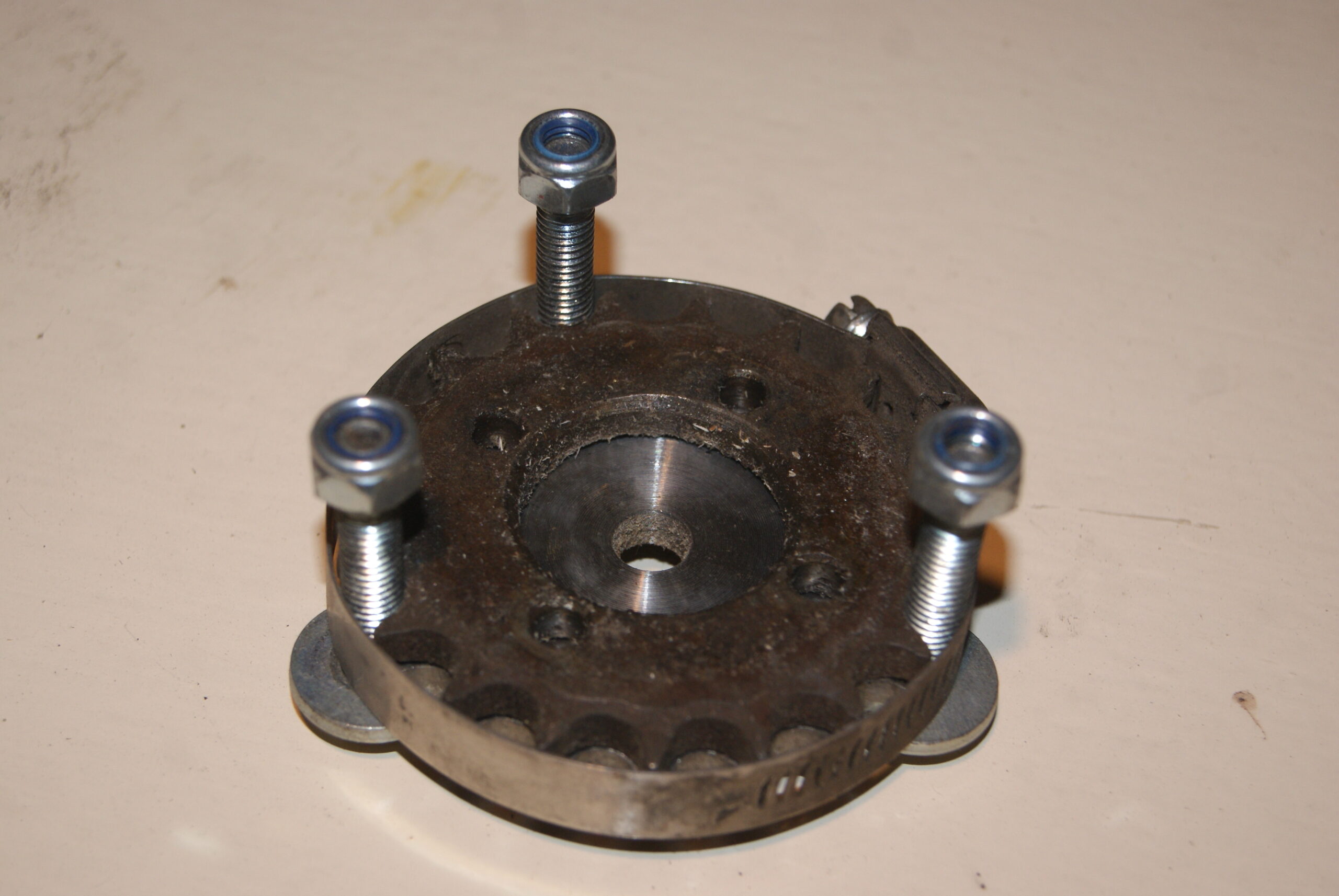

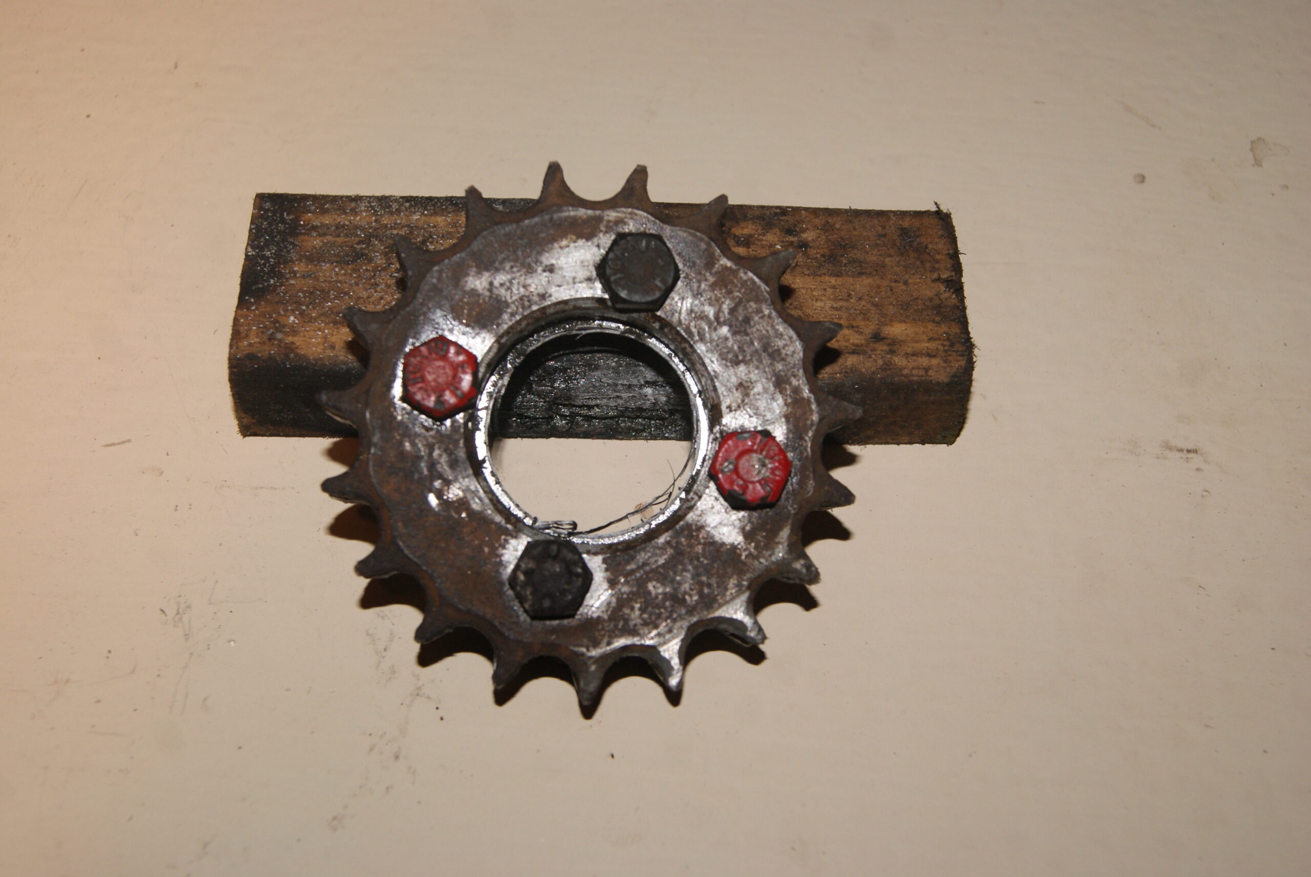

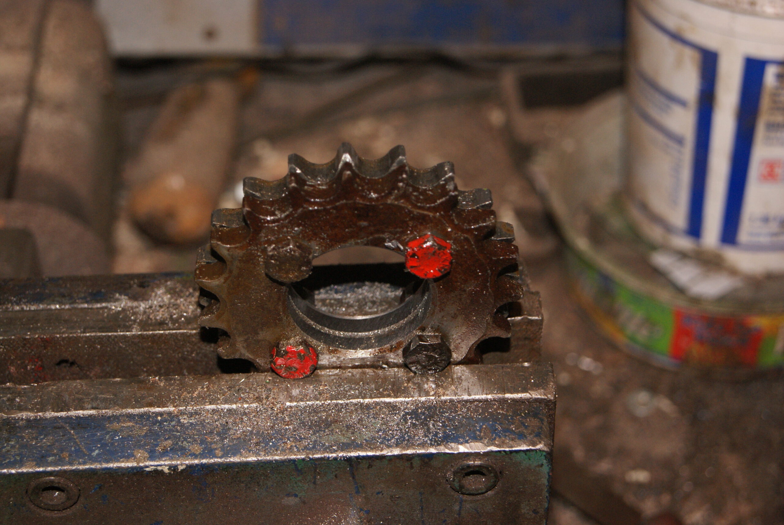

trusty220KeymasterI’ve had a few ideas and progressed the problem slightly as you will see from the pictures.
In order to line the two sprockets up exactly I hit on the idea of using three 5/16″ bolts spaced equally around the rim. This uses the base of the tooth profile (which will not wear as much as the teeth do) and so is much more accurate. To force the bolts into contact with the base of each tooth I then used a jubilee clip and wound it up tight, forcing all of the bolts to push towards the centre of the sprocket. This had the desired effect of lining the two sprockets exactly so that I could use the original to drill four 1/4″ holes which locate the holding-down bolts when it’s fitted to the clutch drum.
Now I’m stuck again; how do I make the 1 3/8″ diameter hole in the middle? Help!!

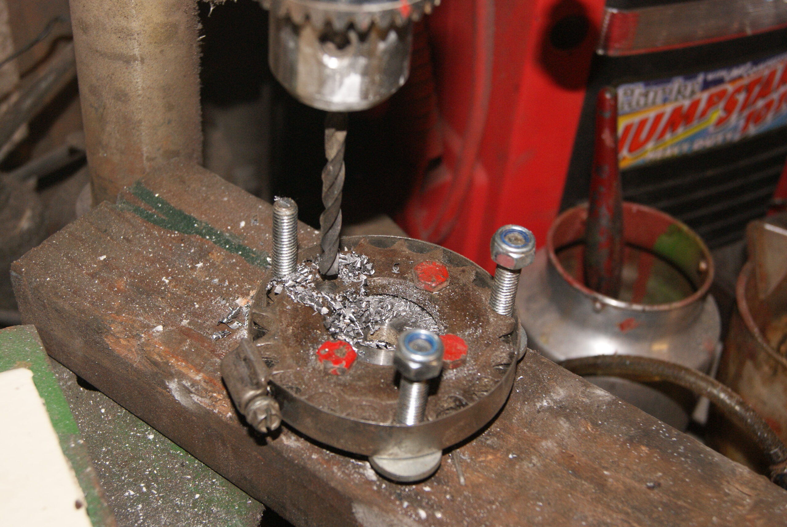

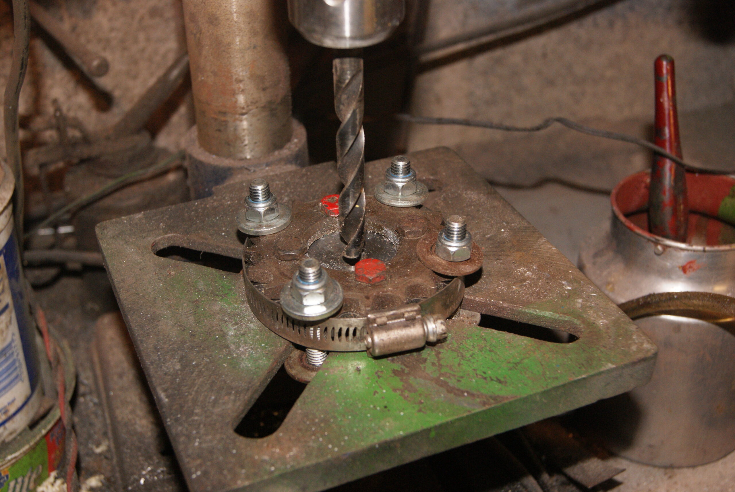

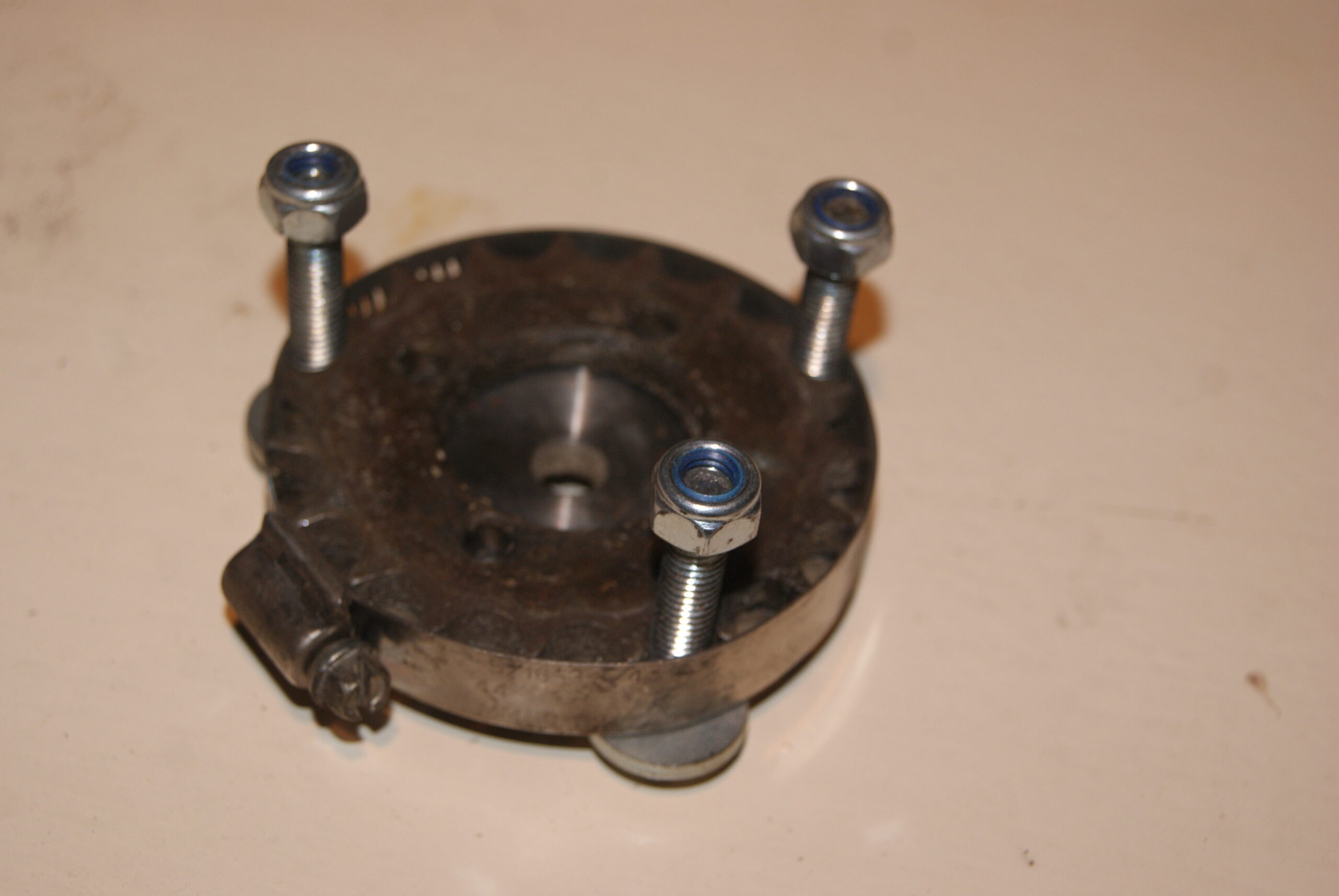

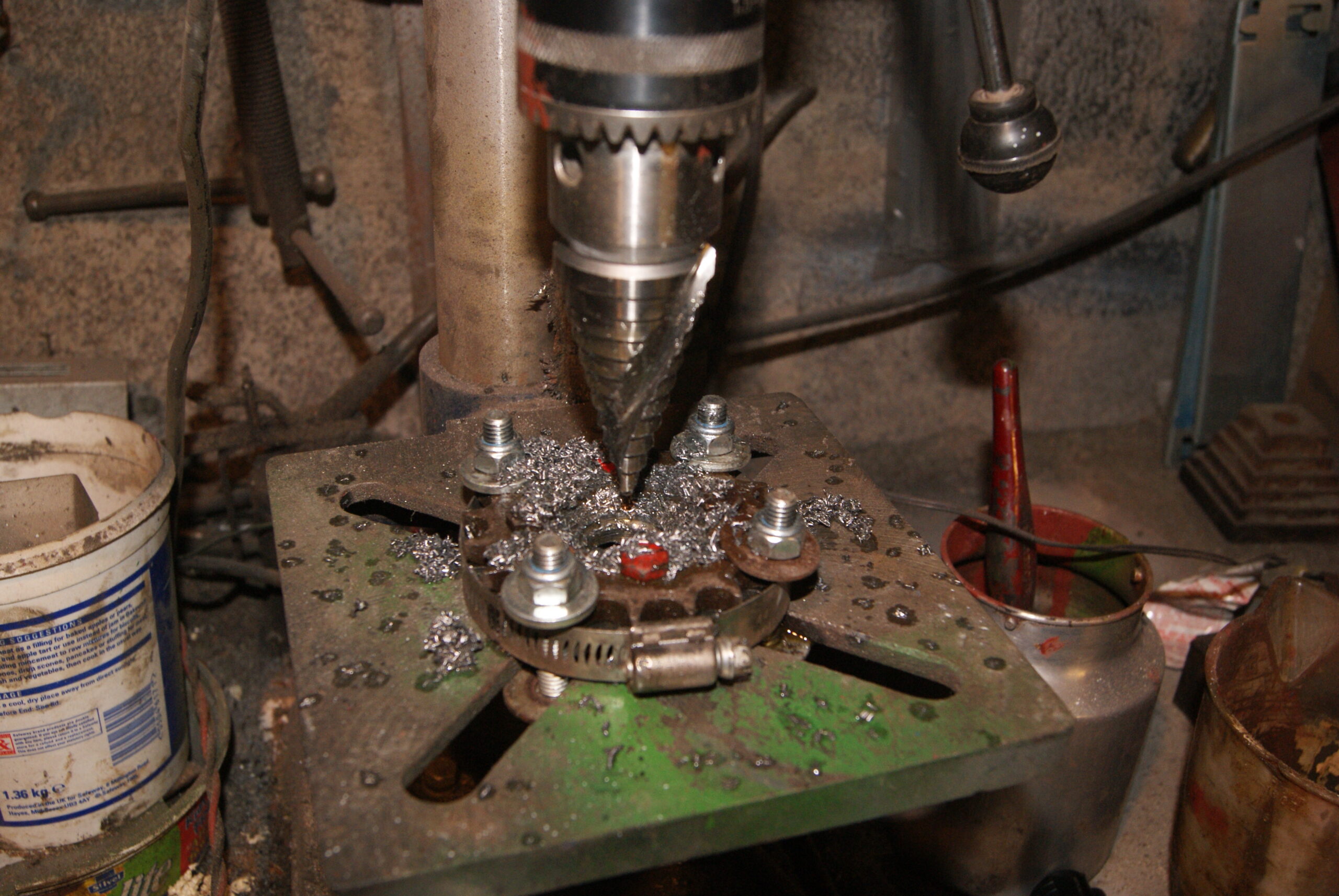

trusty220KeymasterYou obviously had the same thought as me, Charlie. I was trying to track one down last night and eventually found one in the Screwfix catalogue that looked like it might be man enough for the job. Paid for it on line and was waiting in the queue at 8.30 this morning!
Now that the sprockets are held together by four 1/4″ bolts with nuts on the back I hit on the idea of using four 5/16″ bolts to hold it down to the table on the pillar drill; to stop them sliding off as I tightened them the old jubilee clip came in handy again. A 7/16″ drill through the centre hole fitted quite snugly, so I put that in the chuck and used it to centre the sprockets by tapping them this way and that until the drill entered the hole without binding (lots of patience here!).
It was then the work of a moment to swap the drill bit for the conical step drill and lower away, but very, very gently with loads of oil and backing off regularly to clear the swarf. I’ve had to call a halt on proceedings tonight because it started to chew the centre hole out of the table, so I’ve got to re-position it to give more clearance underneath. A job for tomorrow once the animals are fed!

trusty220KeymasterThe step drill has certainly done the business better than i could have hoped for. Whether a cheaper one would have worked just as well I don’t know, but this one claimed it would cut 5mm thick steel so I thought that it would be better. If you’re going to spend money on something like this, better to spend a little more and get a tool that’s going to last.
Anyway, I roped Mrs. Geoff into the job this morning to give me a hand to centre the workpiece again once I’d spaced it away from the table. Really I should have used metal blocks but all I had to hand was wood and so that had to do; the problem with using wood is that it compresses slightly and you have to be very careful how you tighten the retaining bolts otherwise the workpiece will tip slightly. The knack was to get her to lower the step drill into the hole and keep moving it up and down to feel if the sprocket was moving as I tightened the retaining screws. If it started to drag on one side or the other I then tightened the opposite side to bring it back into true again until I had it bolted down firmly. It was then a matter of drilling the rest out but stopping before the last step because it would make the hole too oversize. I found it handy to start the drill cutting the last step to leave a taper on the edge of the hole so that when I opened the hole out to the finished size with a half-round file I had a reference point on the outside; this helped in keeping the hole circular and concentric.
You can see the results in the pictures. I just hope they load in the correct order!

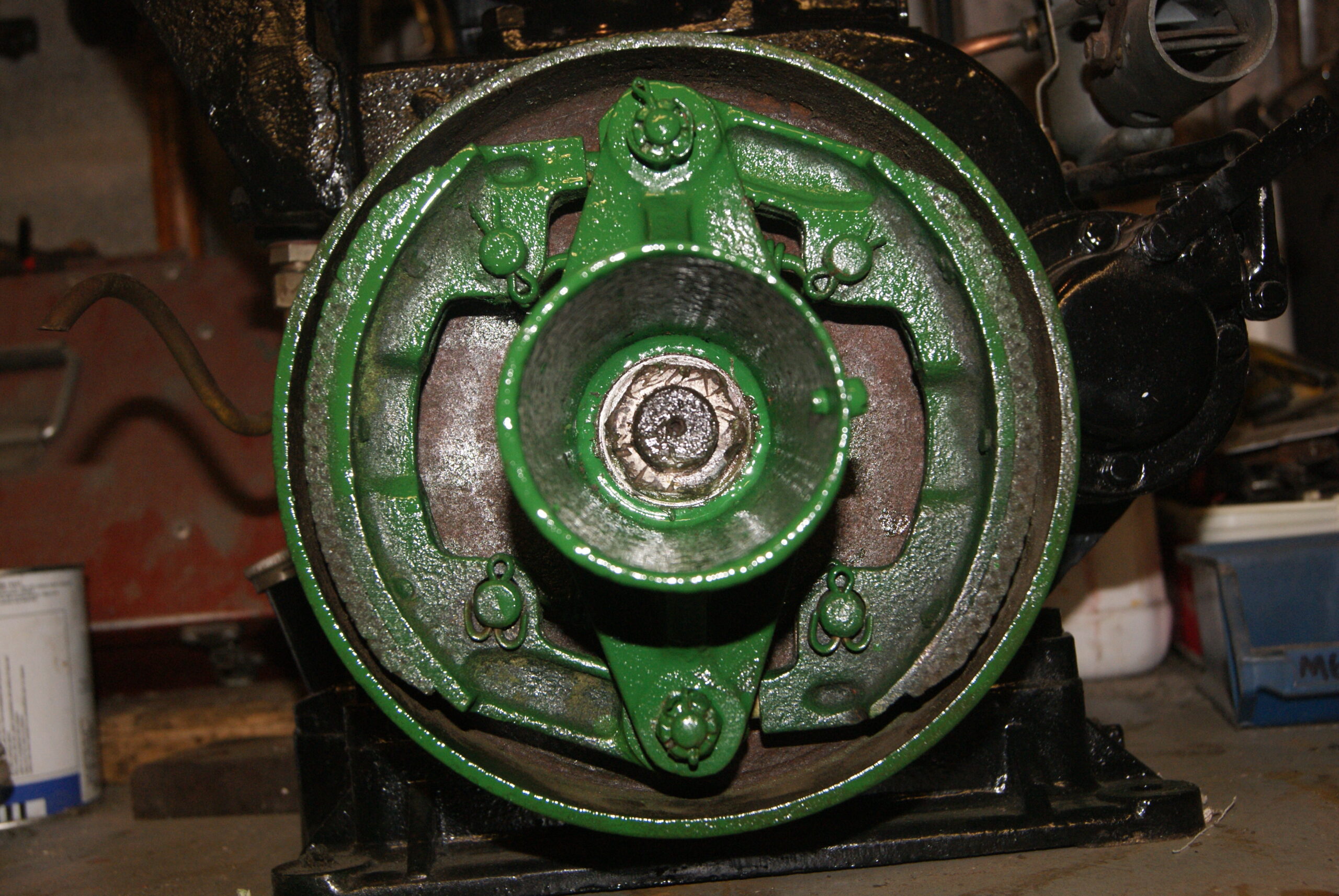

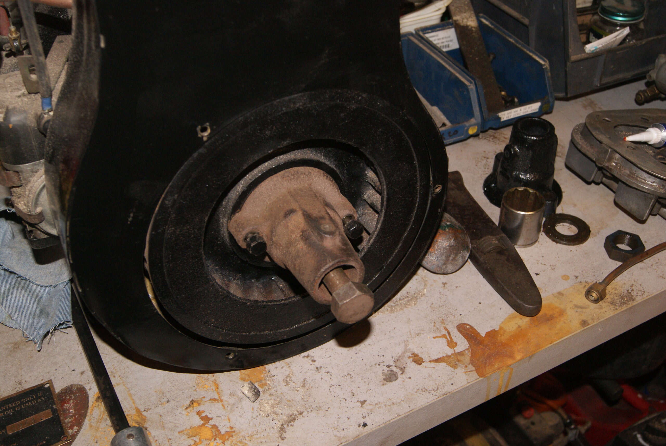

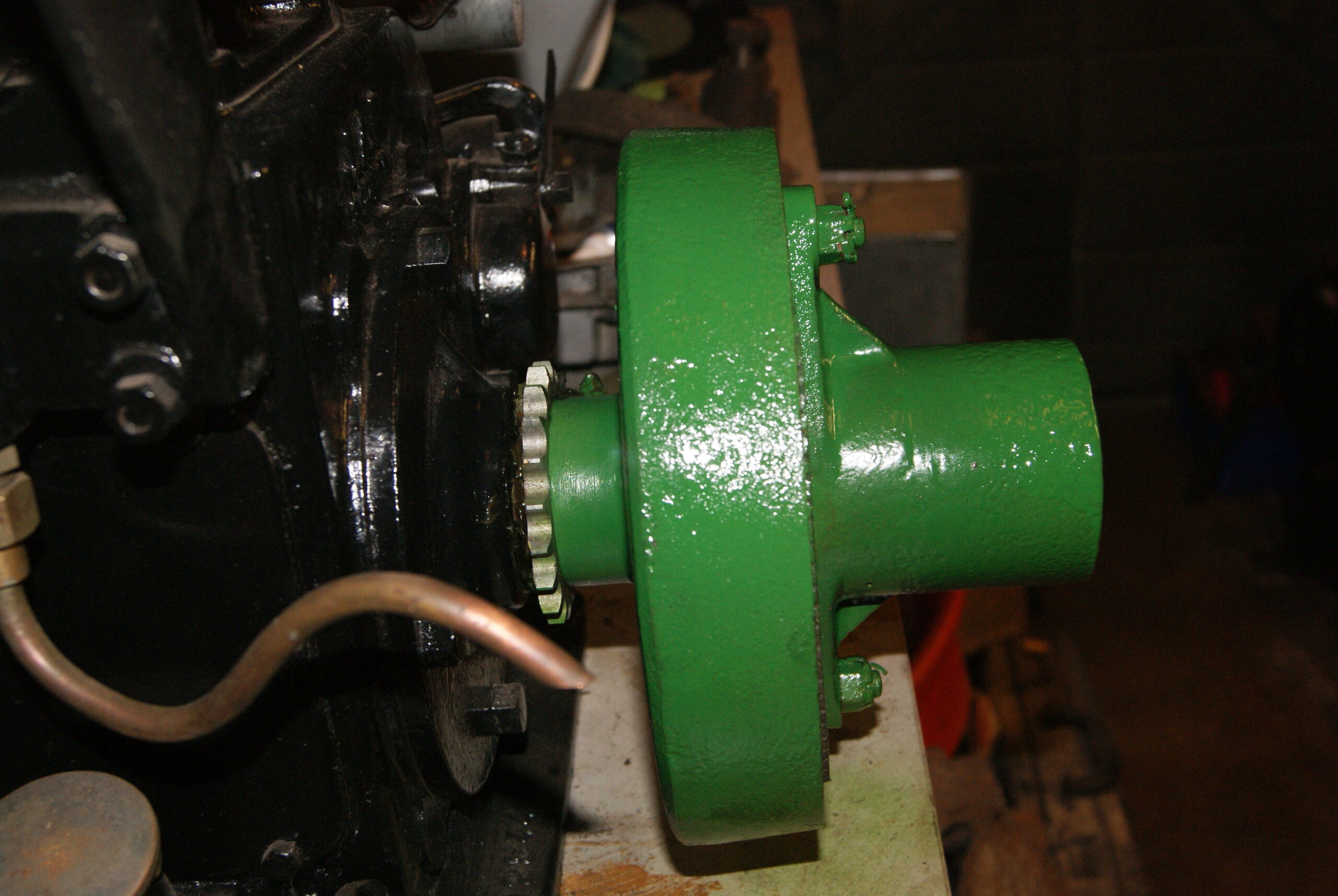

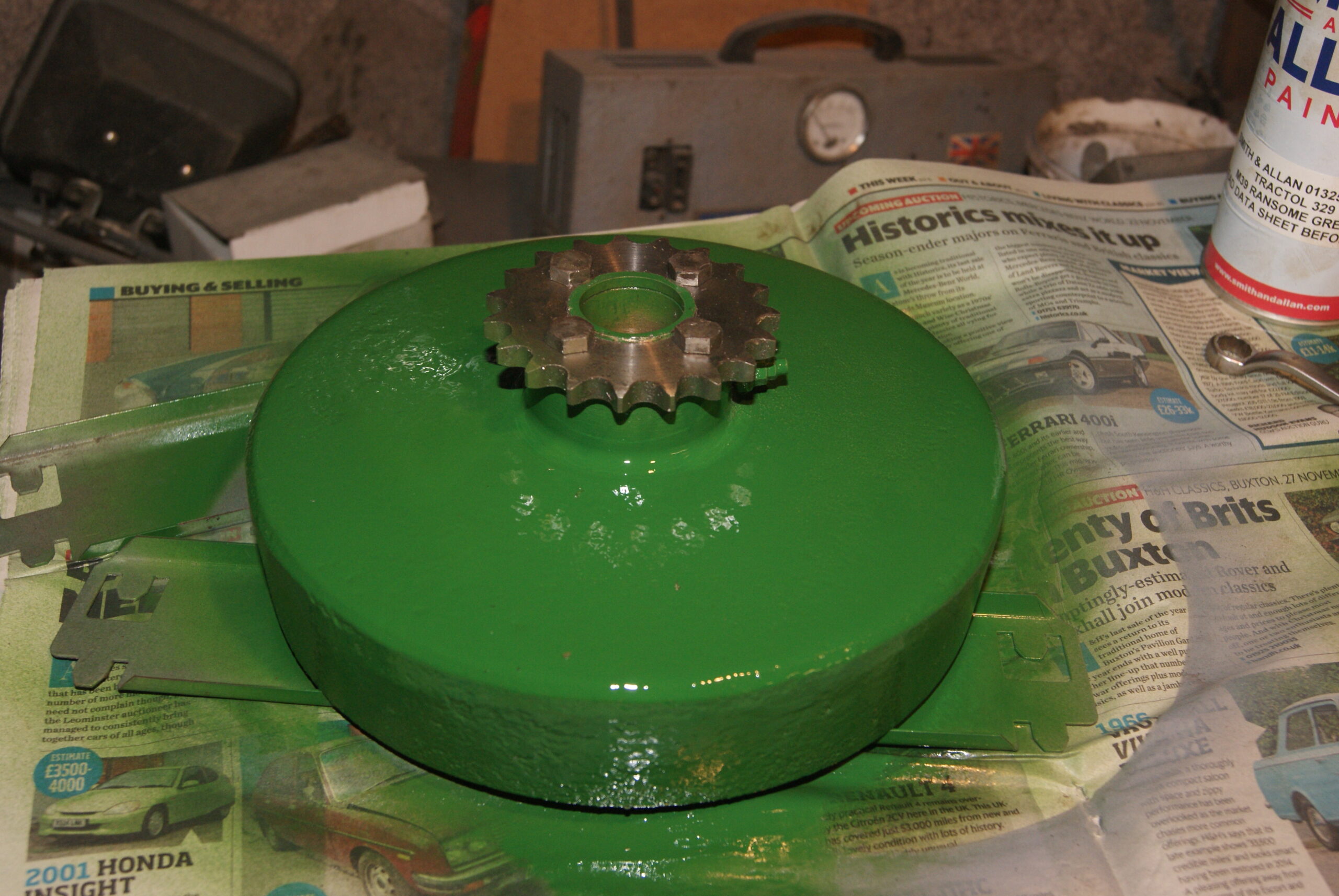

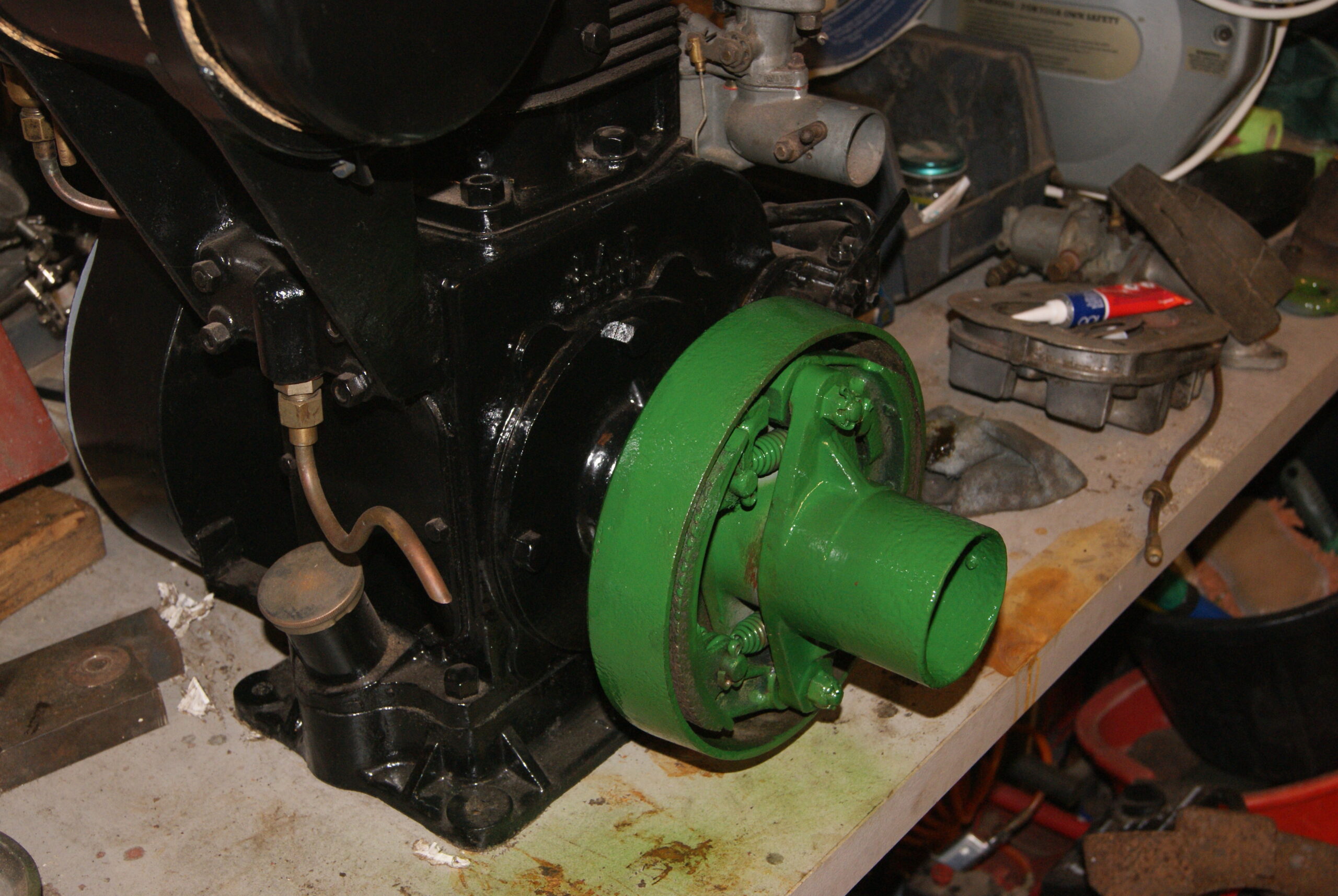

trusty220KeymasterJust so that you can see the final result, here are a few pictures of the clutch fitted up to the engine. A shame that It’s all hidden away once it’s finished but at least I know that it’s done properly.
This clutch is slightly different to the normal ones as the early JAP 5 has a taper on the end of the crankshaft, similar to the flywheel end, and so the clutch carrier is slightly different in that it has a reverse taper on it’s inside face. It is also located with a straight keyway but this should not have too much pressure exerted on it when working because the taper should be adequate to hold the clutch in place. The key itself was a strange one in that I had to file it to fit; the slot in the carrier was just wide enough at 3/16″ but the slot on the crank was slightly undersize in width and depth, but not enough to step down a size, so the only solution was to file it down to fit.
