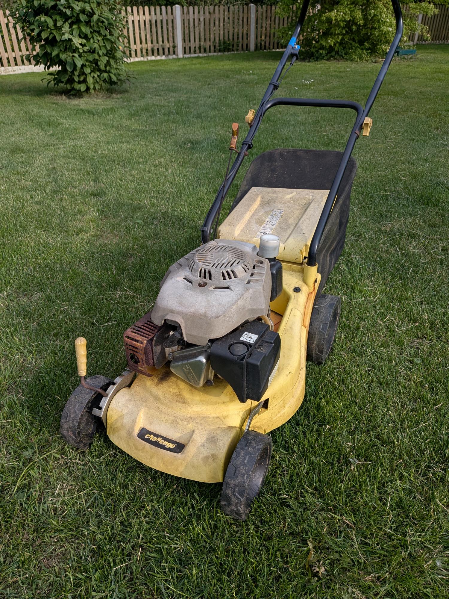

ParticipantIts a bit modern but earlier this year a friend had stood two mowers out to go to the tip, the little rotary no idea of make had apparently been outside for many years all the control cables had rusted off and as being one of the modern types as soon as the hand controls are released it cuts the ignition and applies a brake on the flywheel so couldn’t tell if engine felt good by turning it over. I got if you can do anything with it take it, it was very easy to work on, got the pull start off, flywheel brake tied back and refitted the pull start, it was now nice and free and if you had seen the coil with the rust expanded leaves the coil is on you would have said you’ll be lucky well there was a good spark at slow speed. Cleaned the carb, renewed the rubber pipes, petrol and was away running like a sowing machine until it started to knock and clatter very loudly. It was very lucky as the plastic infill bits on the flywheels outer edge with rust had lifted them and the extra centrifugal stain caused them to catch the coil leg bits so was very lucky it didn’t damage anything. Done away with the powered drive so now easy to push forward and backwards. So now my daughter has a very light easy to use mower and gets on very well with it, that is until the pull start kicked back and bit her a few times one day, I did have it kick back but as long as you pulled it gently over compression and then gave it a good pull was ok, the last time it did kick back it bent the pig-tail some bit thats up the handles. So have had it apart(flywheel was on very tight is a understatement) and the key was intact, only one thing to try I machined a .030 thou stepped key, so fare been gentle as a kitten, just remember its not just a joggle but the joggle is at an angle so has to be set and machined. Anyone know the make as its usual in that engine crankcase splits diagonally.
