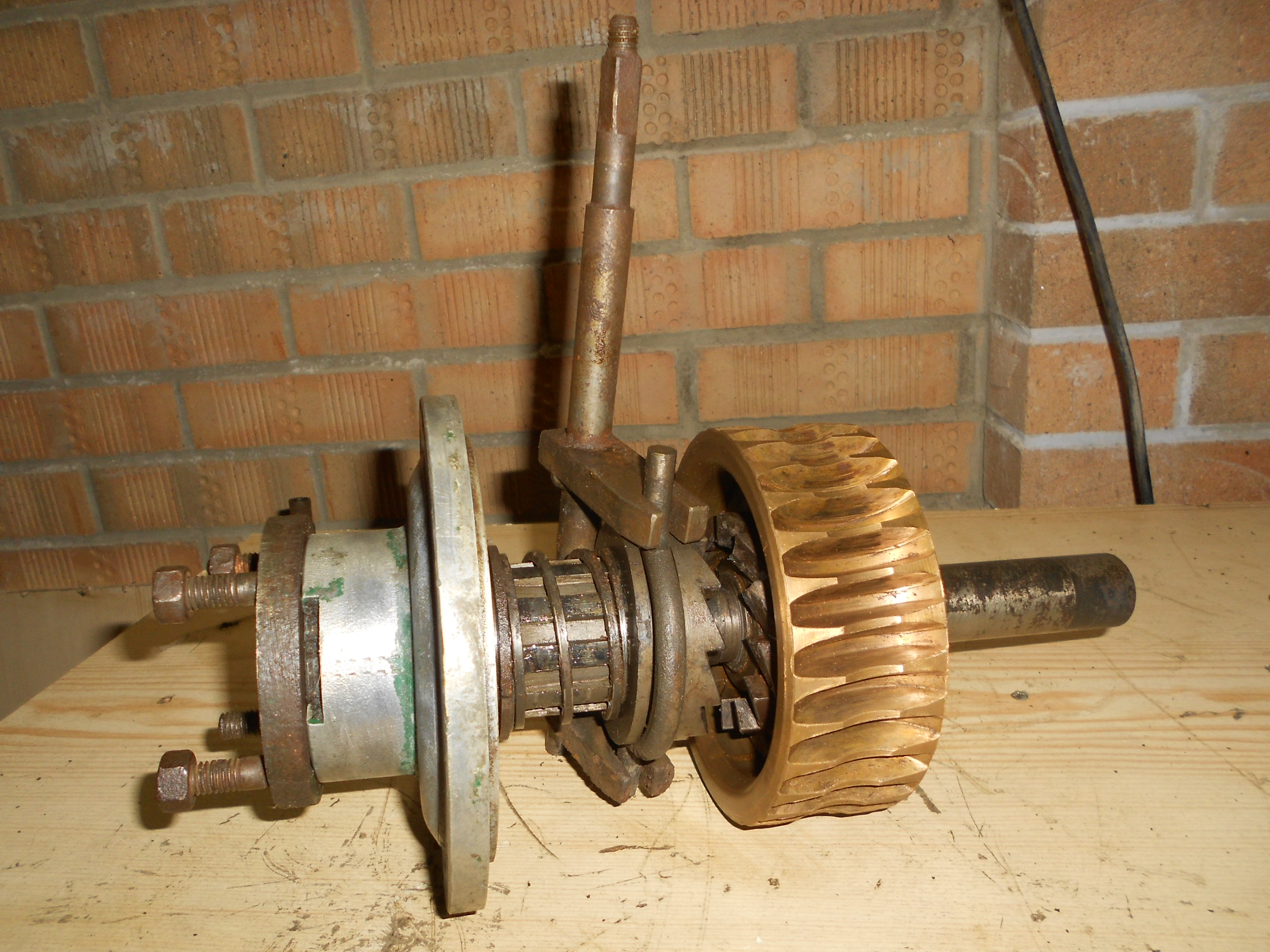

I though I would include a couple of photos of the drive mechanism. The two wheels are normally locked together (ie no differential) and occasionally one wheel is disengaged which enables turning. I think this was quite common, but believe Fredrick Coleby patented this in the 1930’s. I hope to find the patent applications for this soon.

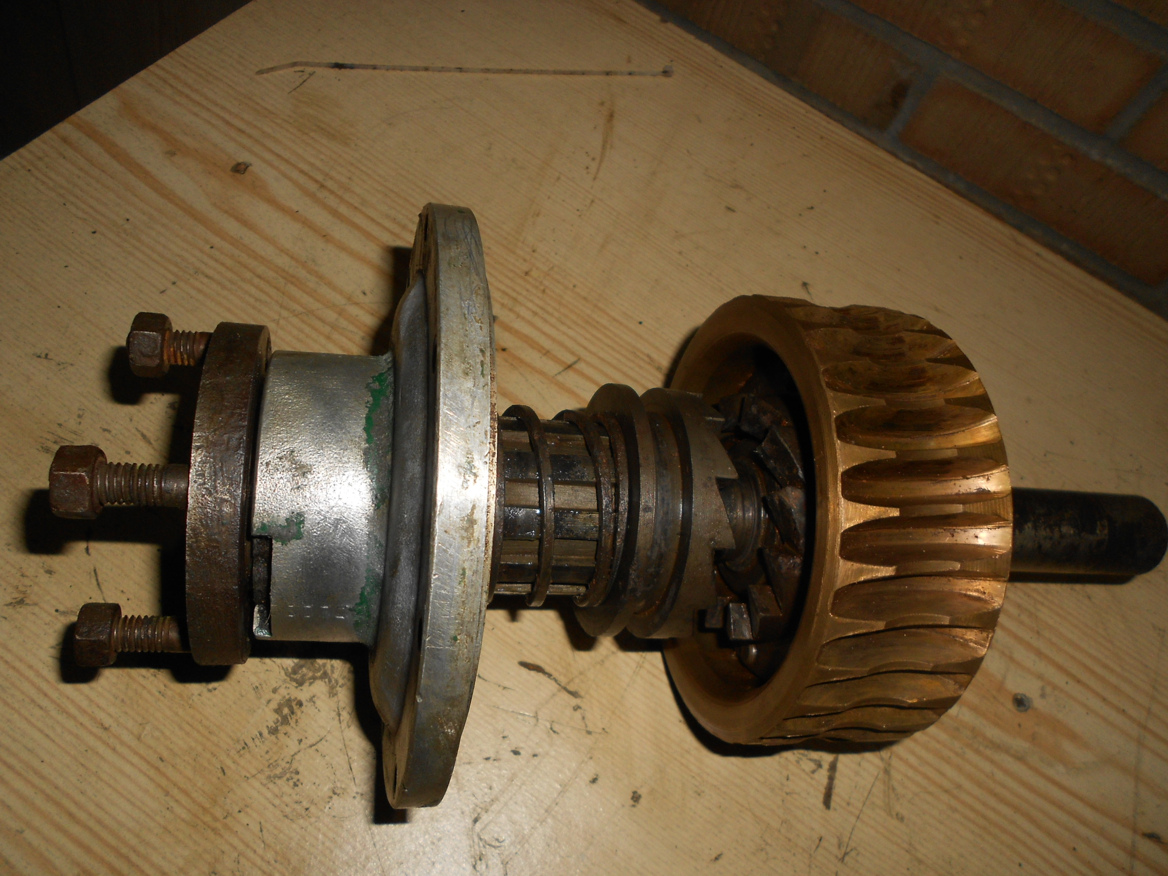

ssorthiekParticipantStill on the gearbox, I didn’t realise that the left and right hubs were different. I need to go back and look at photos and decide which goes where, just as well I kept all the components together for the left and right hubs together. I’ll soon have my other Coleby Junior to do a comparison in any case.
What I have found is that there is a home made thrust bearing on one side but not the other. I suspect that this was a factory made bearing and was “good enough” for the low speeds it was intended for.I also think that this might have been an addition on a later model.

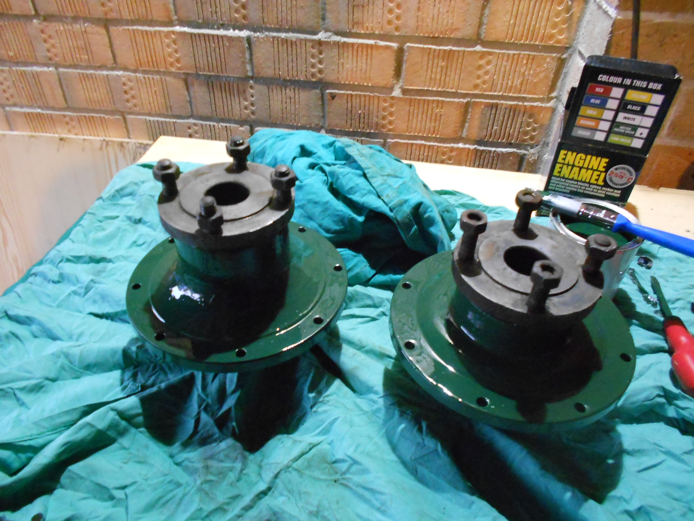

I’ve been wanting to paint something for a while now. I have had some bits powder coated which I think I’ve mentioned before, and hoped that the colour was a good match. I think it is but need a bit of daylight to have a really good look. I also need the paint to dry. I suspect, if the colour of my hand are anything to go by, I’m onto a winner.

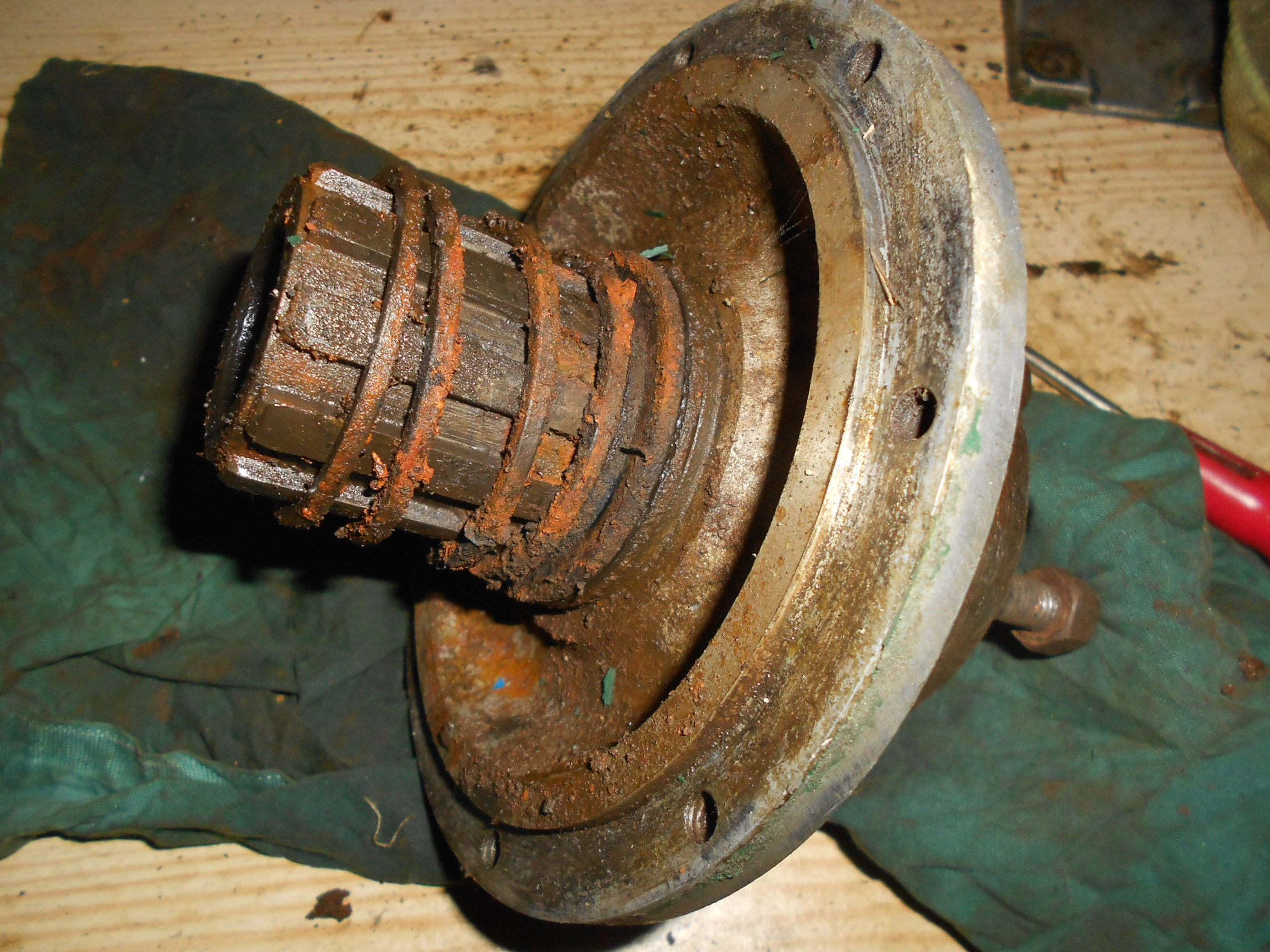

So, now photos of the other hub assembly and some newly painted hub housings.

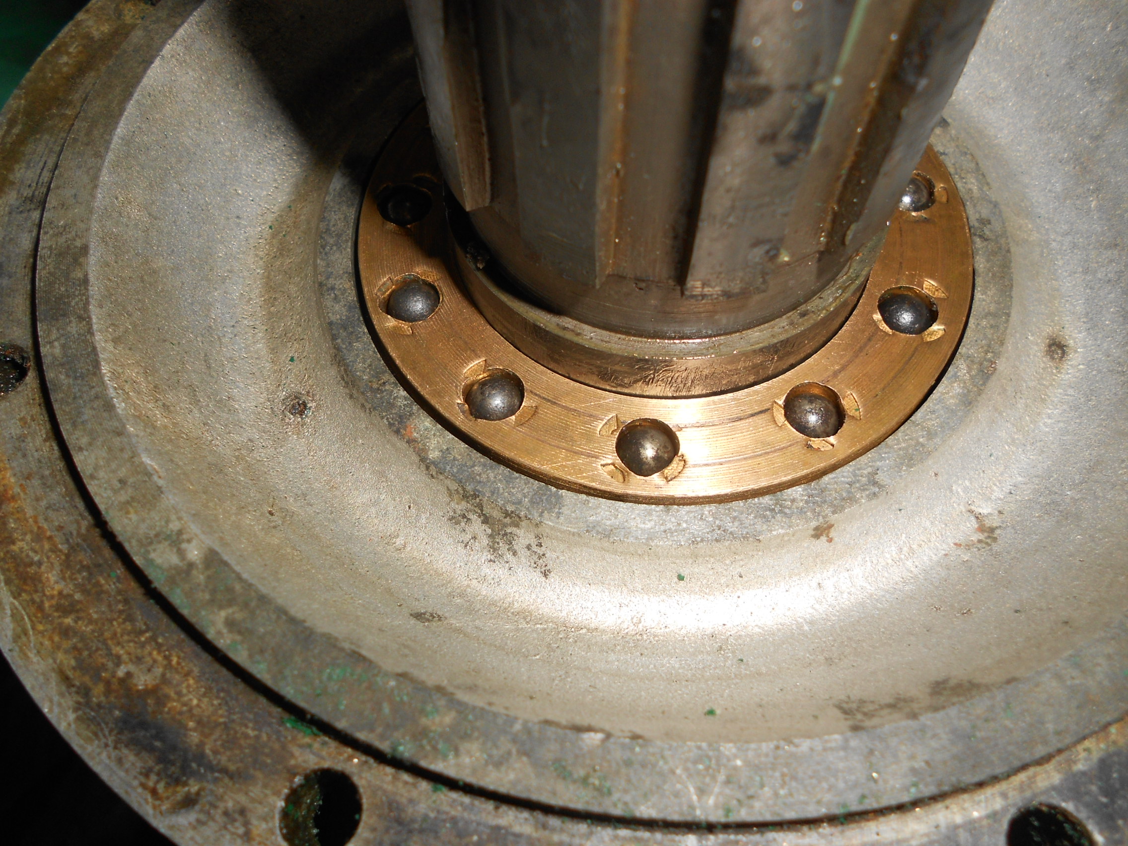

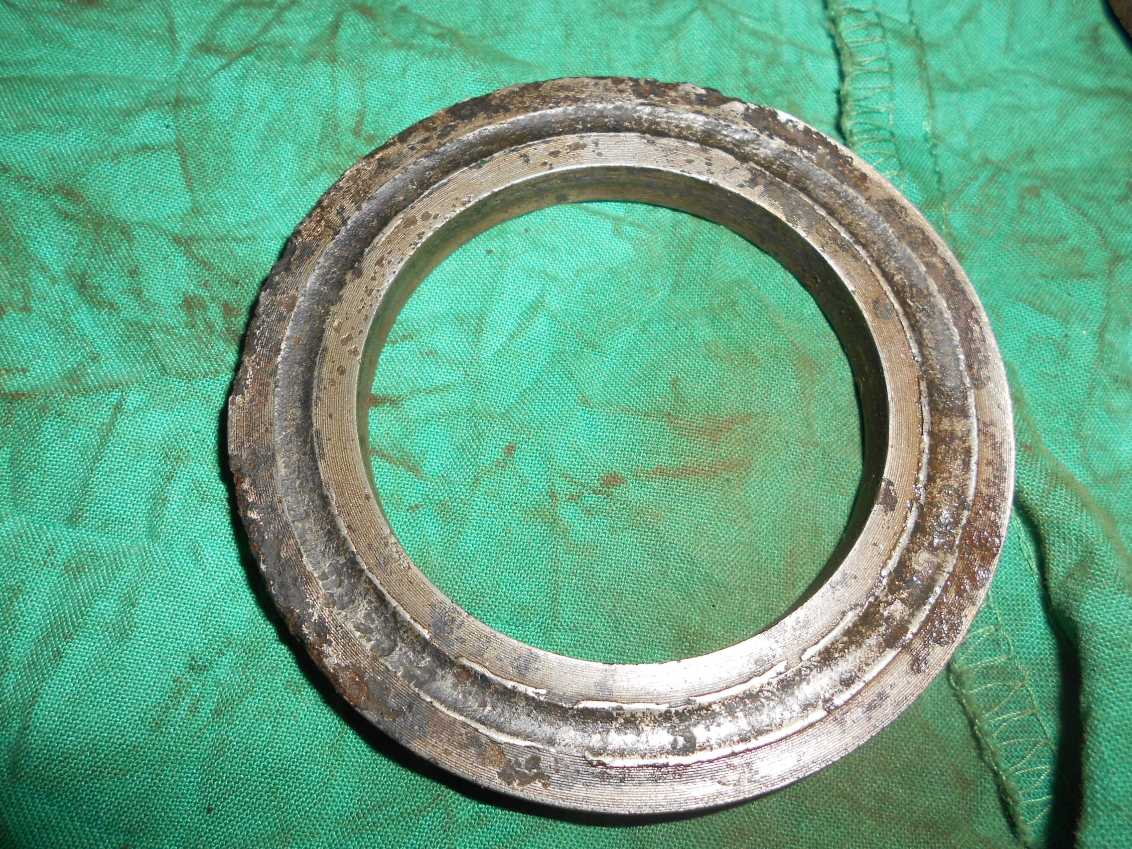

Incidentally, the thrust bearing surface is quite pitted and I would welcome any thought about the longevity of this bearing considering this machine will only ever see light use and the speed is likely to be of the order of 30 rpm at top speed.

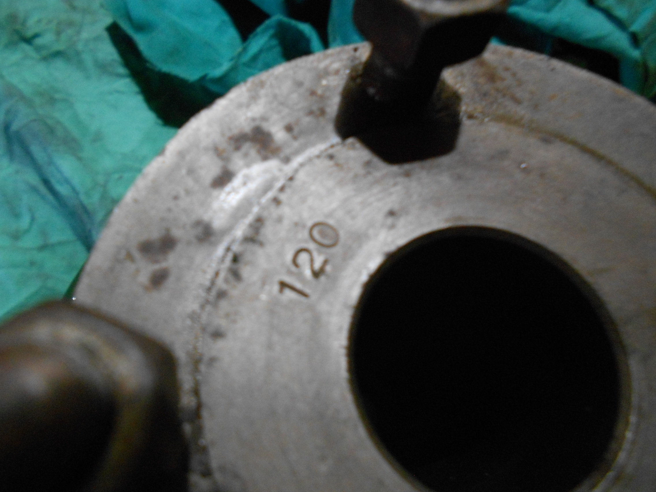

Finally, I have found numbers stamped into some components on non-critical surfaces. I assume these are part numbers which in itself is interesting. The last photo show one such marking. Can anyone confirm this or provide any additional information at all?
Keith
October 22, 2018 at 9:10 am #29465
charlieKeymasterThe pitted thrust washer in second photo looks as if it is the outer race of the bearing. The Monrotiller gearbox has a similar bearing.
October 22, 2018 at 5:14 pm #29466
ssorthiekParticipantThanks Charlie, I should have taken a photo of the casing the other way up really, but the phosphor bronze bearing in the casing is sandwiched between two steel hollow shafts about 1/2″ long. I think they both have male threads on them but I’m not totally sure about this at the moment. Anyway, the inner retaining shaft has the other half of the thrust bearing outer race, and fits together quite nicely. So yes, you are right the second photo above is one half of the outer bearing race while the other half is really part of the hub casing.

All I need to do now is to carefully rebuild the gearbox. One issue I have is when I took the gearbox apart, there was a thrust bearing. But there was nothing stopping the thrust bearing moving along the shaft. I just need a spacer. However, one side of the thrust bearing must of course be running at the same speed as the shaft and the other must be running at a different speed (stationary) for the ball bearings within the bearing race to be effective. I’ve come up with an idea for a suitable washer / housing to sort this out, but wondered how other machines are set up with regards thrust bearings.
April 23, 2019 at 7:06 am #30992
charlieKeymasterCould you show a diagram or photo of the setup as it is so we can see how shaft, bearing thrust washer and gears are arranged at present.

ssorthiekParticipantOh, I managed to work out what was going on with the gearbox I think. Someone had tried to overhaul the thing and just left the thrust bearing off altogether. I just fitted one in and it fitted perfectly (I think). Time will tell. Thanks Charlie for the post.
