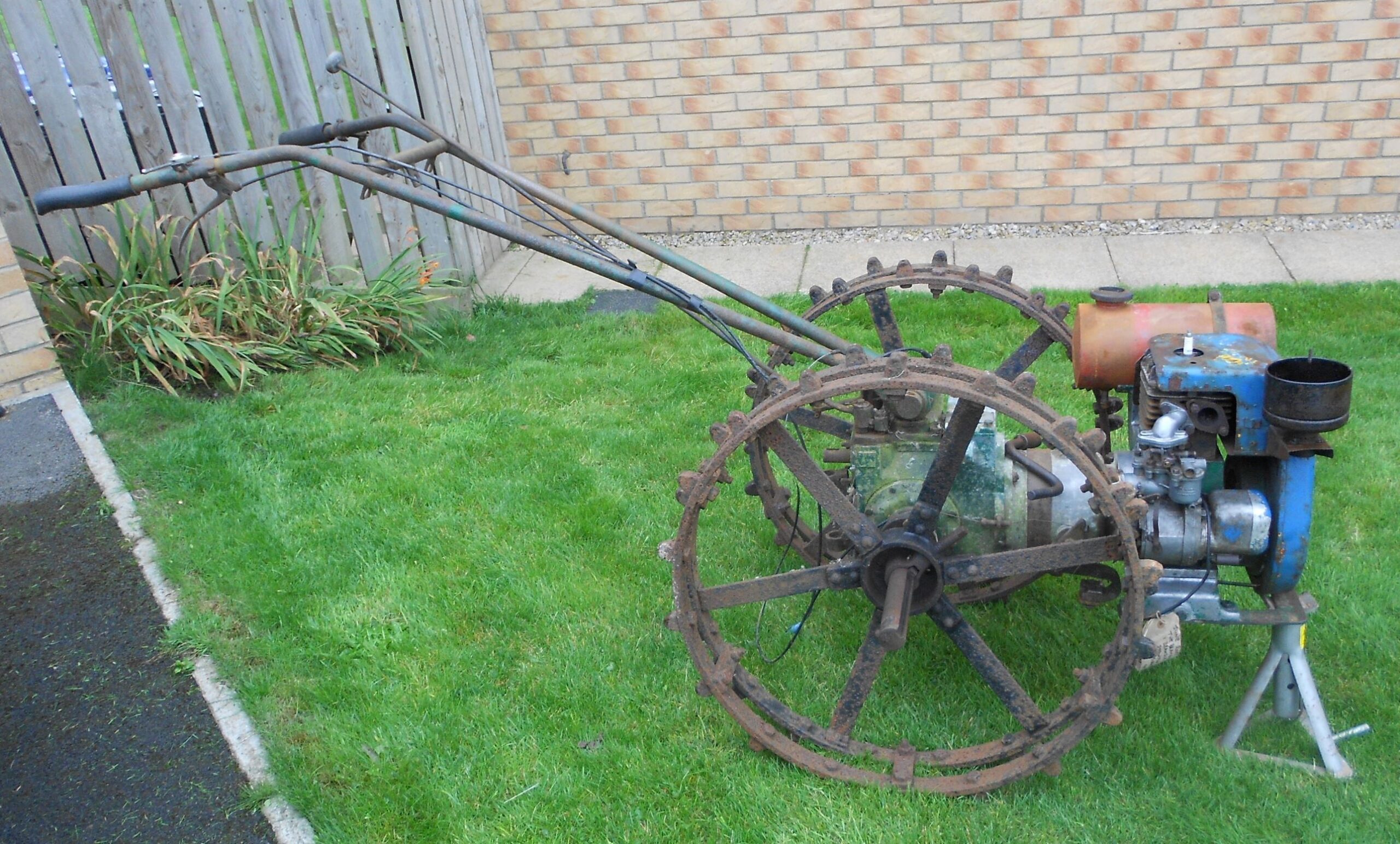

ssorthiekParticipantI am new to VHGMC but now have an increasing interest in Coleby Cultivators. I am currently restoring one and have recently purchased another from a gentleman in Kent which I need to pick up.
I have recently added to a post to a topic that started about 4 years ago, but it has been suggested that I start a new topic covering the restoration.
The reason for the interest is my Grandfather purchased Coleby Cultivators Ltd when Fredrick Coleby sold the business. Having worked for Fredrick Coleby my Grandfather clearly saw a business opportunity.
Very little is known about the company or the machines within our family but several people have been good enough to share some snippets of information.
During the restoration project, some of the tools that were originally used to manufacture the Coleby will be used. I have my Grandfathers original tool box. We also have the share certificates for Coleby and various other bits and pieces.
The Coleby Junior I am trying to restore hasn’t got any of the attachments and I would be delighted to hear from anyone with any attachments for the Coleby Junior or any information about the company, Fredrick Coleby or indeed my Grandfather Sidney Ross.

ssorthiekParticipantThe Coleby Junior is now dismantled. The engine and clutch housing has been separated, the clutch housing and the gearbox has been separated and the gearbox has now been stripped down. The next couple of posts will detail what I have done so far with a few pictures to help the descriptions.

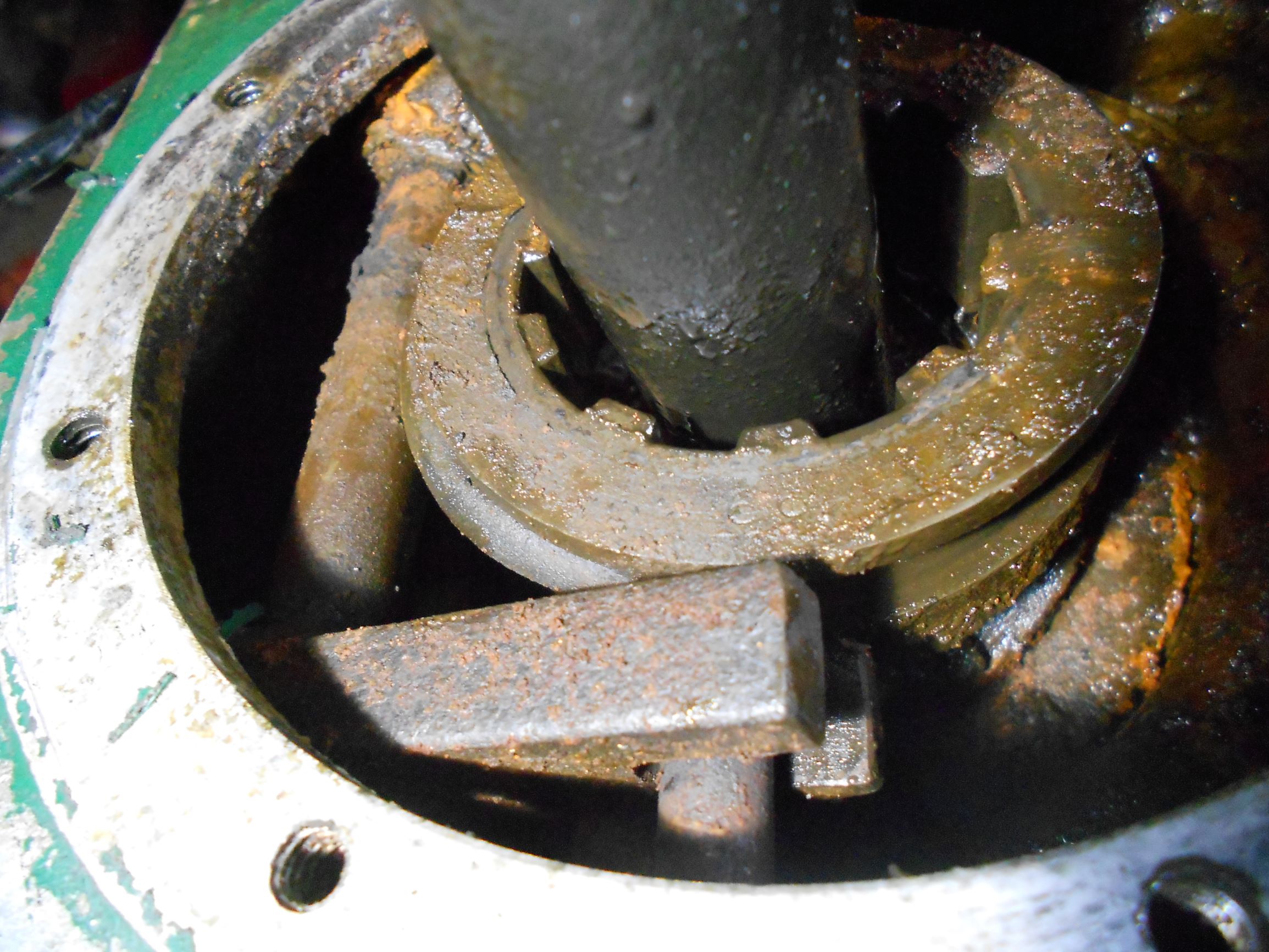

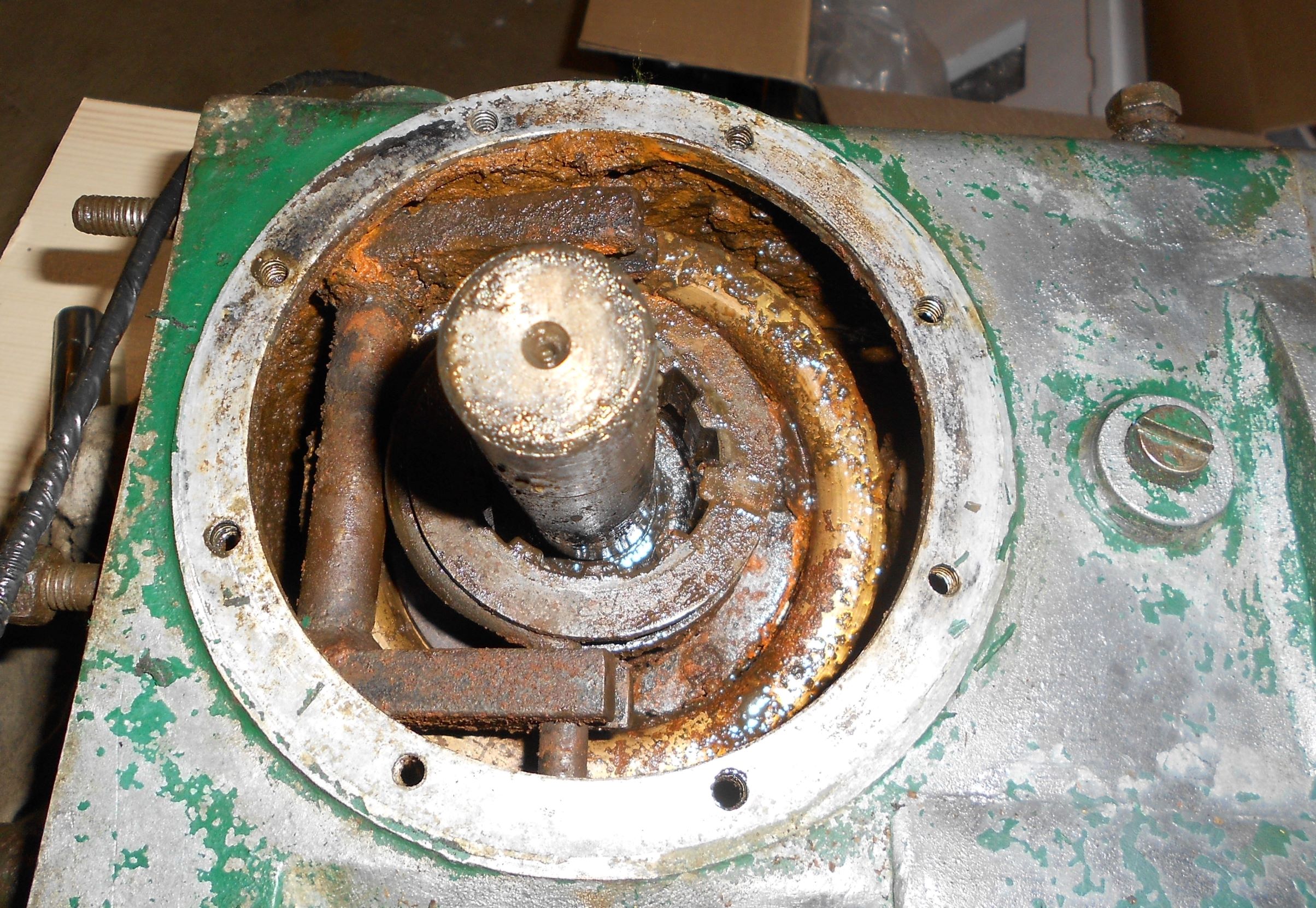

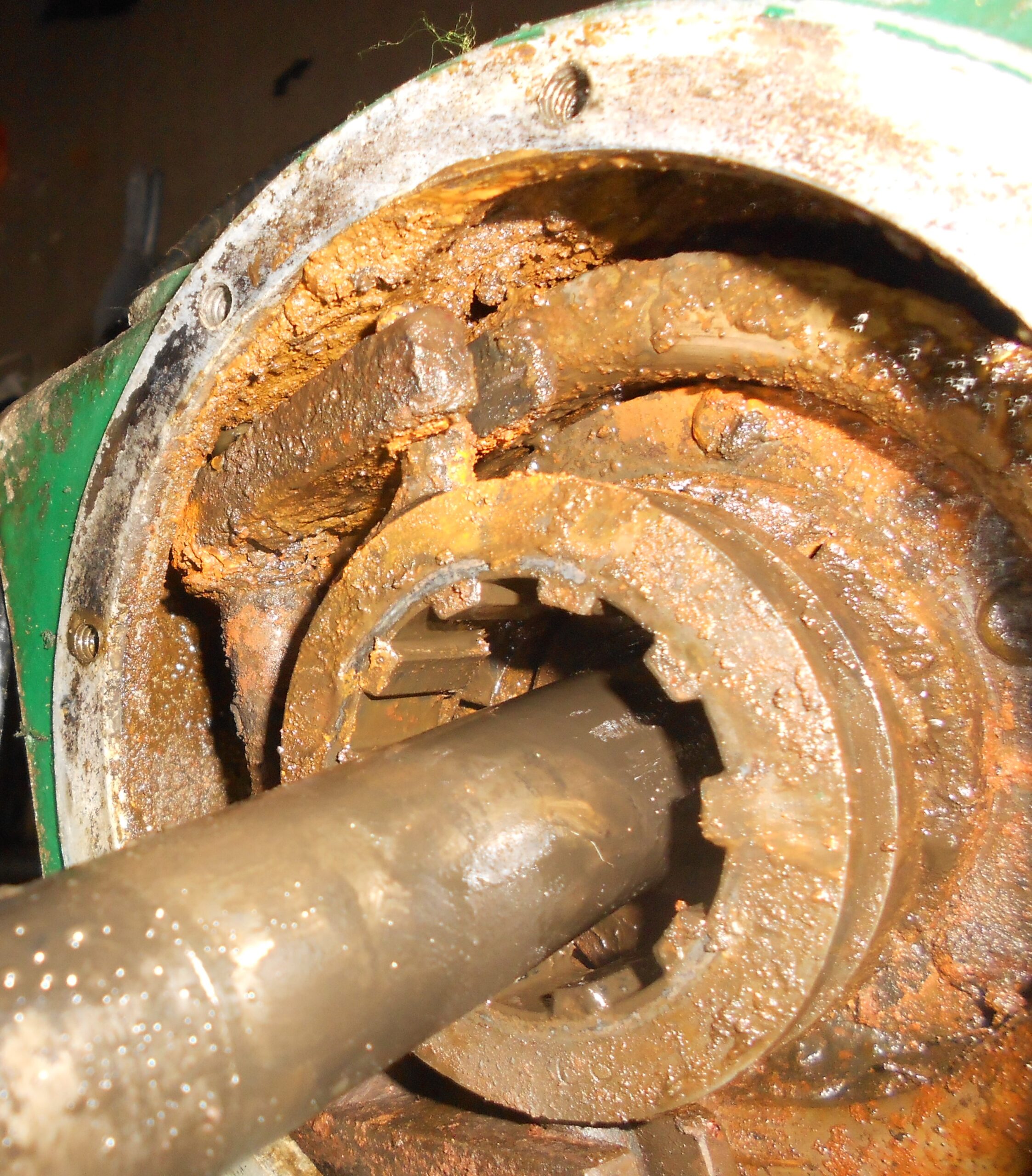

ssorthiekParticipantGEARBOX

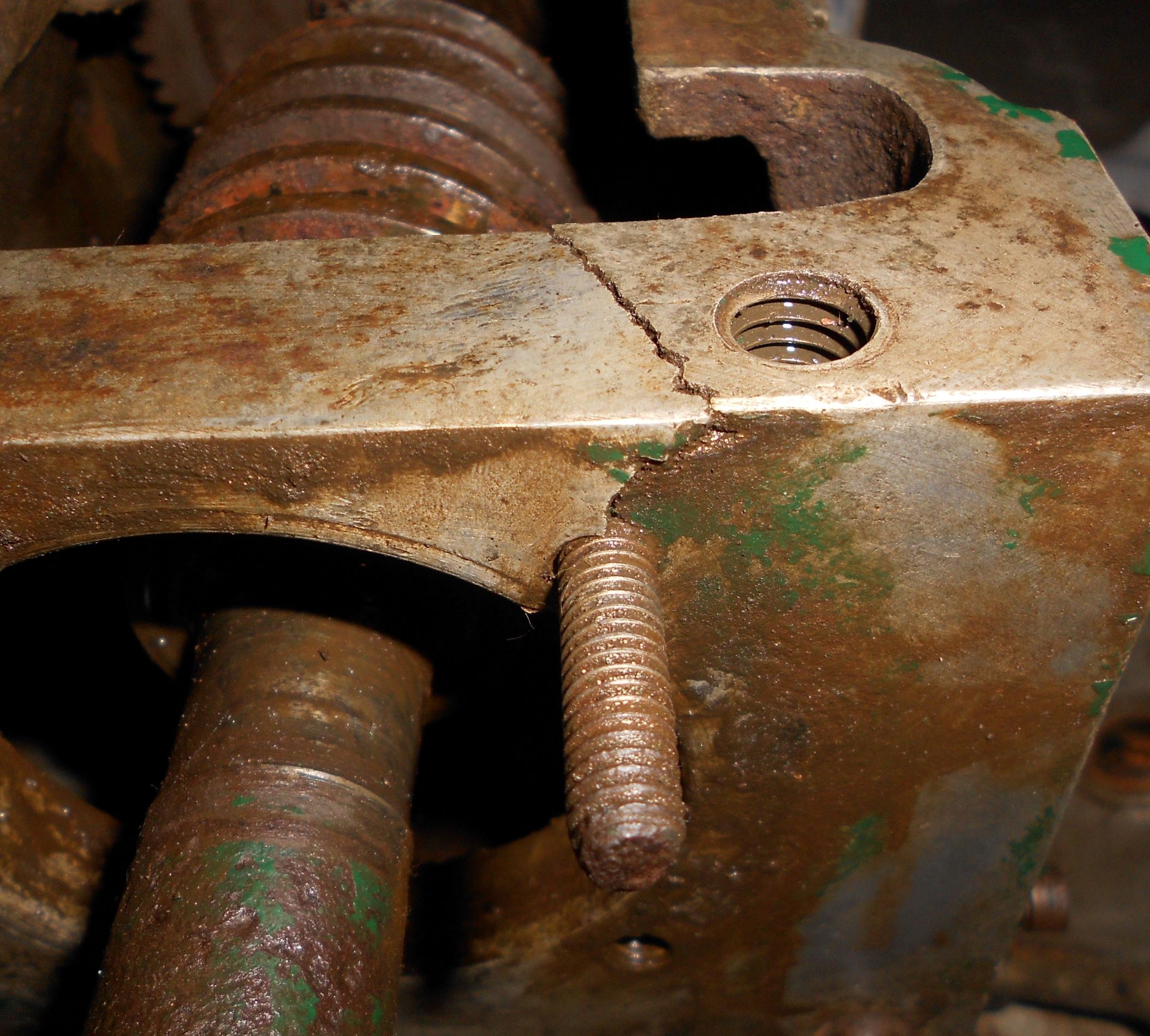

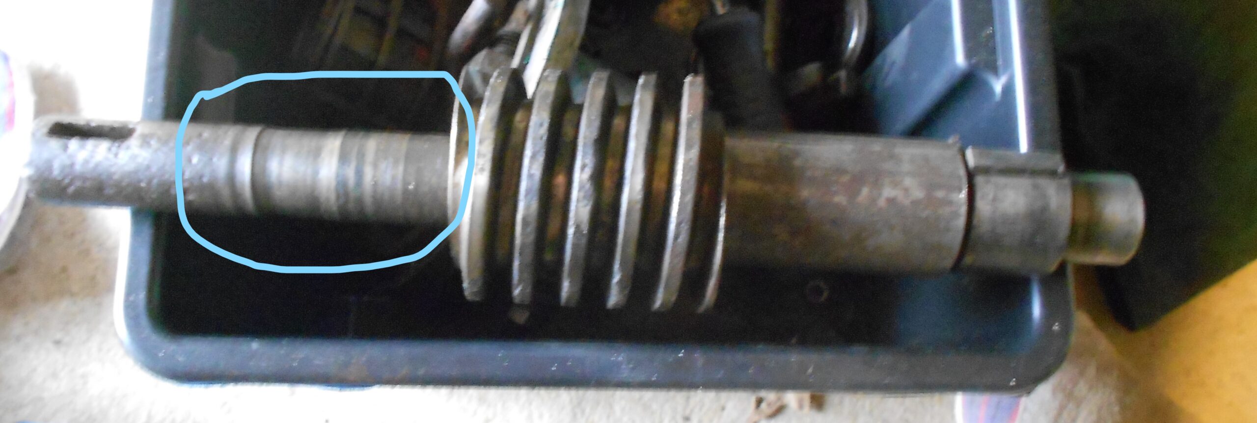

The gearbox is presenting some challenges. There is a large crack in the casing, but I believe I can get this welded. The shaft that the worm is on has worn to an unacceptable level. It would appear that the shaft was originally 25.4mm or good old 1” and has worn to 24.2mm or 0.950”. Can we stick to good old English measurements now the country has voted to come out of the EU? Incidentally, I have no leaning one way or another as to whether we should remain or leave the EU.
My idea at the moment is to turn the shaft down to 7/8” and then get someone to machine a collar 7/8” I/D and 1” O/D. There is a small issue with this approach since the shaft appears also to be a PTO and has a slot for a key but I suspect that I won’t be able to get any attachments for this machine that uses the PTO so this doesn’t matter too much if this is the case.
The worm is quite badly pitted through rust but hope that this won’t affect the operation.
The next issue is getting two bearings out of the casing which sound like a bag of nails. To do the restoration justice, I need to remove both and if that is successful and easy enough there is a third that I would like to remove and replace which should then hopefully last another 70 years with very light use.
I also have and engagement mechanism for the wheels which is very worn, maybe just rusted away. Any advice on whether this can be repaired or remanufactured would be again much appreciated.
The gearbox oil was in a shocking state. It had emulsified and all that was left was a very thick sludge. I think I have managed to clean this up now and it is starting to look promising.
I think I have got all the bits that are supposed to be moving, moving.
I’ve also included a photo before I really started to attack the gearbox

stuartParticipantYou could get get that worn shaft built up with weld and then turned back to std size in a lathe.Be cheaper than getting a complete new shaft made i think !
October 12, 2018 at 8:44 pm #29417
ssorthiekParticipantThanks Stuart. I still like the idea of turning the shaft down and fitting a collar over top of it. Welding may well distort the shaft.
A bit of superglue (Loctite 480) should hold the shaft in place if I have a small clearance fit of a couple of thou.
If this is the route I finally take, I shall let you know how I get on and any problems I’ve had.
October 13, 2018 at 9:21 am #29418
charlieKeymasterAn alternative to using loctite would be to have the collar a tight fit, then heat it before fitting and let it shrink onto shaft a bit like fitting metal tyres on wooden wagon wheels.
October 20, 2018 at 7:32 pm #29450
ssorthiekParticipantThanks Charlie. I’ve thought about shrinking the collar onto the shaft and that still is possible. Initially I thought that heating the shaft would distort it but having thought about it for a while I only need to heat up the collar.
So yes, good call.
