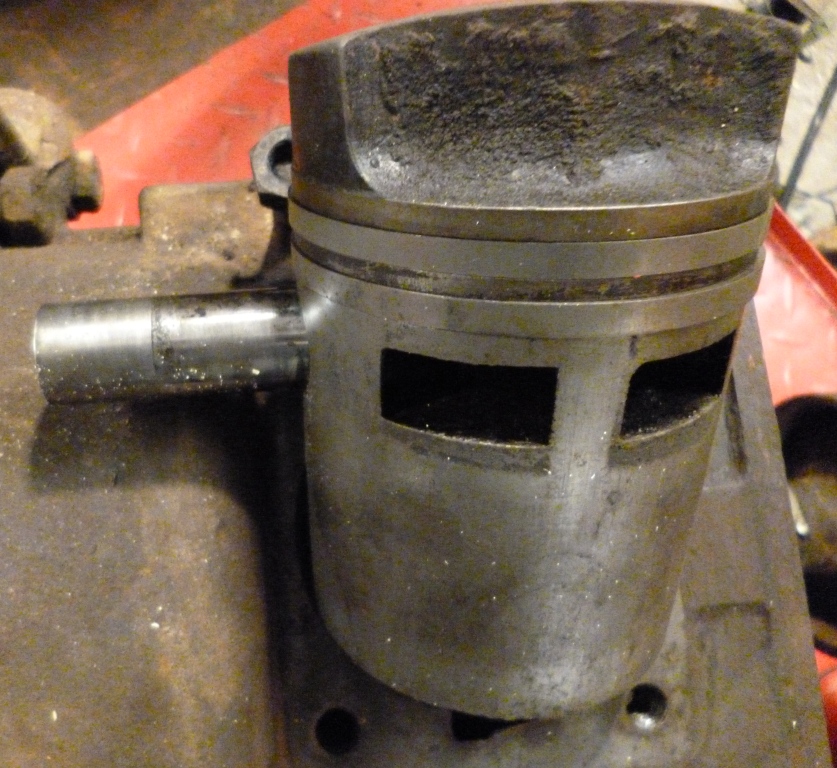

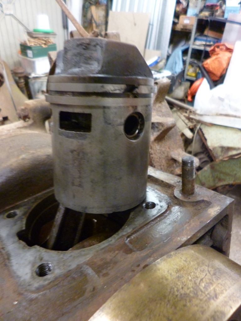

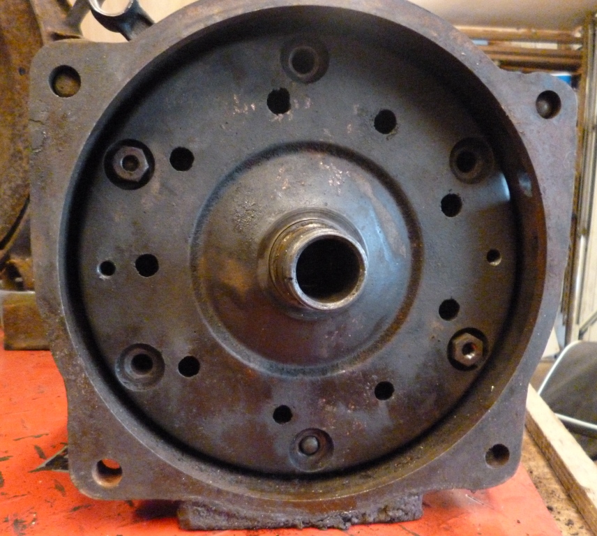

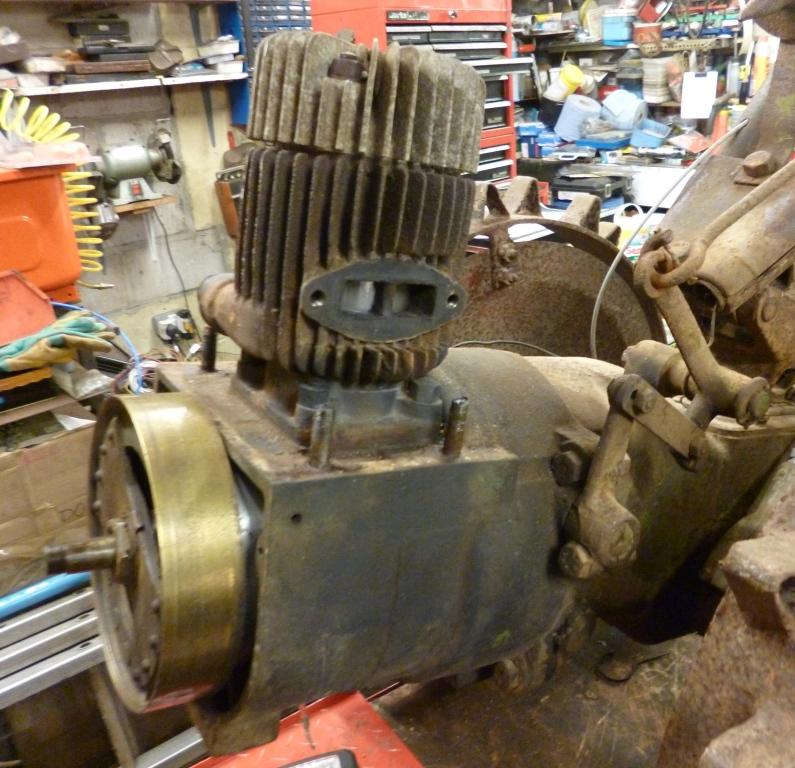

charlieKeymasterThe engine has an aluminium cylinder head and the previous owner had told me when he had previously removed cylinder he did not risk removing head due to head bolts corroded into cylinder head. I followed the same course of action and removed barrel and head together to reveal piston etc.
January 29, 2018 at 4:20 pm #27798

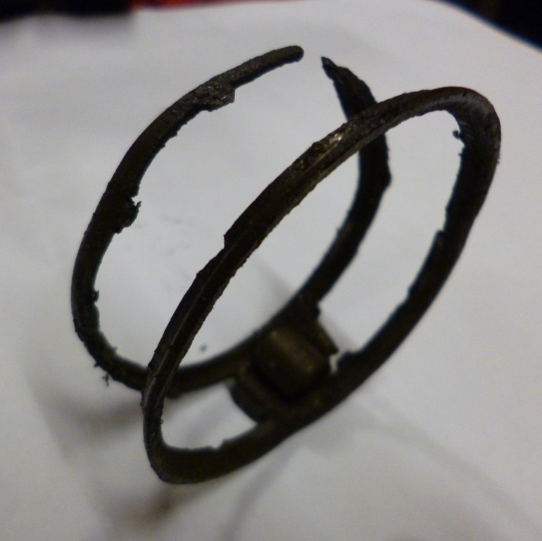

charlieKeymasterInspection of the piston revealed one piston ring was rotating in groove due to broken lock pin. This will need repairing before reassembly. Luckily piston ring had not suffered serious damage. The engine is a two stroke and ring could have caught in one of the ports. There was excessive movement of piston on connecting rod, so gudgeon pin was removed, this showed wear in pin and bush; this will need attention before reassembly.

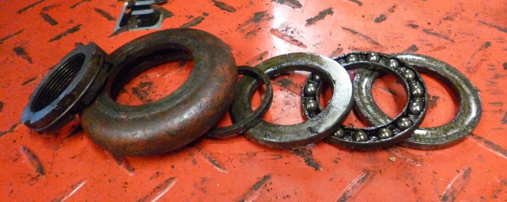

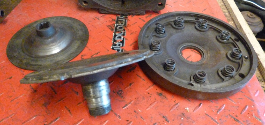

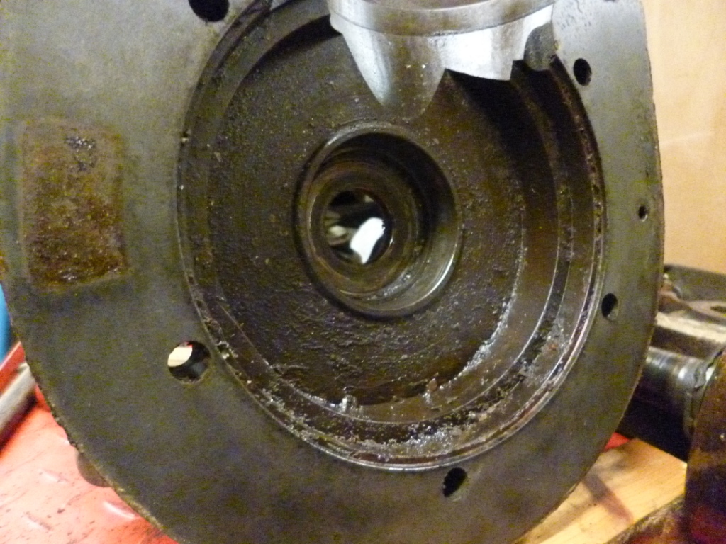

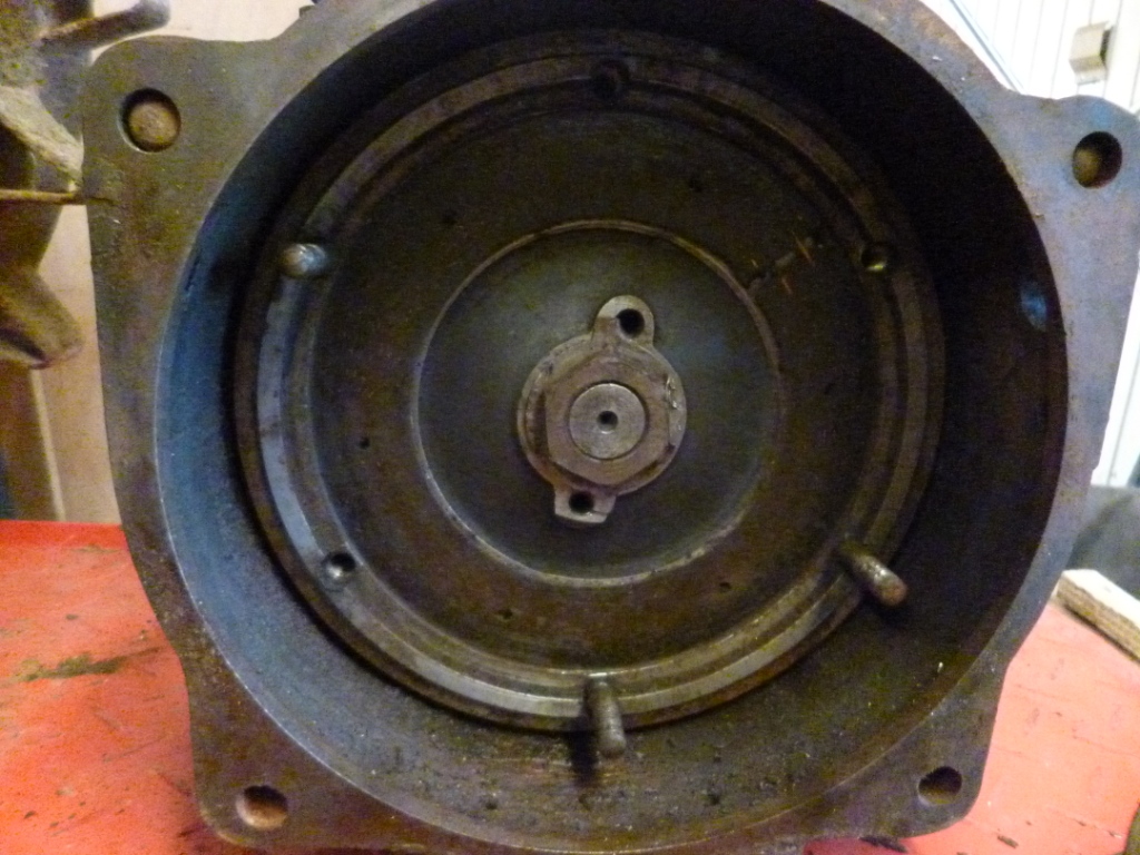

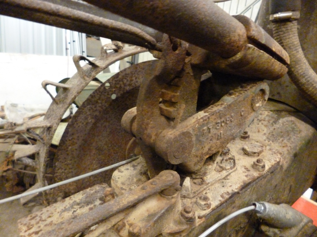

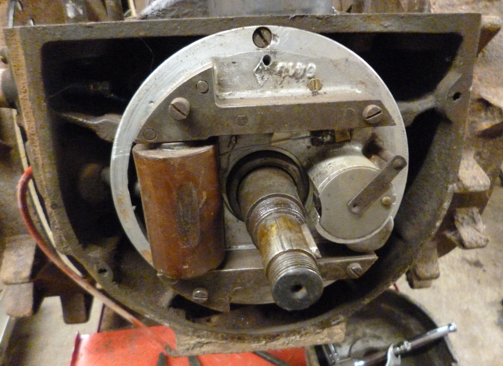

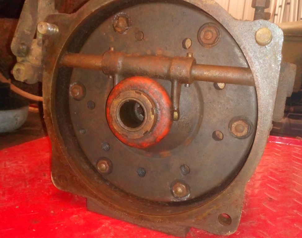

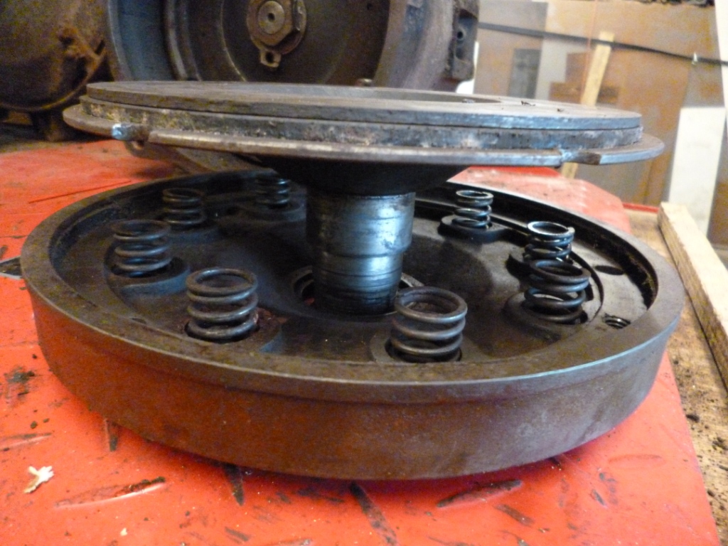

charlieKeymasterNow on to the task of removing the crankshaft. First the clutch withdrawl mechanism, clutch assembly and fywheel had to be removed. The taper pins holding clutch fork to shaft required a lot of heat to free them. Heat and pullers were also needed to remove clutch and flywheel, luckily tapped holes are provided for attaching a puller.

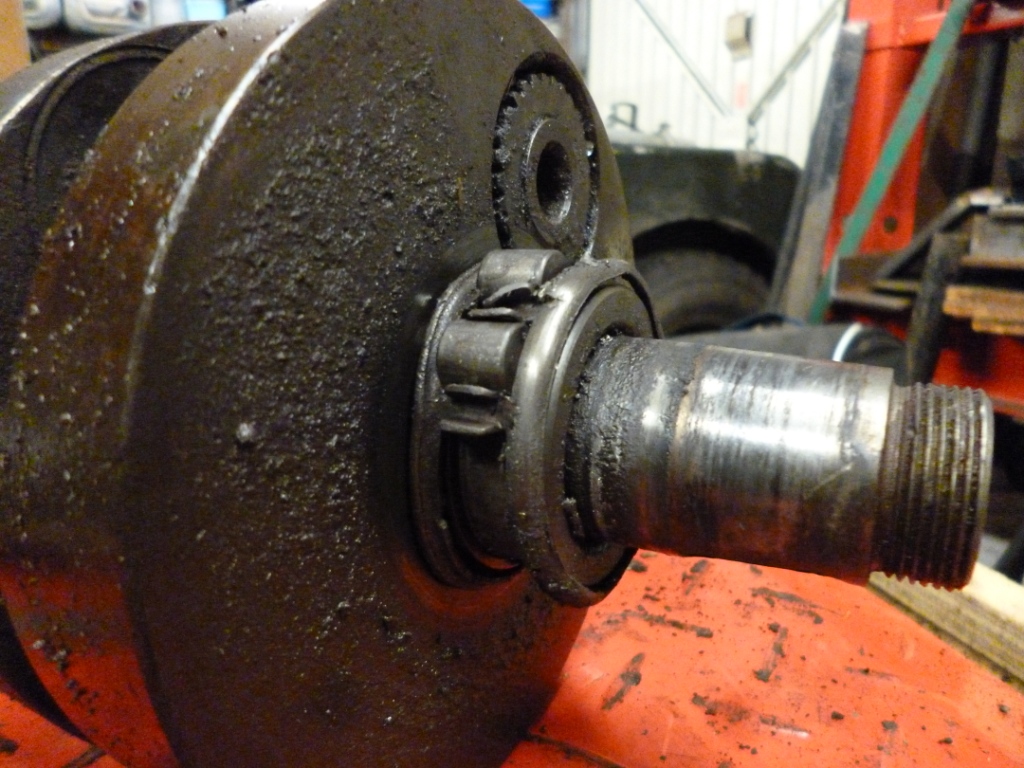

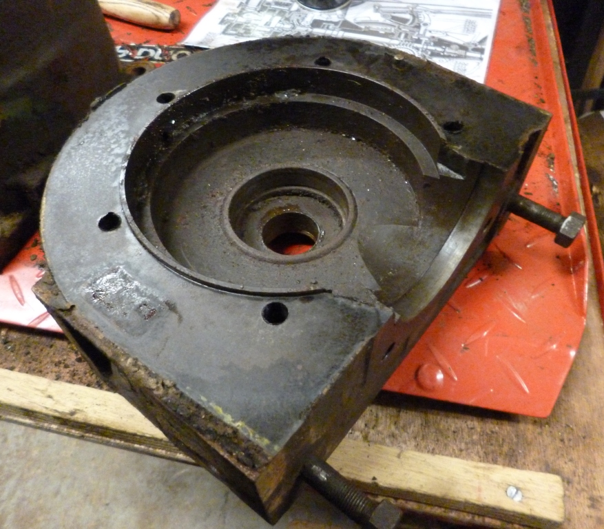

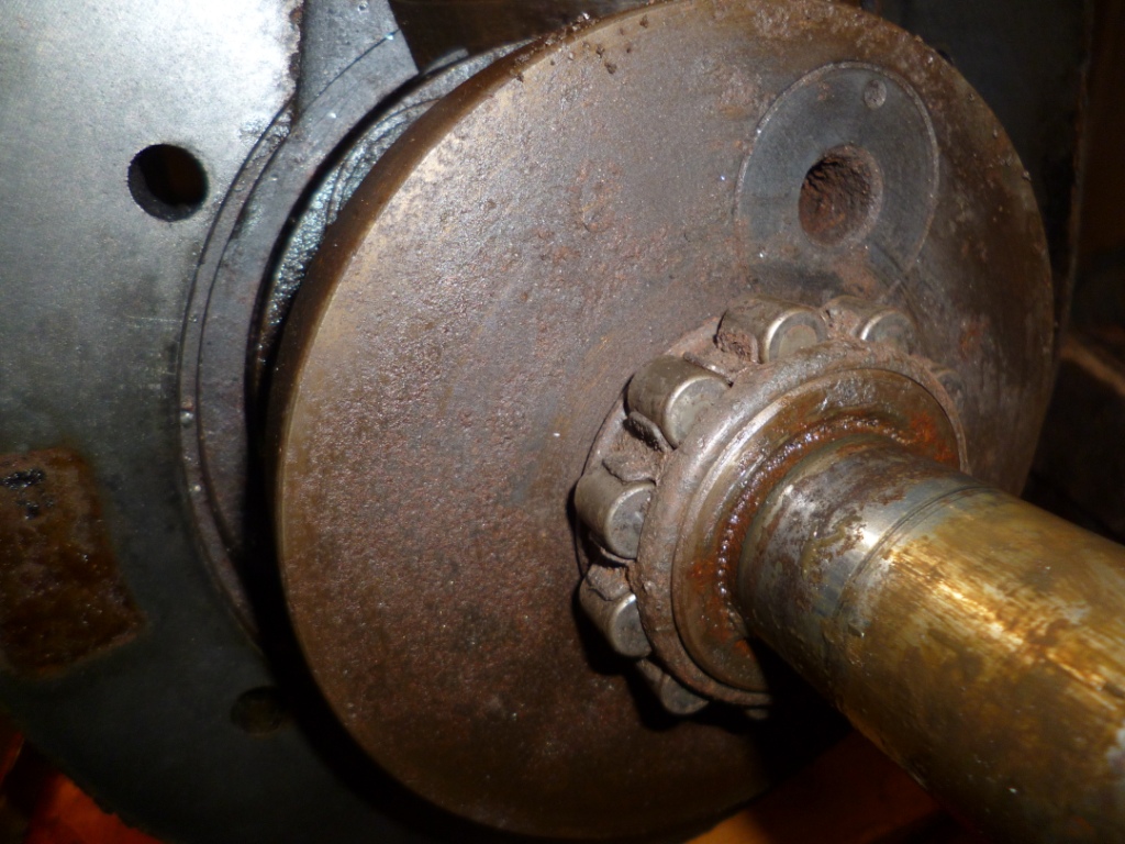

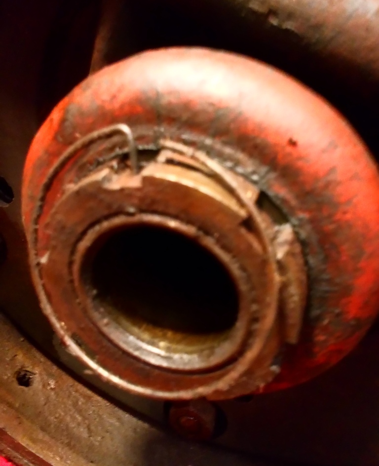

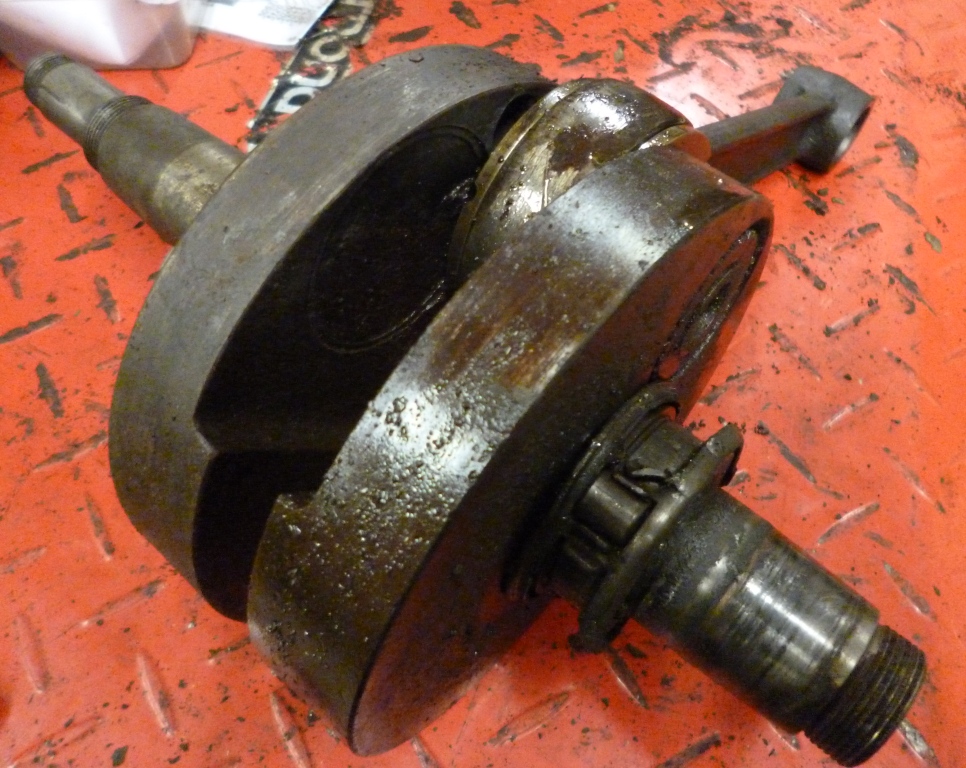

charlieKeymasterNow the problem could be seen.
Front bearing rusty and very dry, rear bearing cage had broken up allowing rollers to fall out when crank was removed. Both bearings will need replacing, so I will be taking the crank and bearings along with piston to Cox and Turner Engineering to see what can be done.January 29, 2018 at 7:41 pm #27818
