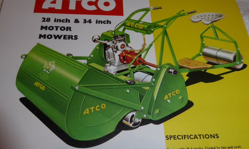

    #38475
    hdtrust
    Nothing like a picture to help, try these two for size. They are from The Hall & Duck Trusts library – enjoy

    The OP describes the machine as an L28. I assume that the 28 refers to the width of cut but all my parts books, albeit for Mk25 engined machines, use the L for 34” machines and a J for 28” machines. The Brooks (with no E) saddle was not the sole preserve of motor cycles; the early belt driven Webb 24s with the Villiers 150cc Lightweight engine were fitted with them as original equipment – my father-in-law had one – and I believe that the Anzani Powermow also used a Brooks.
