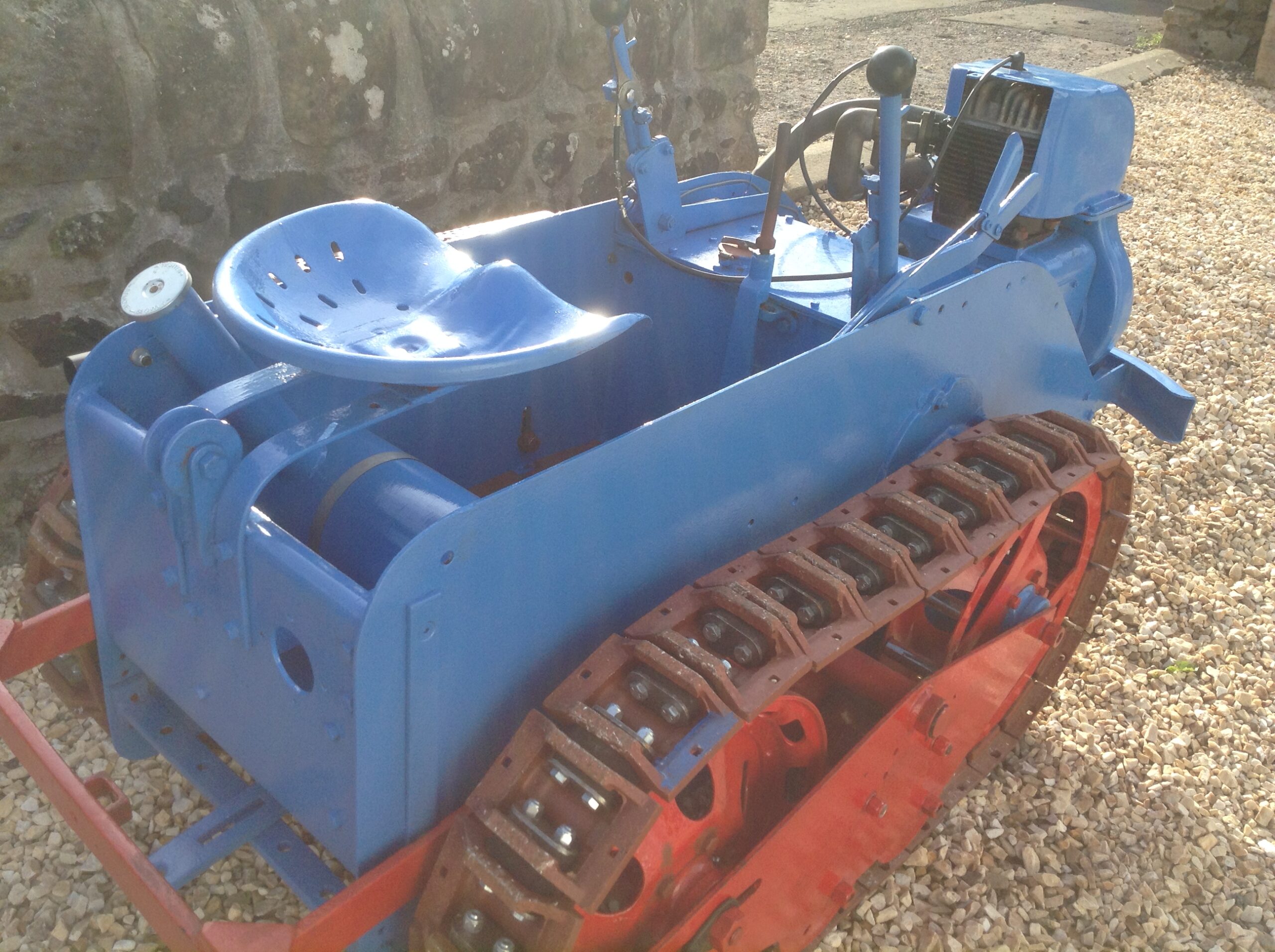

My unit hasn’t got the cover over the clutch fitted. If I am making a tool box I will have to make the cover as well. Can any kind person send me a picture and sizes?
I have access to sheet metal tools.

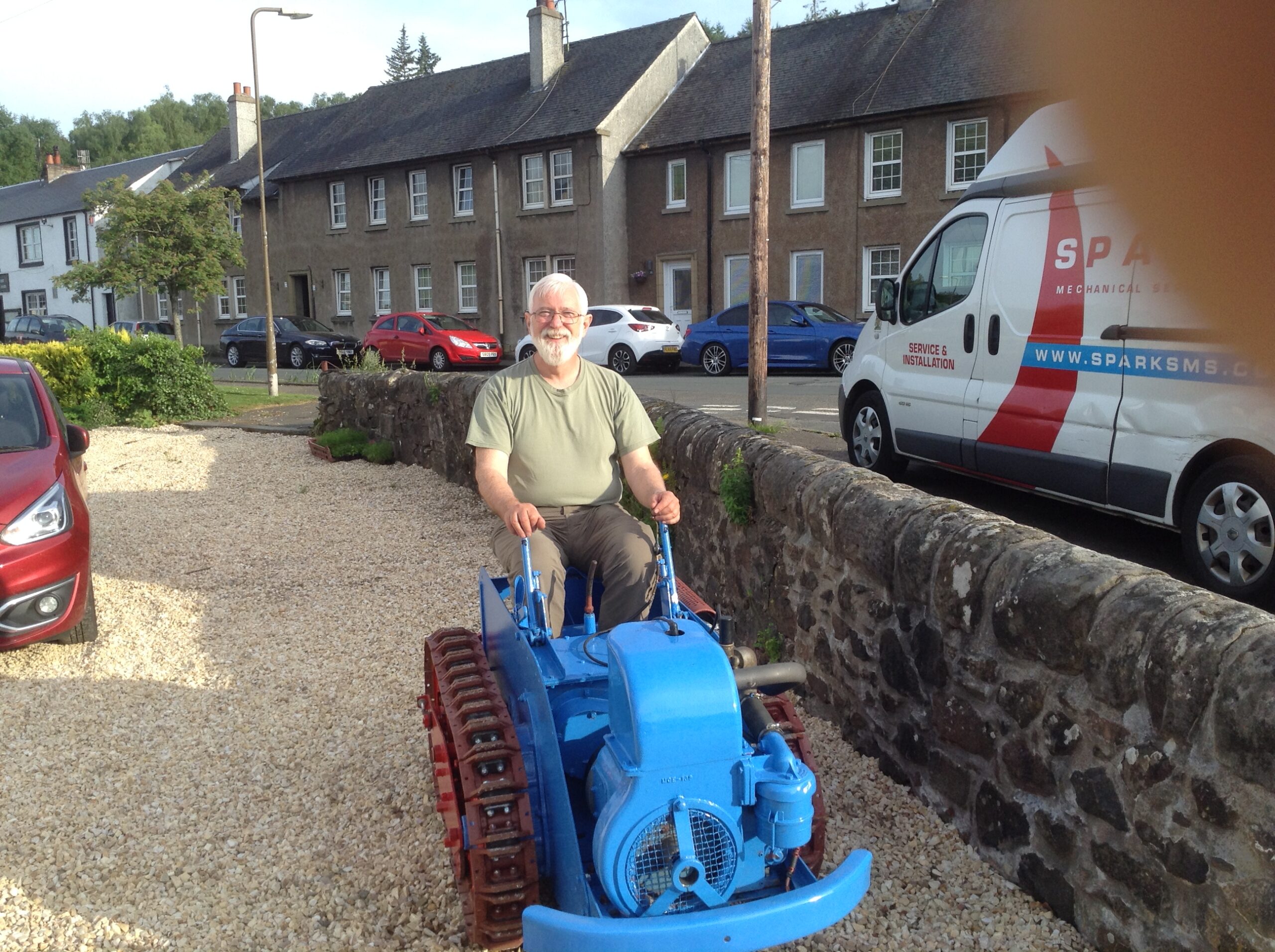

By the way. She started again today, first try!! So I think I have solved my starting problems.August 1, 2018 at 7:00 pm #28995silverfoxfintry
ParticipantAugust 1, 2018 at 11:36 pm #28999
crawlerParticipantHello
I haven’t been active on here for a while and somehow missed your post when just browsing the forum. If you can wait until the weekend I can take some photos of my MG5 showing the cover and tool box.
Well done on getting your MG up and running.
